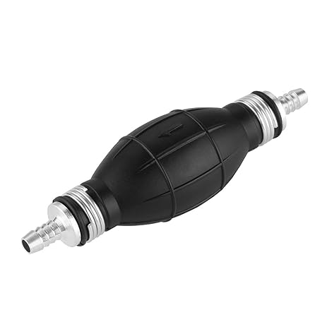

I'ts possible the pump has failed internally, you could always get an inline hand primer like Bobcat use and see if that fixes your issue, they are cheap from boating stores.
Image result for boat hand primer

Still, an inline pump is a good idea for testing, when the machine bogs down, get out and give it a good squeeze and see if the engnine picks up, if it does, your lift pump is probably bad.
