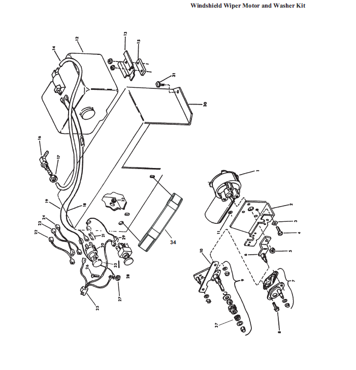

Hello, I am new to this forum and I'm looking for instructions for installing wind shield wiper kit on my Mustang 2054, any help would be greatly appreciated.
What do u have at this time i assume u have a door with no wiper?

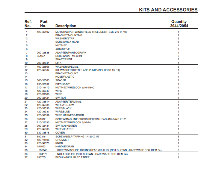

Yes, I have a door and the wiper motor, just purchased the wiper motor, switch, arm, blade, and a cable, no instructions. My dealer mentioned that Mustang use to have a all the instructions to install kits and accessories on their website, looking for #246-26656 detail assembly drawings.
not sure if this will help gives general idea, im surprised your dealer couldnt get it for u
