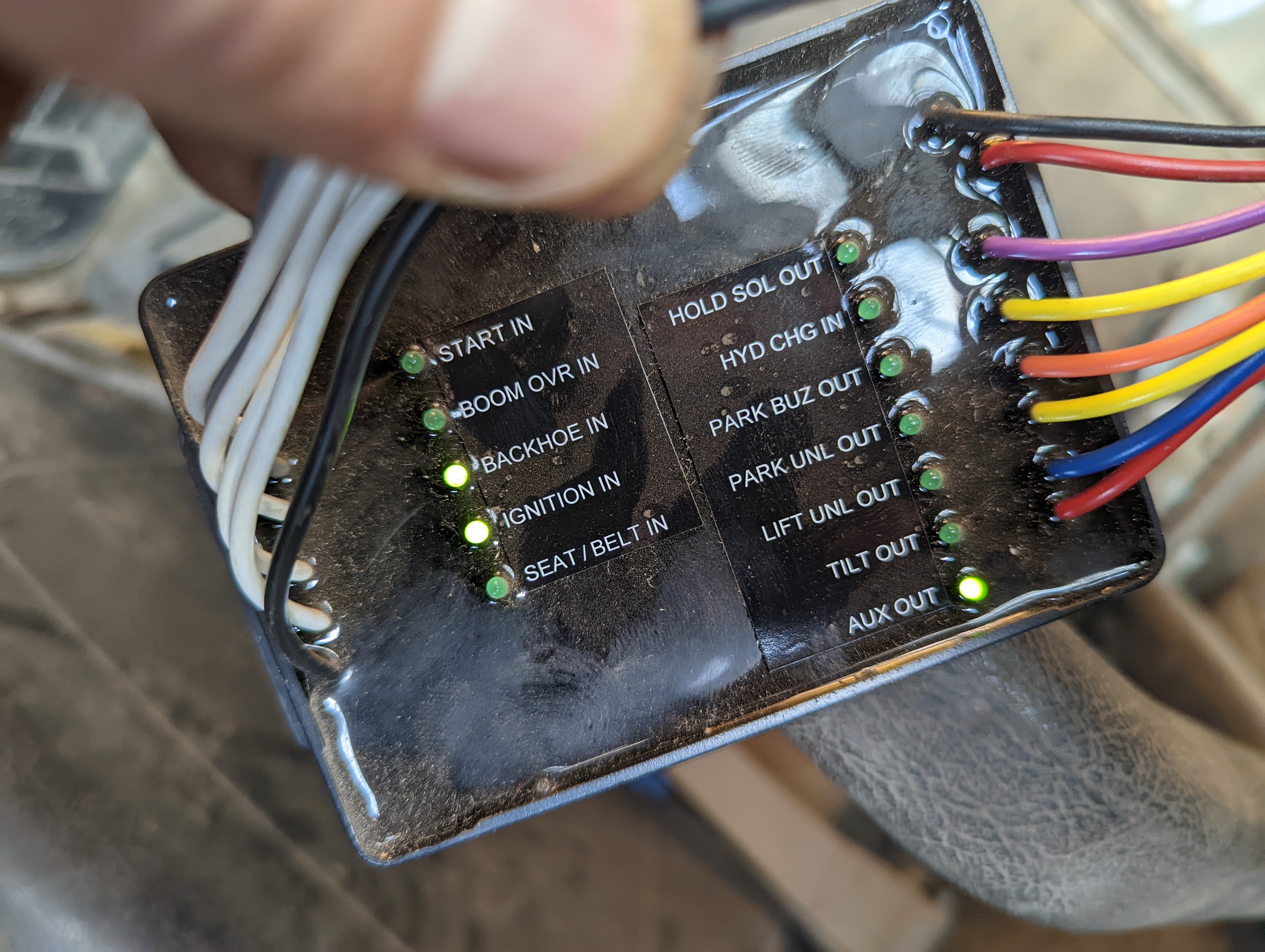

I have a Mustang 2054 and I have been trying to figure out the issue with it for a long time now with no luck.
It will start and then die after about a second. Front what I understand the module controls all this.
I bought a new module, but it didn't seem to fix the problem.
Here are the lights that are lit up when I turn the ignition switch on.
I tried jumping the wires for the seat belt, safety bar, and seat but it doesn't change the lights at all and they don't turn on or off.
Anybody know how to bypass this thing so I can just turn it on and off like normal without all the safety bs?
Anybody know where I can find the electric schematics??
Thanks!

Are Ur Fuses Clean, Does it Stay Running with Pedal Lock switch In Red, Also Does The Hyd Charge In
Light Come on At All For The Short Time it runs
Having same issues, runs both lights red. Stays running left on green, dies right after I turn right on green ? Starts back up & idles ?
You either have a seat belt or seat switch fault, or a wiring fault in that circuit make sure both harnesses are securely clipped in place,. its also very possible the switch in the dash is bad. U can also check the control module n see what inputs and outputs u are getting
Had this with a 2050. It would run when cranking but as soon as the key was in the run position it would die. THe hold in winding on the fuel shutoff solenoid was shot
