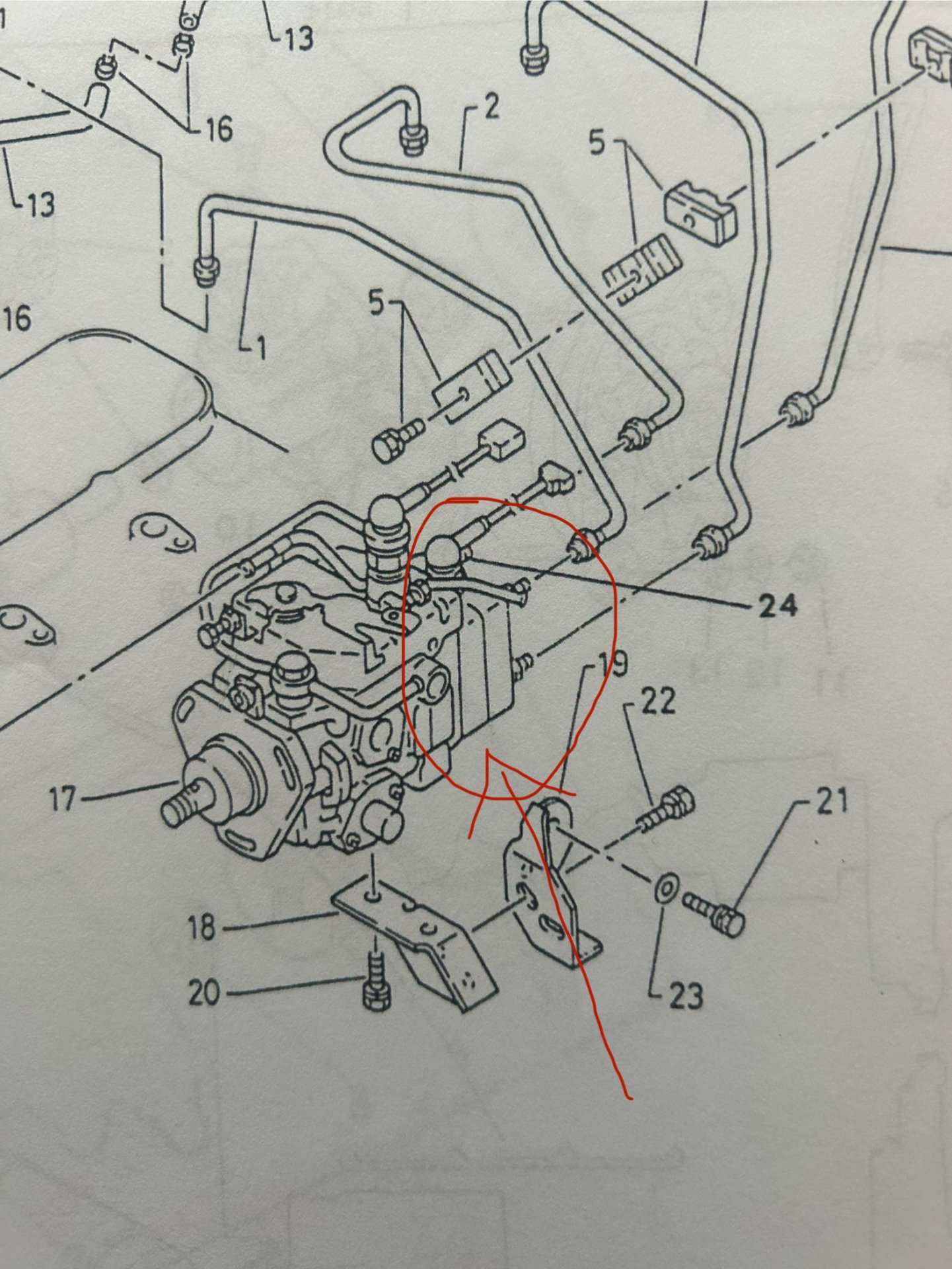

I have a 1995 Mustang 960 with the isuzu 4jb1 . currently my injector pump is leaking , was wondering if i can reseal it on the machine or if it needs a total rebuild. is it worth purchasing a brand new one ? know any decent places to send it ? anyone have a write up on removal and installation ?
ive looked at some removal and installation post and they are very vague . so as much details as possible would be much appreciated .
Where is it leaking from, does it start & run good
It seems to be leaking towards the rear of the pump . in between the block where the lines exit . Machine runs fantastic ! always starts right up and runs smooth .
