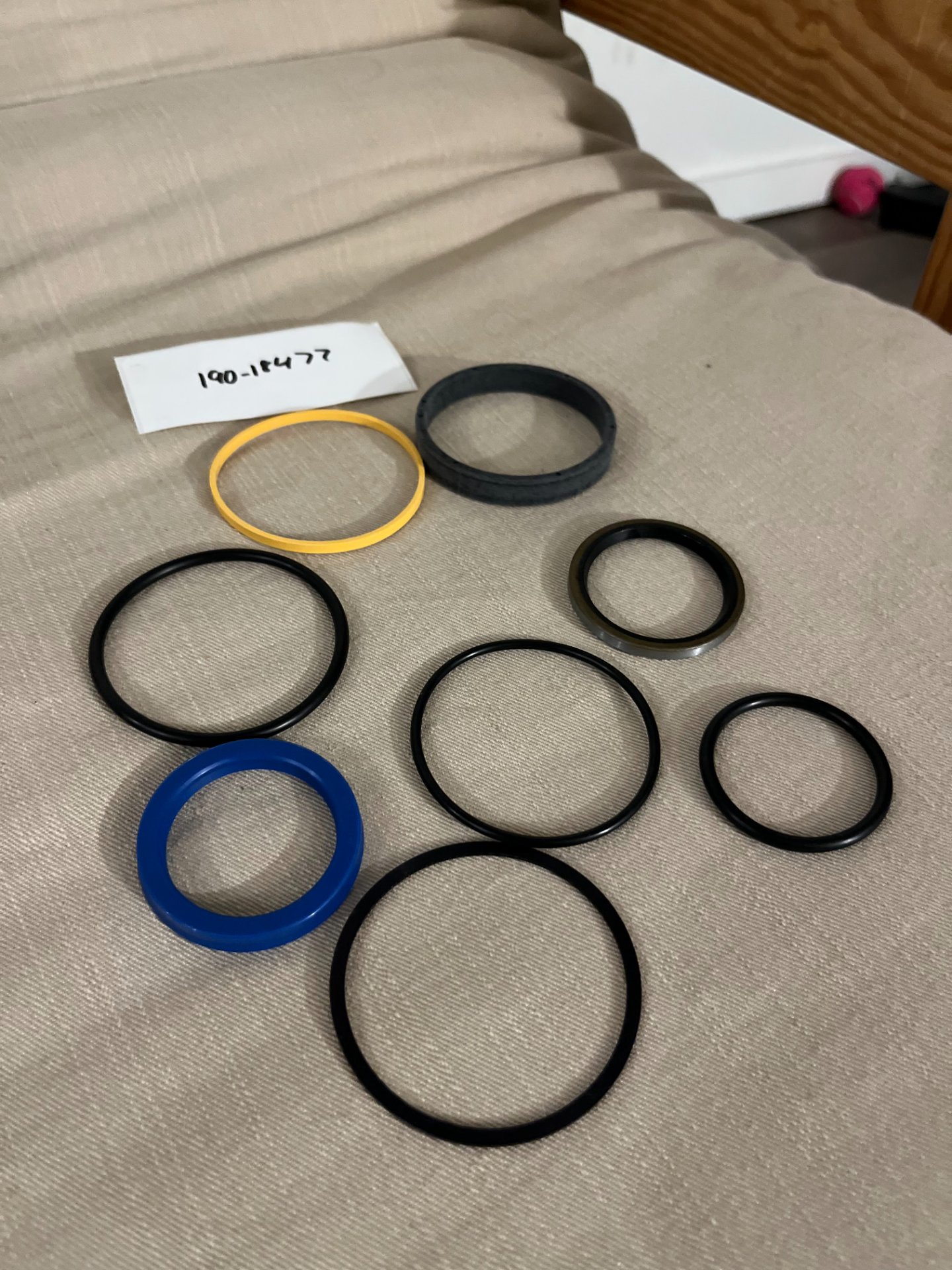

My seal kits from Baum Hydraulics came in. I don't have them in hand yet because they don't deliver to Canada but my son in Seattle has them and will bring them next month. The kit looks complete. There are 8 pieces and I think the wear ring is part of it and there is one ring that is split open.

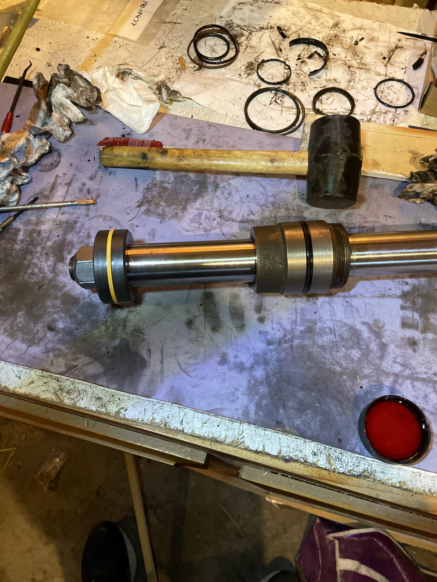

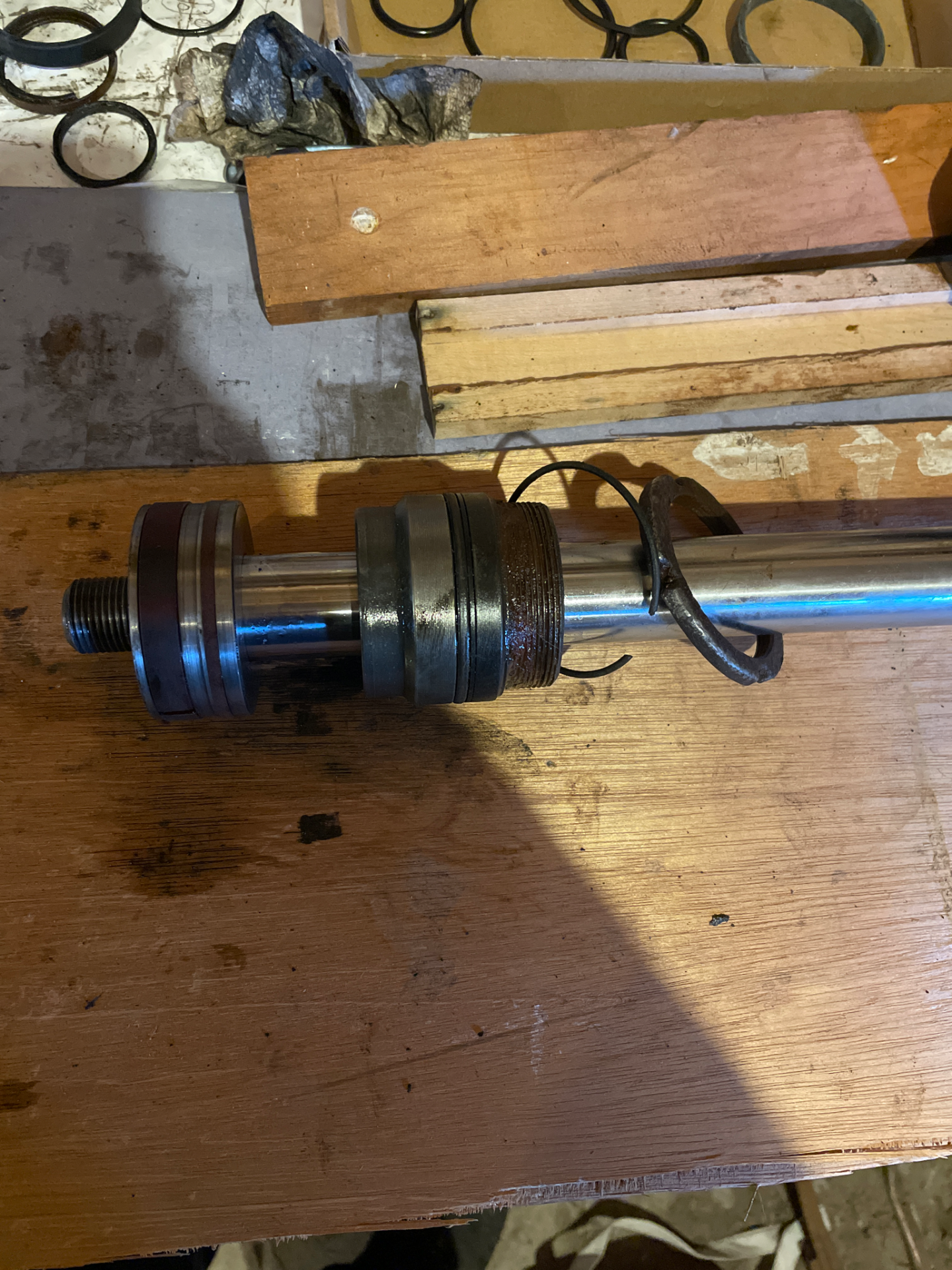

Finally installed my seal kits from Baum Hydraulics. Both the lift cylinder and tilt cylinder kits came with a wear ring but only the tilt cylinder had one. I watched a few videos and removal and installation was fairly event free. Had to buy a tool to remove the bearing nut. The seal wiper is has an extremely tight fit but I was able to use my woodworking vise to press them in. So far no leaks!
