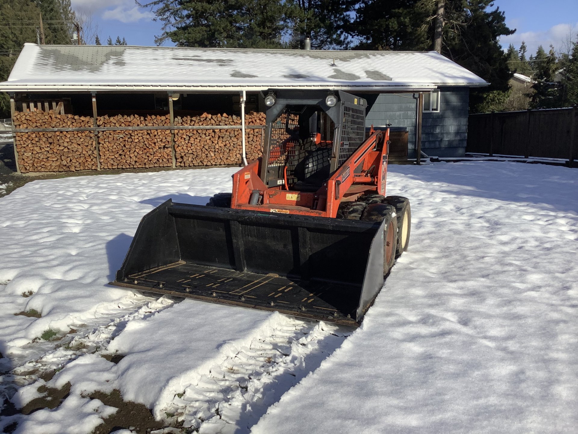

Mike C - 1978 Thomas 1200G Wisconsin VH4D
Mike C
Feb 5, 2023
20
New to forum from British Columbia , Canada .
Looking for and found a BH attachment BH 108 that looks pretty good in pictures but he want $3000 and my machine is more of a hobby than a working tool so hard for me to justify that price . Comments ?

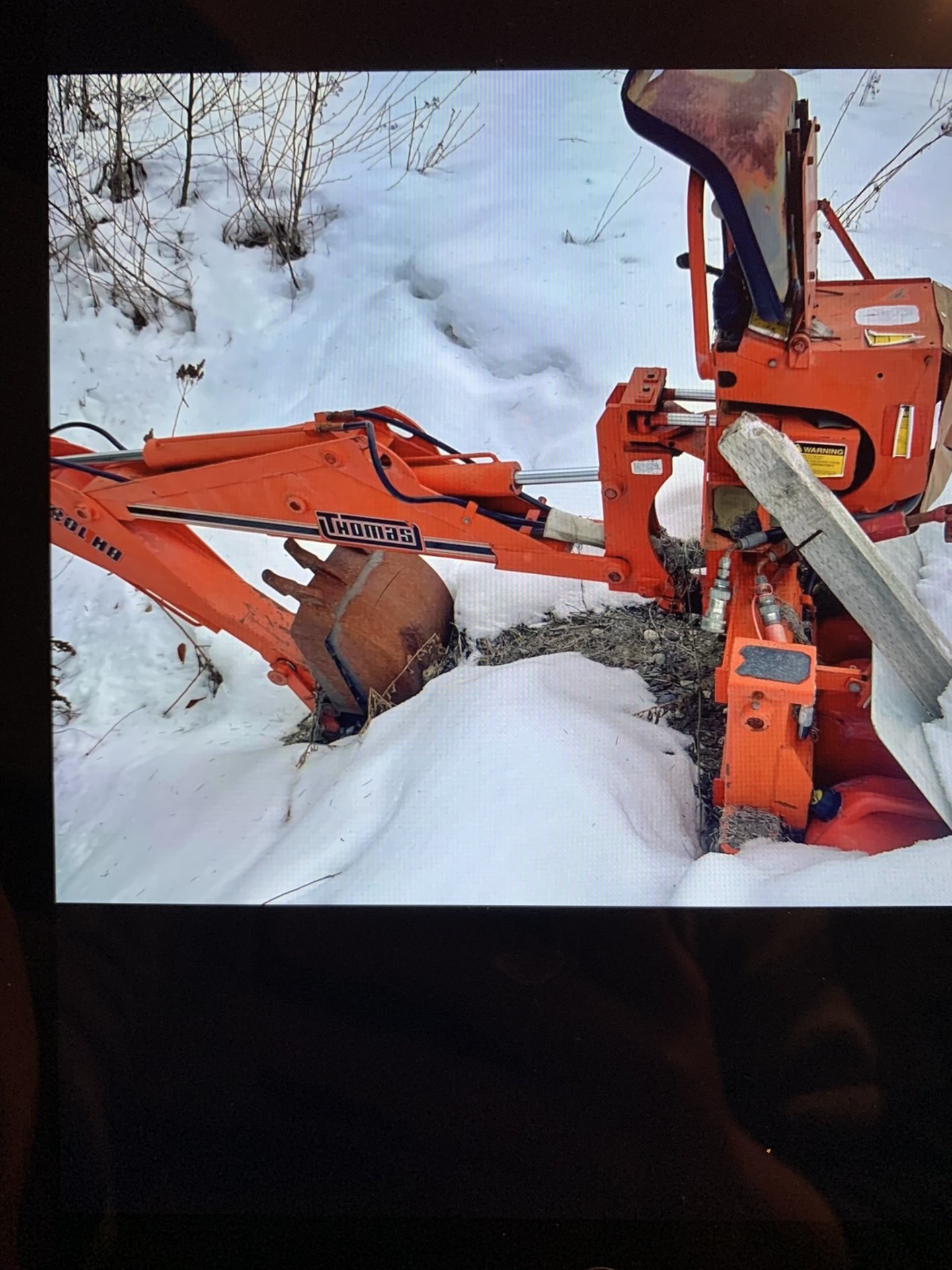

Well I bit the dust and bought the Thomas BH 108 backhoe attachment for my Thomas 1200G skidsteer .
Will receive it in about a month and am anxious to try it out . My only concern about it is the weight as I couldn’t find a spec sheet that told me the weight . Based on what I did find it could be around 600 lbs but not sure and if so that would be fine .
If anyone has any specs on weight , I’d appreciate to hear what you have .
Cheers and wish me luck !

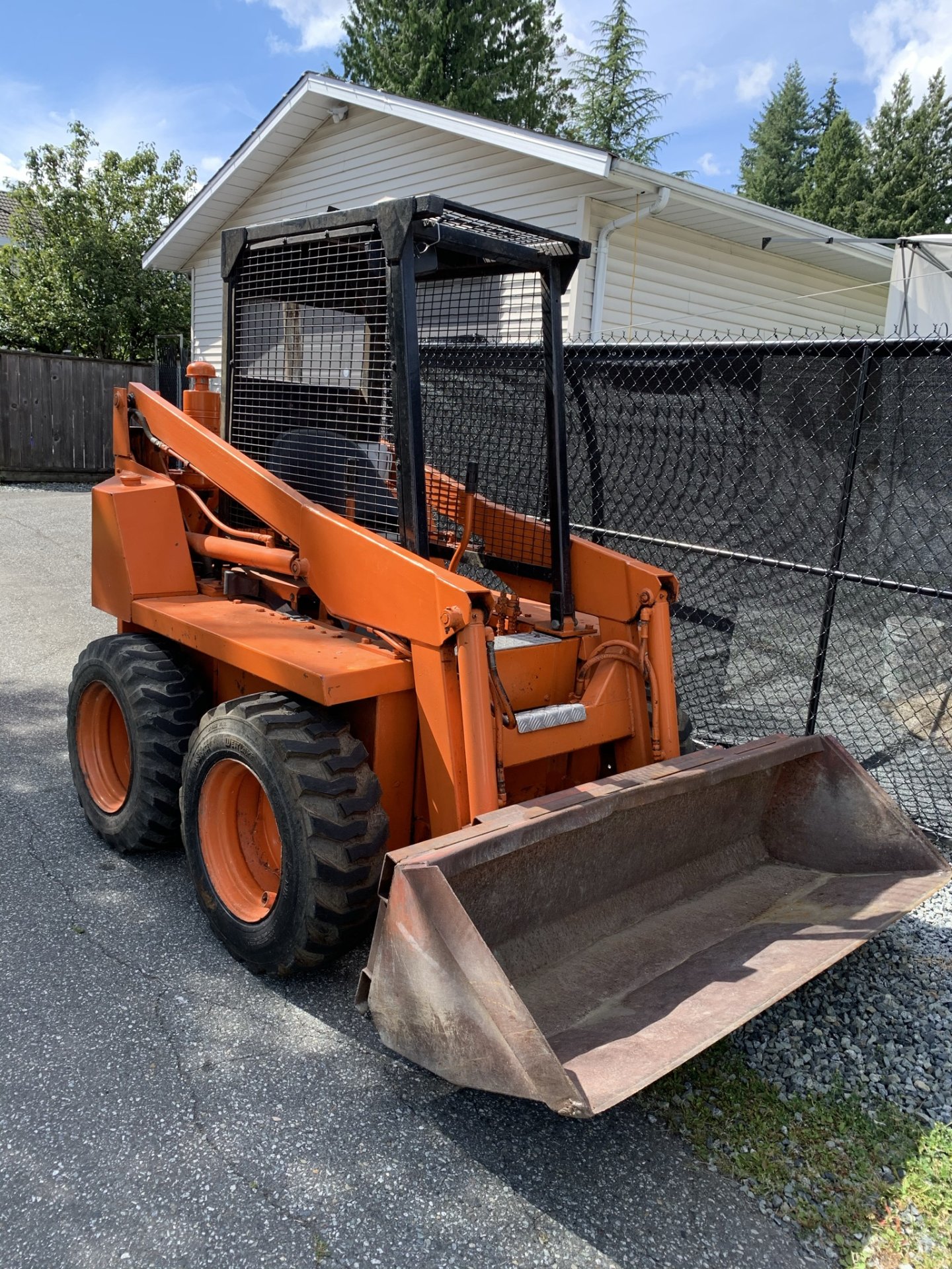

Haha, I'm a Bobcat guy, yes...
I mean, I don't know the mechanical condition, but for being middle age, the paint seems really fresh.

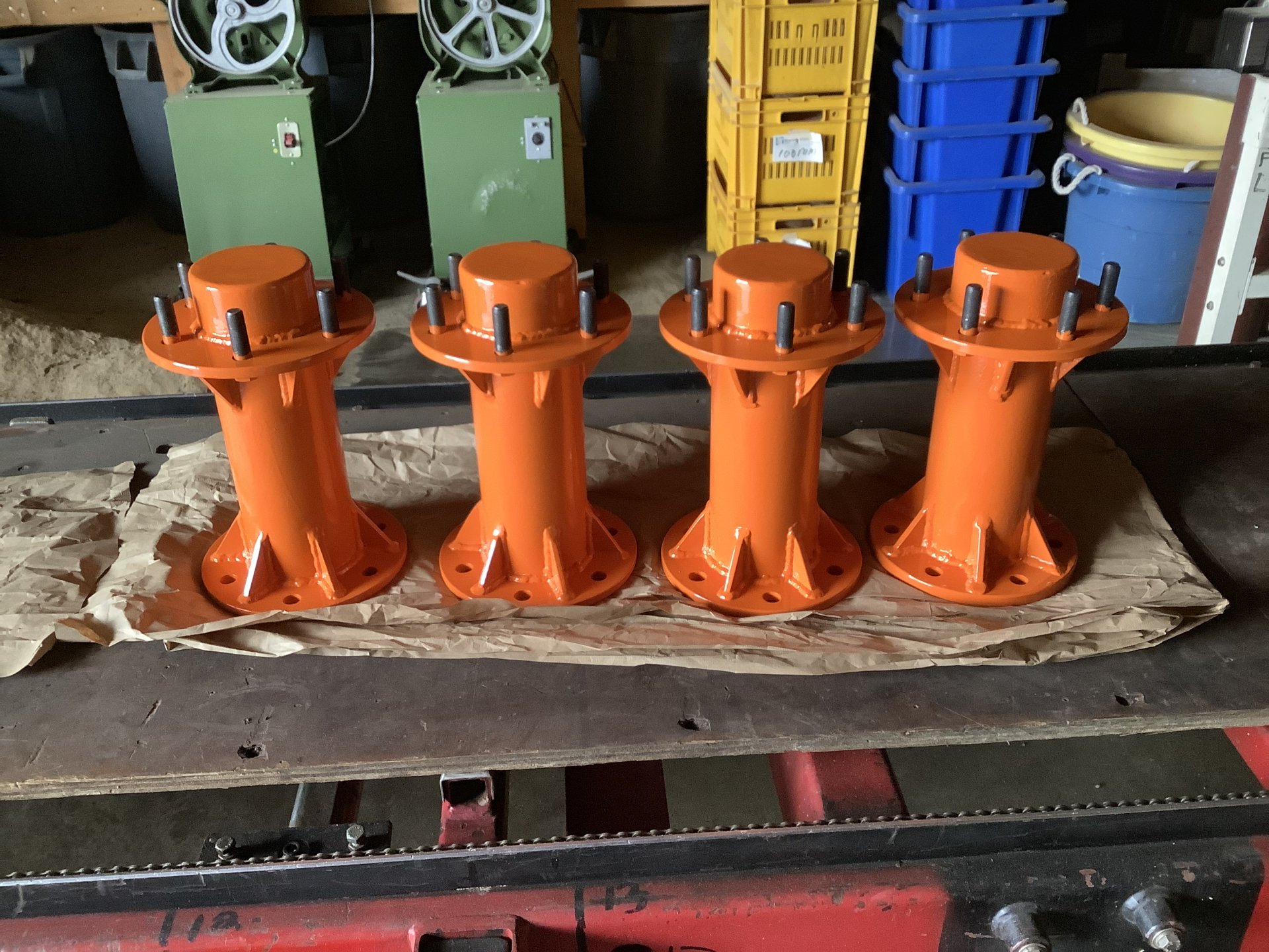

Here are pictures of a few added things I have done over the last few years. The first picture is the axle extensions I built three years ago for added traction for moving snow at my property in the mountains. I do have snow tires for the inside of the duals and the standard chevron tires on the outside. Btw, the snow bucket on the front is 84” wide.

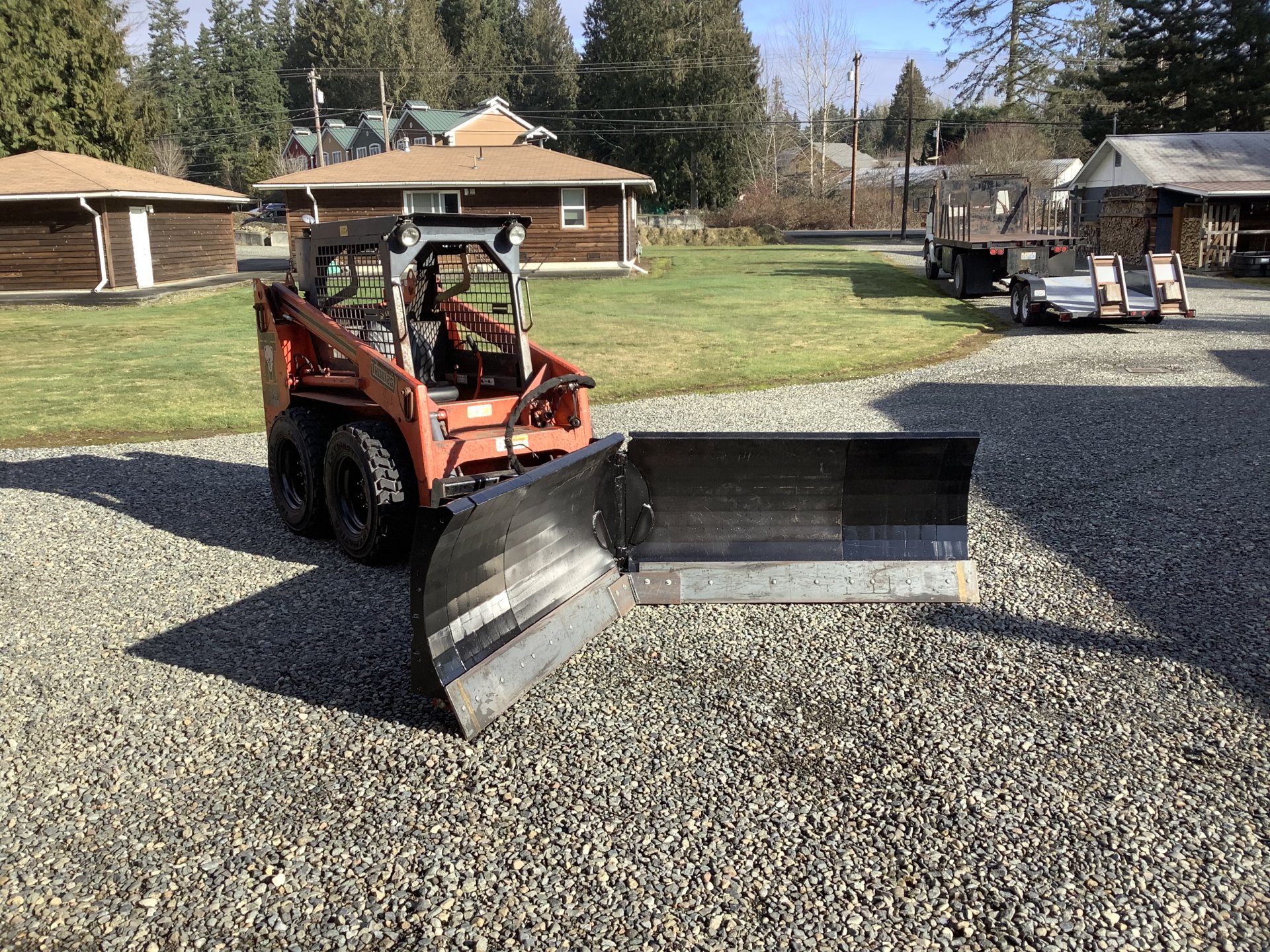

The second one is the “V” plow blade I bought a year ago that was 98” wide and then added 18” to each side, but was not sure if my machine was heavy and/or strong enough to push snow. The wet snow we got in December this thing would push a scary amount of that wet stuff anywhere I wanted it to go.

Wow first dually Thomas I’ve seen and that’s a wild plow as well . You must have a lot of snow to clear . Which engine do you have ?
I haven’t even used mine for snow as my ATV with plow takes care of all we have .

Thanks for the pic . Looks pretty much like the one I just bought but I only have a picture of it . Do you know what the weight is ? Which machine are you running it with ? Here’s mine

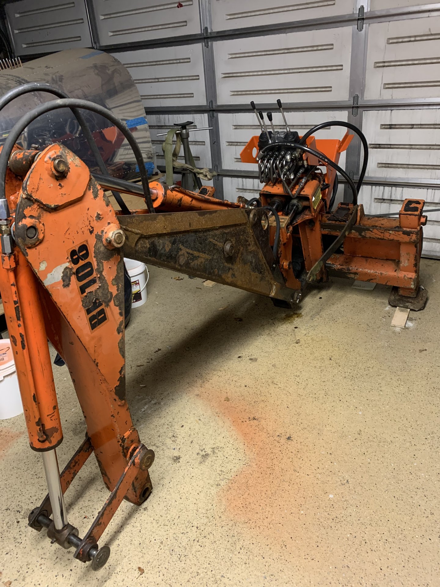

If I remember correctly, the weight is 667 kilos. I don't know if that includes the bucket.
I'm running it on a Thomas T133.

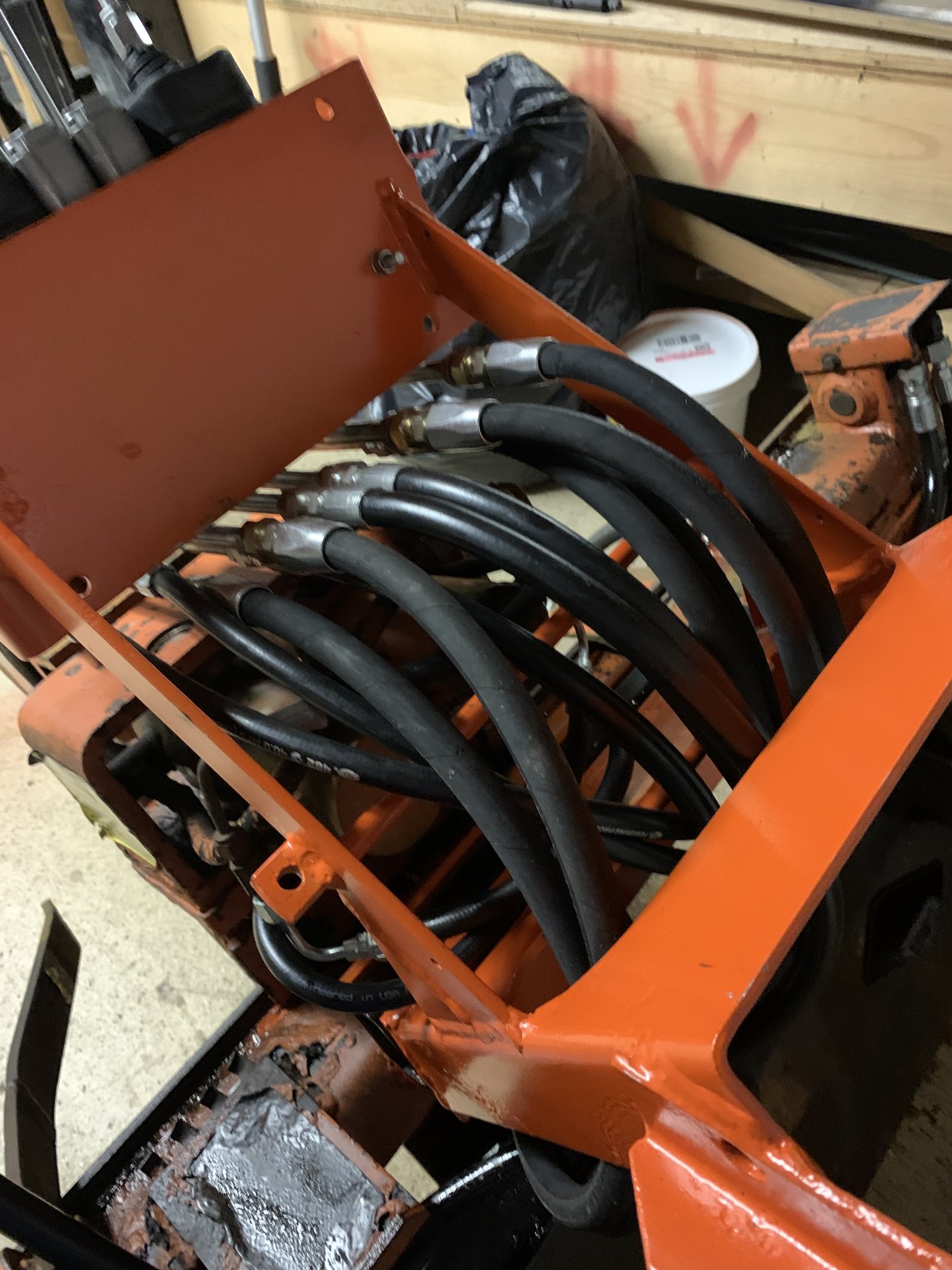

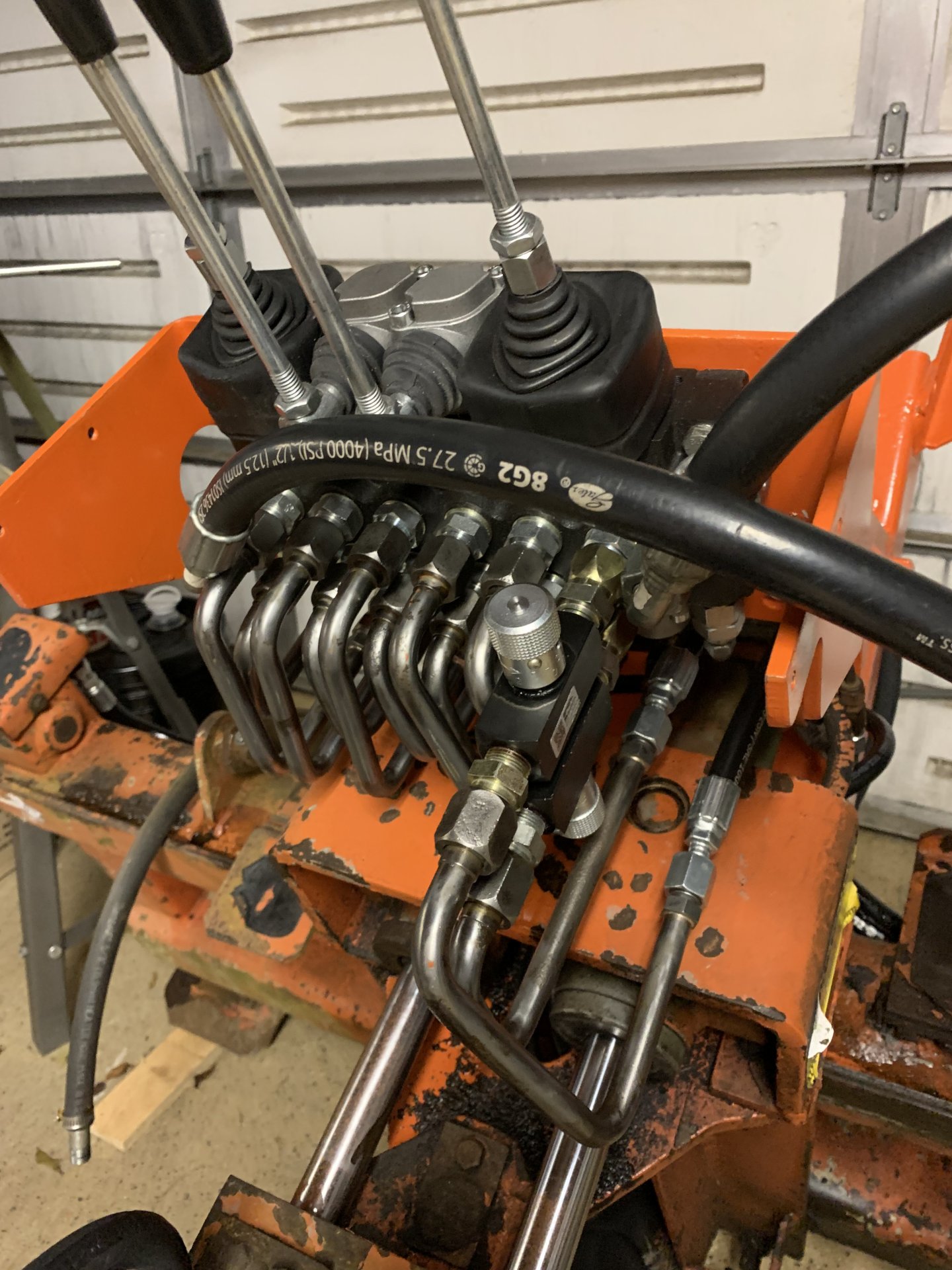

From your picture it looks like your control location is different than mine.
Here's a few pictures of my control setup. See the picture from my previous post for a view of the general location.
There are two versions of the control placement. One is operated from inside the cab and the other is operated from a seat outside the cab.
Mine is the seat outside the cab type.
I've never used the inside the cab style, but I would think you get a much better view of the hole you're digging when sitting on top of the backhoe rather than sitting inside the cab.
I'll see if I can find a picture of my seat location.

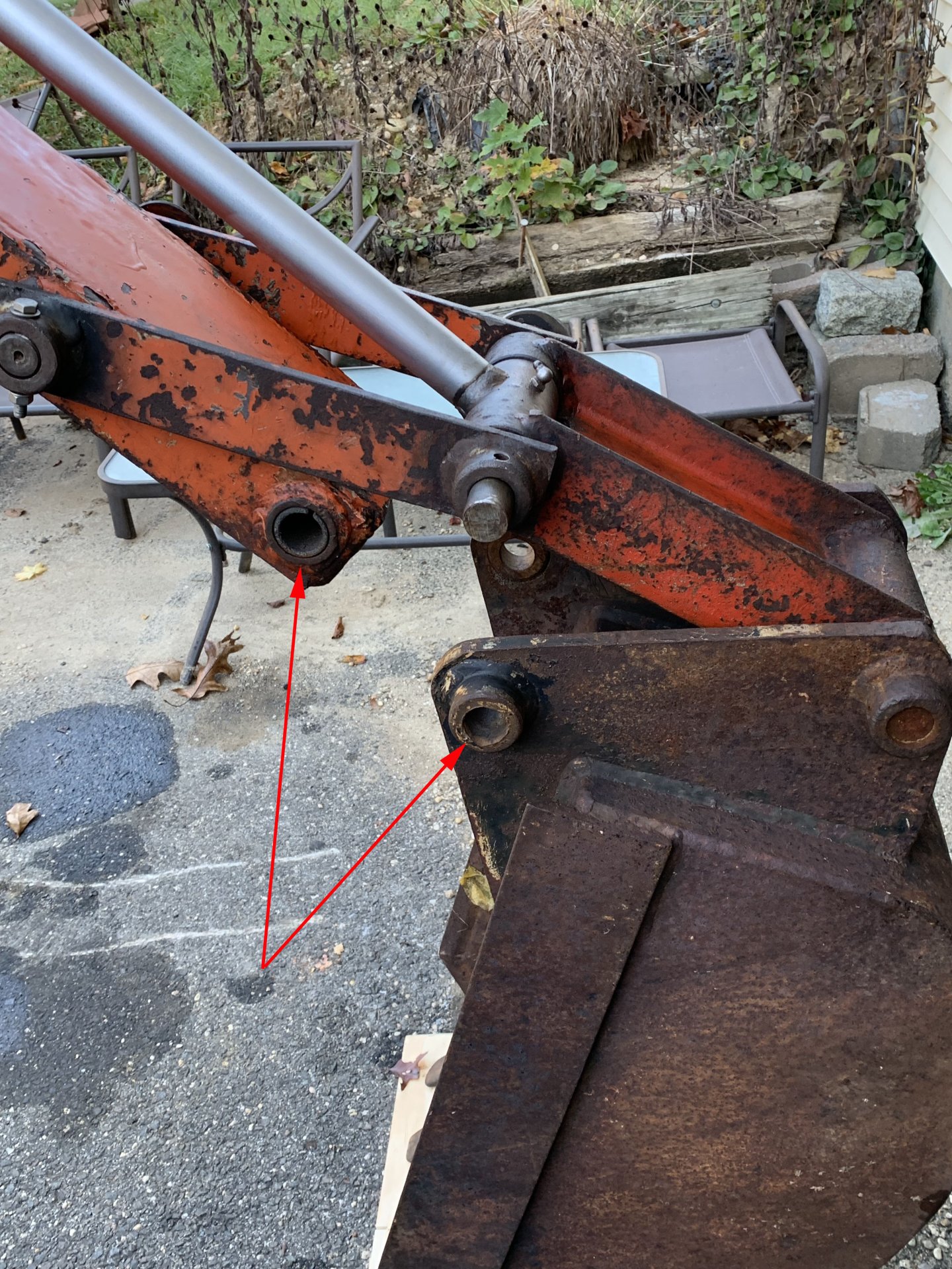

A word of caution about the curl pins on the bucket. One of the curl pins has no grease zerk for applying grease (at least it didn't on mine). The pin runs dry and unless you remove it to apply grease by hand it may seize.
Also, the extreme pressure exerted by the curl cylinder tends to bend one or both of the pins that are welded to a plate that forms them into a "C" (you can see it in the picture as a steel plate located just above the leftmost red arrow). The far side plate has the pins welded to it, the nearside plate is removable and held on the pins via a nuts and bolts.
Bottom line... it ain't easy changing buckets but even if you don't ever need to change buckets, it's best to take all the curl pins out periodically for cleaning and a good lube job.
In the picture below, the red arrows are pointing to the pivot point that has no way of getting lube (pin is removed). Look closely and you'll see there is a steel bushing in the end of the dipper that should be changed as needed. How long between changes depends on how much use the backhoe gets.

Excellent advice ! Maybe one should drill in grease nipples to those dry spots . Thanks for the warning !
Just throwing this out. Could you drill the pins for grease/zerk fittings and the places that need grease at the pivot points.

Pictured below is the axle extensions that took about a month to build.
