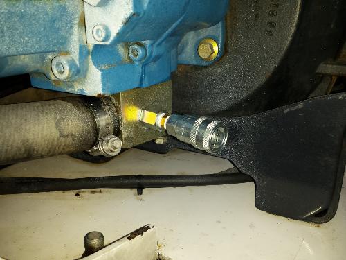

Just wanted to update that I managed to get my pressure tester up and running...I bought the gauges and whatnot years ago, but never had a need to check anything...up until recently, when I got a little foaming in tank (usually after a hot run - short cool runs, not a problem). So, I looked at reservoir cap...tore it apart, and it looked good to me. I then pull out diagnostic kit I made up, and the diagnostic coupler doesn't fit into Bobcat's ports. So, after three fails, I got the right one Dixon 1PDF2....(1/4" NPT on backside). Very cool being able to measure pressures...haven't checked everything yet, but so far it looks like joystick pilot pressure and pressure build up valve are good. Well, the latter might be a tad high...will double check that one. The manual has fairly easy to follow instructions to check pretty much everything. The only kit I wish I had was a pump flow tester...but there is no Mcgyvering that one...at least easily and cheaply. Main Relief and Cross-port Relief valves for each function will interest me... Maybe even do a little modding...lol I'll know I screw something up, but it is all good...
Ok, got all the pressures... Everything is within specs, albeit on low side, except Main Relief on Manifold block (P2 & P3) - 3300psi (range 3400-3550)). Was hard to get swing over relief as I couldn't get lock on swing to engage, so I used blade as a stop, and arm was fully over relief. Looks like I can adjust main relief to get some more oompf. P1 was 2600psi (boom offset at full relief gets me that number). (range 2550-2700psi) Swing motor (P3) gave me 2650psi going both ways (2650-2950 range). So, generally, all looks good...other than Main Relief has some room to play with. Looking forward to actually adjusting that, as it may give me more oompf on swing and arm. To tuckered to pull out tools and adjust right now...will update once I adjust. Really glad it appears I have no major issues.

Got er done Tazza! On every page of manual, it clearly notes the need to have machine at operating temps...specifically, the hydro oil at 150F. I adjusted the main relief valve on the manifold! My first play with hydraulics. I don't count the myriad of hoses I've replaced or ram tinkering as hydraulic work. I'll admit, I was a bit daunted by all the hoses and valves everywhere...slowly, I am starting to understand how it all works. Was cool being able to adjust pressure...and it was ridiculously easy. Might even move Bobby into a new weight class....lol Ok, maybe not... On mine, the main relief is just behind the main diagnostic port. Loosen locknut, and use an allen key clockwise to increase MR pressure. One full turn equals 500psi, so I didn't have to turn it much to get back in the zone (bumped it up 100-150psi). The result was the bucket now overpowers the thumb (back to normal), as it should. It didn't before, and that was my first clue something was wrong. I'll get around to the oil changes later....lol BTW - if they spec'd engine oil 10w-30 as a substitute, one would think most name brand hydraulic fluids would work. Just getting the right weight would be key...imo As far as additives go, I would be inclined to stay away from exotic hydraulic oils...just stick to the big brands that don't have some new super duper additives. Really would be nice to get the specs on the pump though...the pump specs are another key...they will tell me what oil it likes to chew on and keeps the pistons happy. As for the rest of the hydraulic system, I doubt they'd mismatch the oil requirements from the pump. Looking forward to firing up Bobby and seeing how the new pressure affects performance.
