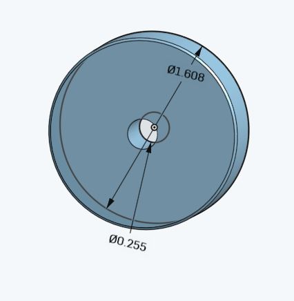

I've spent some time getting the parking brake to operate correctly on my LX565. The brake components are quire expensive from the dealer so I machined my own brake pads (1 per side).
Here is a link to the LX565 Brake Puck - PLUG 9829942 drawing: https://cad.onshape.com/documents/c...53a351b439d95175ed/e/ed822c1c1c6247c2cf9b19bc
I used mild steel but brass or aluminum could also be used. There are (3) bolts that mount the caliper. Don't remove the center bolt or you will have to re-apply RTV to the caliper to seal the oil in the chain case.

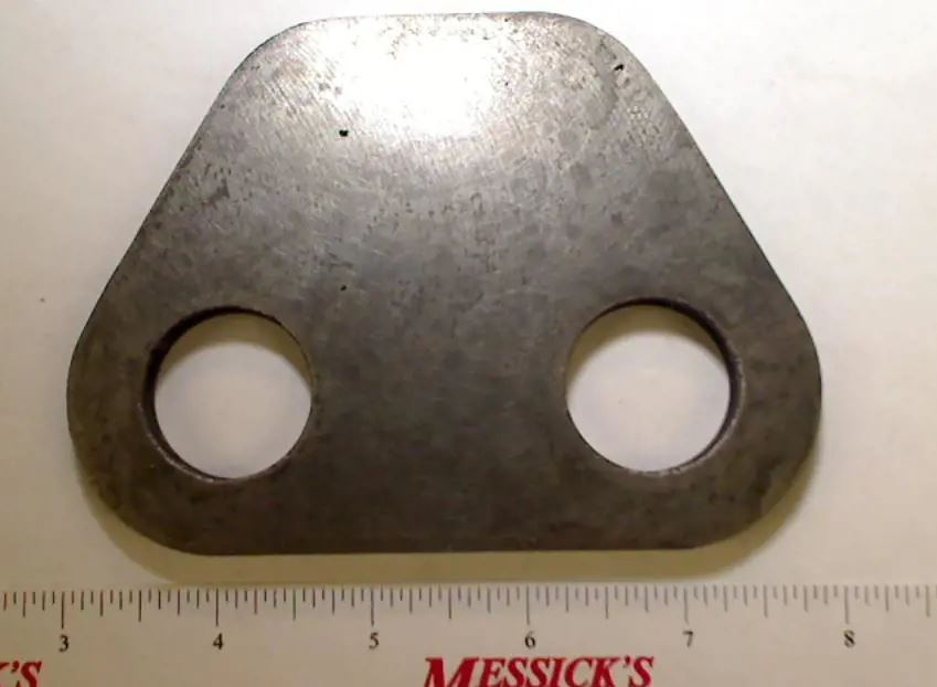

    20.4 KB
    11.7 KB
    47.7 KB

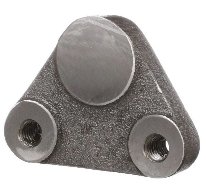

    63.7 KB

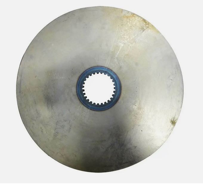

    38.1 KB
