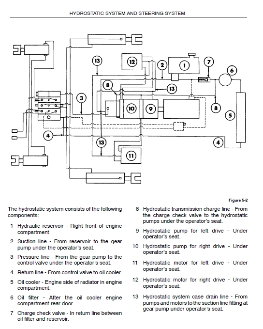

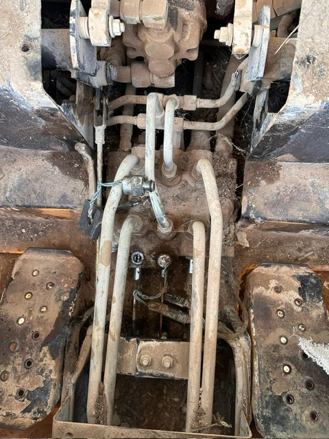

I attach MANUAL REPAIR LX565 and pictures

the first I was checking is around the main valve (cleaning) and pedal command .. No chance here … all is in order ☹…
Now it start to be worth = very difficult to tilt "up" like if something is inside the main valve circuit strangling the hydraulic way to tilt the bucket "up" ( tilt down is working).

the problem was that the right pedal ( TILT ) push at the same time the the actioner ACCESSORIES valve !!
Bad cleaning was soldering these 2 commands in the right pedal.
By cutting/separate the metalic ommand in right pedal we solve the problem., now the right pedal only activates the tilt and work fine
