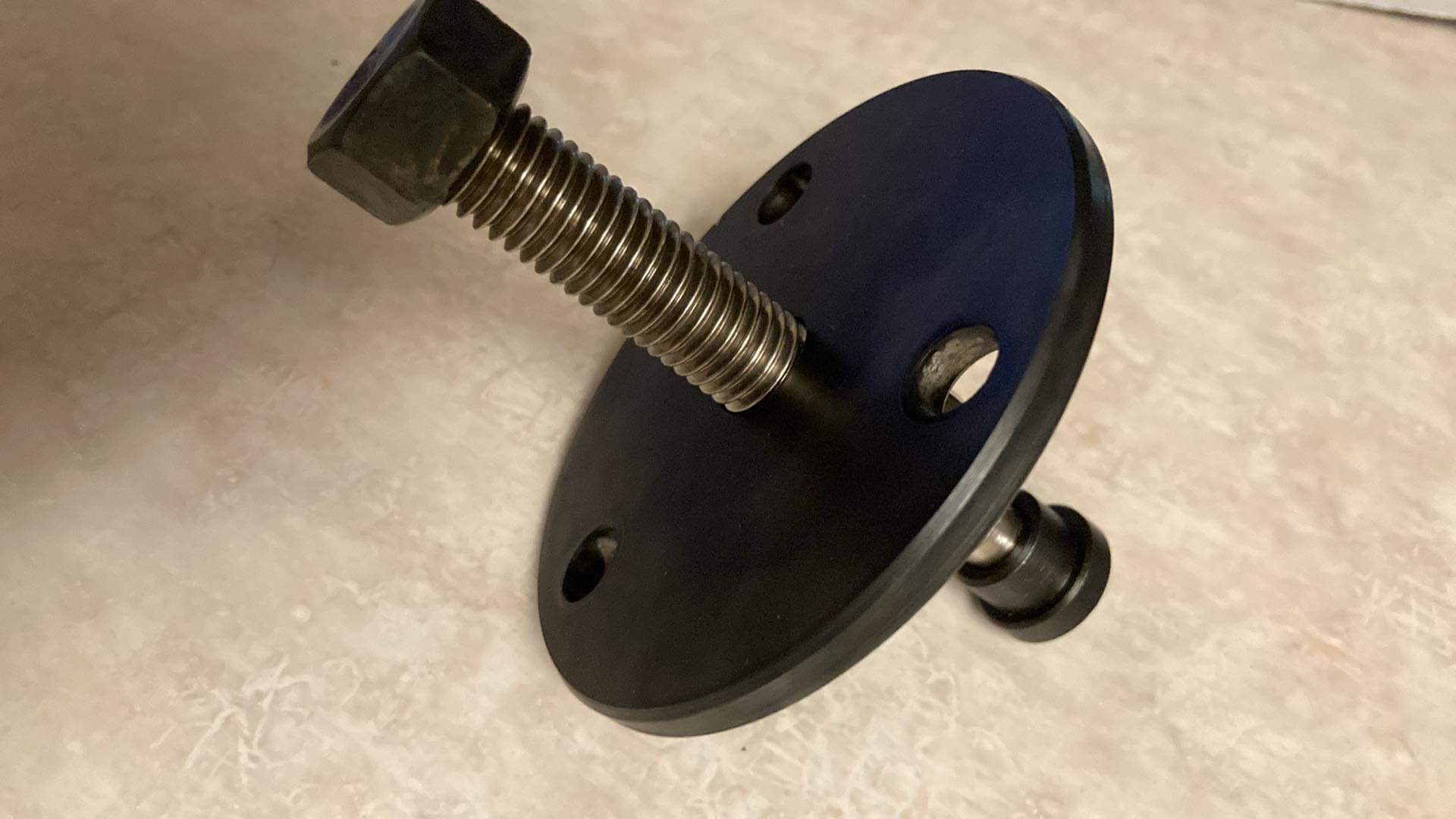

b. Remove front engine cover with DIY puller to remove crankshaft pulley. There are some hidden retaining bolts on cover, so be mindful if it doesn't come off easily.

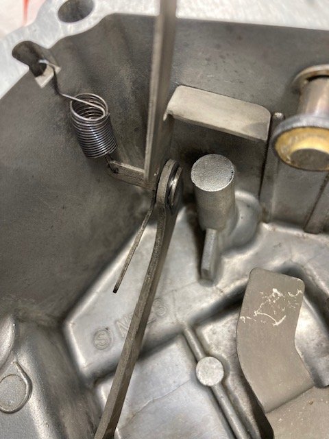

c. Inspect governor linkage
d. Some wear observed but not enough to validate syptoms - Replaced governor components despite no obvious cause

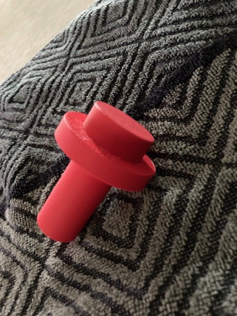

f. Installed new oil seal for crankshaft with 3D printed seal driver.
g. Found Max Fuel Adjuster and Max RPM Adjuster to have been tampered with. Not field serviceable and must be replaced with sealed adjusters. Decided to reset both adjusters to the middle of the range instead of replacement.

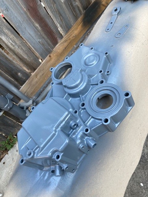

i. Installed painted front engine cover. It is a bit tricky to align the oil pump into the pin in the engine cover.
No more erratic engine speed following repair. Unknown what was the root cause but the Max Fuel Adjuster and Max RPM adjust should not have been tampered with. If anyone needs the drawing for the puller or seal driver, please let me know.

My understanding of the N844 governor system is springs and linkages, springs seem to loose tension over time, i wonder if you opening it up loosened things up? possibly even the injector pump rack, i wonder if that was part of the issue.
