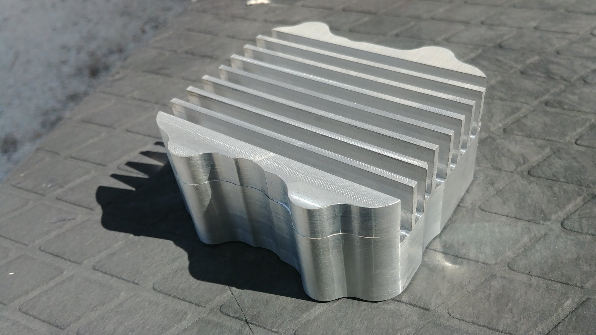

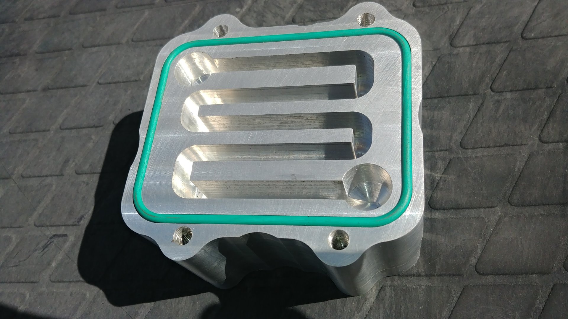

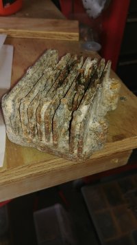

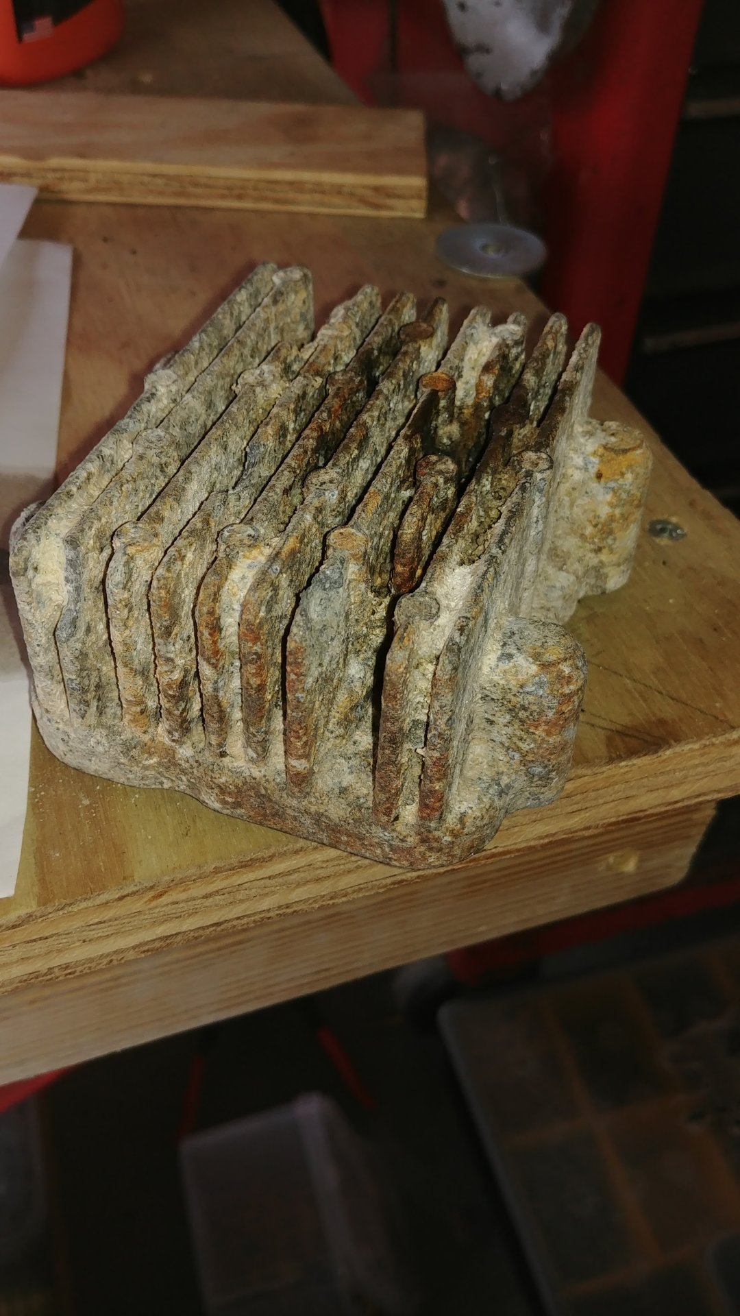

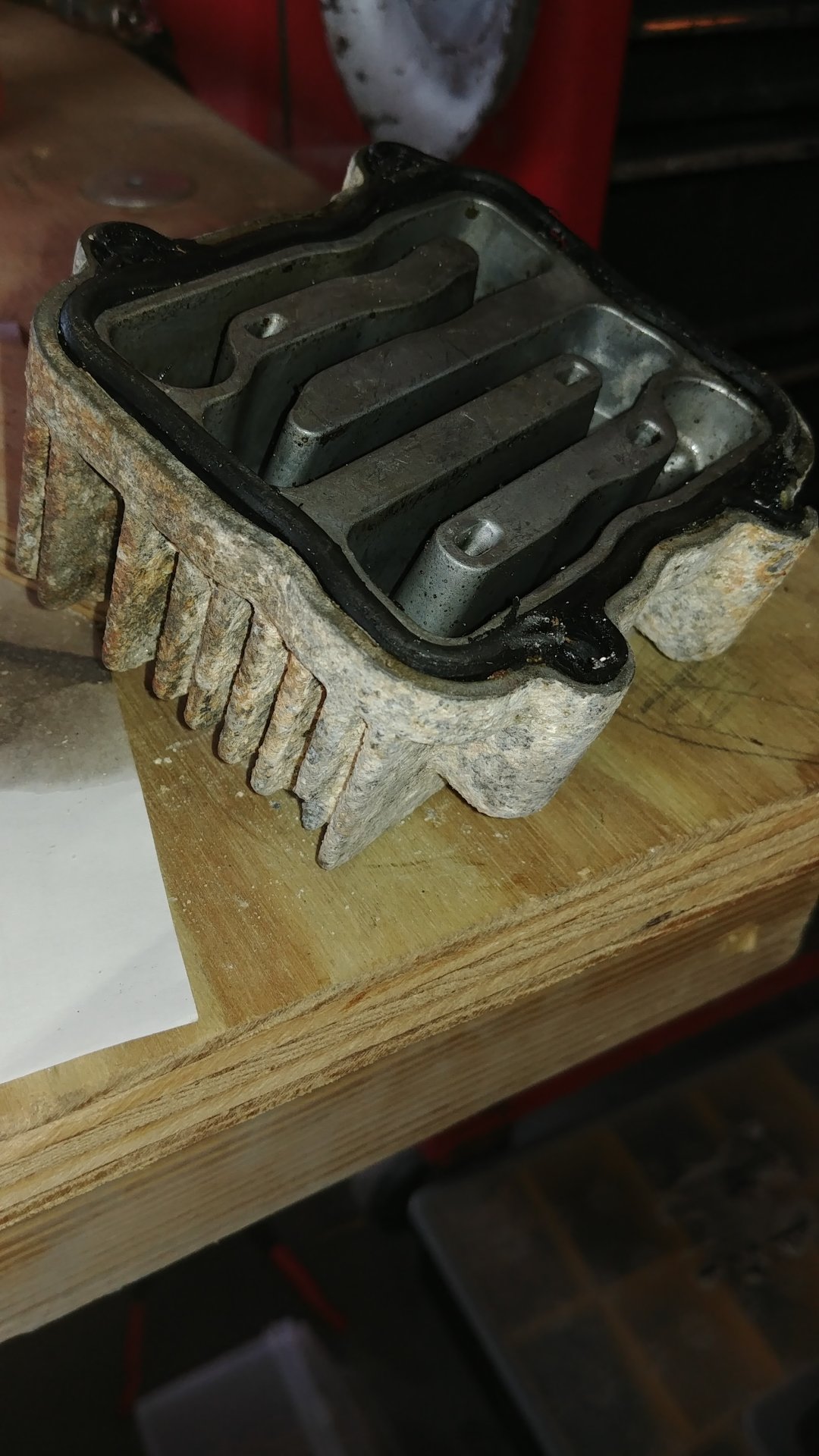

I think yes. I have an 08 185.b it has a 3 cylinder Iveco motor. The oil intercooler blew. There are none of these anywhere. I contacted dealers from Canada to Italy, and I live in Florida.The result was getting with a machine shop, where we designed and built a new intercooler out of billet aluminum. The original was cast and severely pitted with all the fins completely clogged. I have pics from several years ago.Hello, I am in the process of replacing a Turbo on my 2005 new holland ls185b and noticed the oil was milky. Is is possible the oil filter & cooler assembly is bad?
