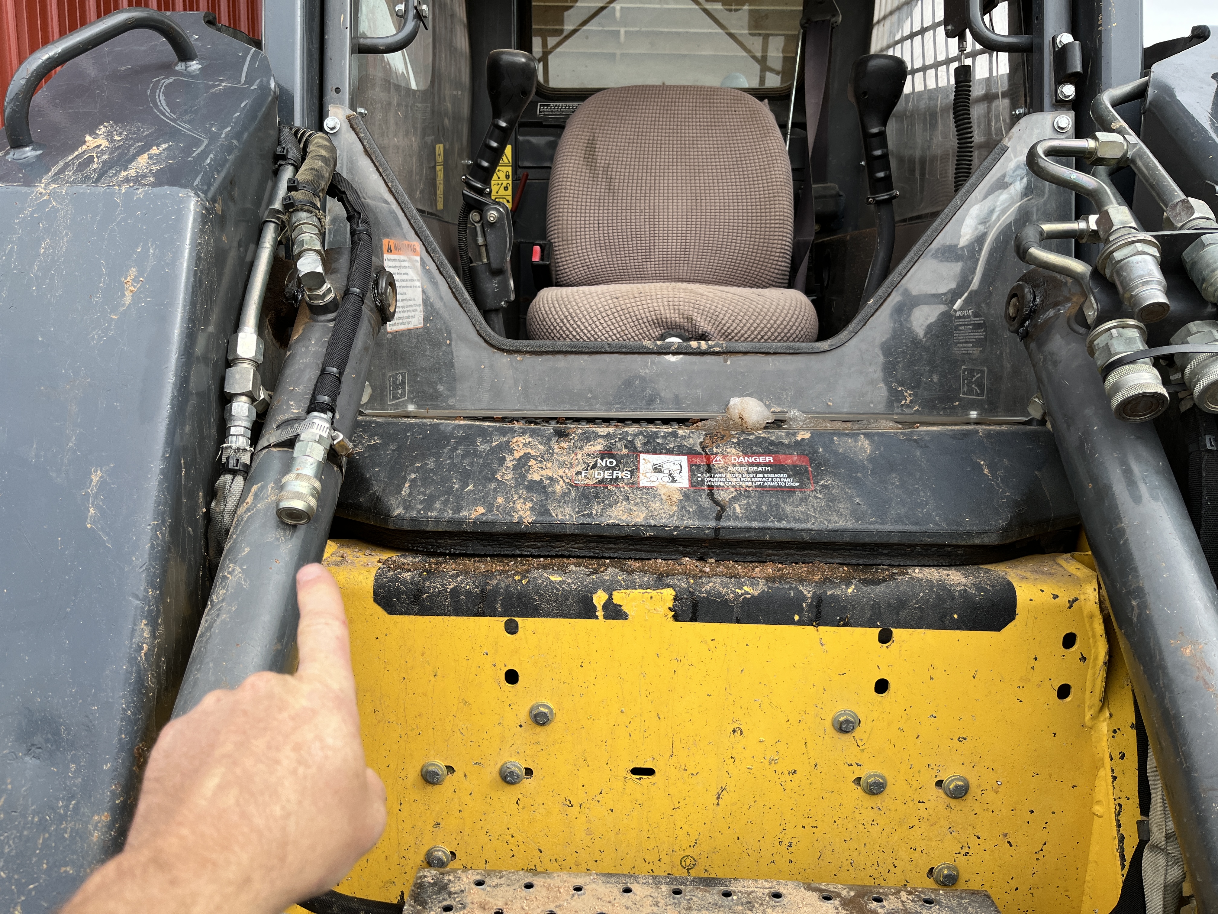

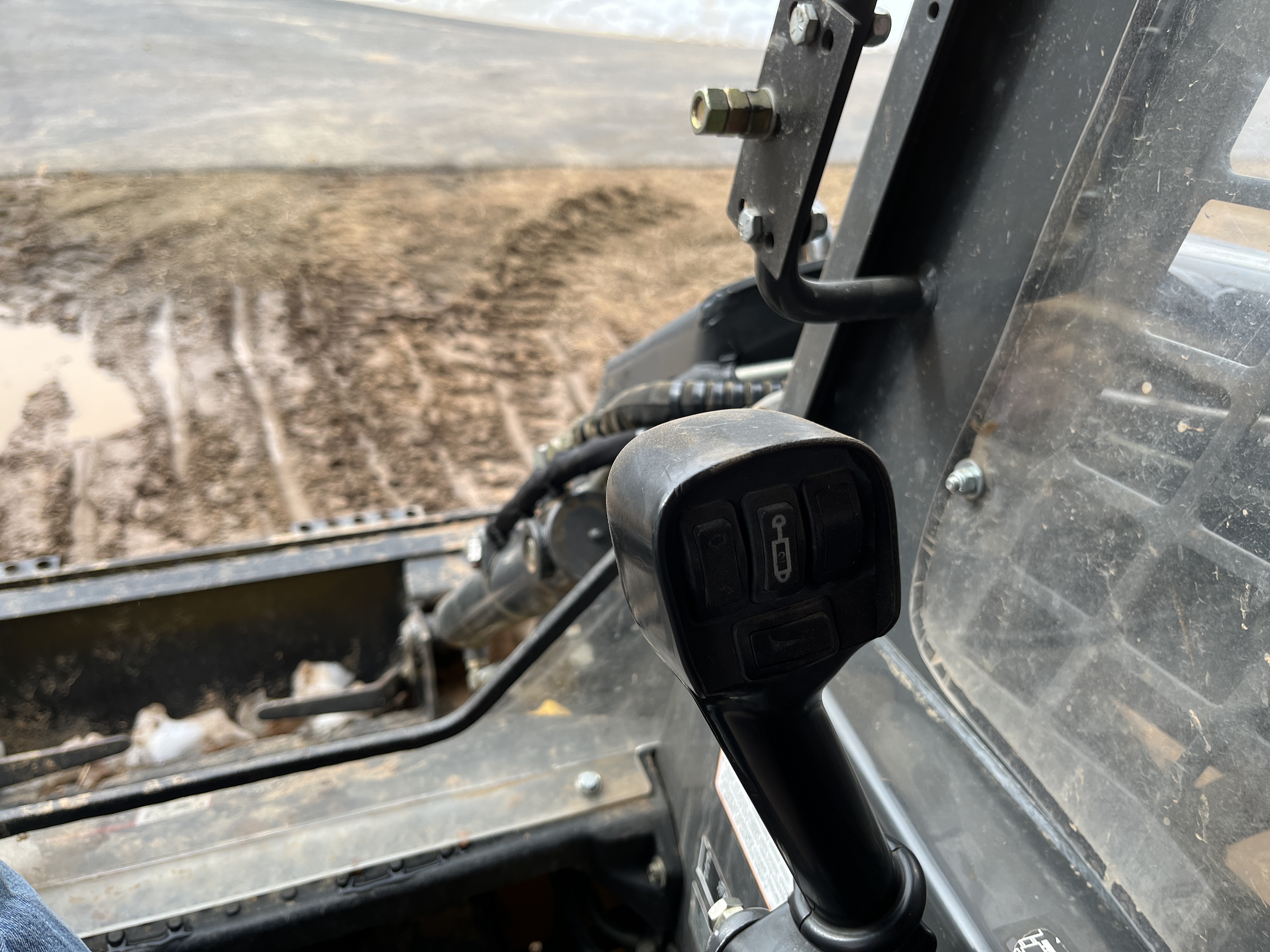

I have an auxiliary hydraulic output on the front that I’m confused about. My machine has the standard and high-flow output/return lines on the front plus one additional output. I ‘assume’ the additional output is operated by a thumb-switch located on the right-hand control lever. On the hand control there is thumb button with #2 on it. See photos.
My questions are:
1.) what is this small aux hydraulic output typically used for? What type of implements would use this?
2.) if used, what is the appropriate ‘return’ line when using this output?
Because the aux output is smaller than the other ports i would assume it’s lower flow possibly higher pressure?
I’ve never used it because the metal hard line high-flow/standard-flow ports are used to operate my straight-arm backhoe and my auger.
What is this guy for and who uses it?

I don’t think it would be a case drain for an attachment, but I’m not sure. What do you mean by a case drain for the attachment specifically? I guess I don’t understand what that means.
I have a thumb switch on the hand control with #2 on it. I thought this switch ports oil in/out of the 2nd Aux output line. But I’ve never used it so I don’t know the button actually ports oil in/out of that line…
I just can’t figure out what type of attachment would use the 2nd aux hydraulic line?
