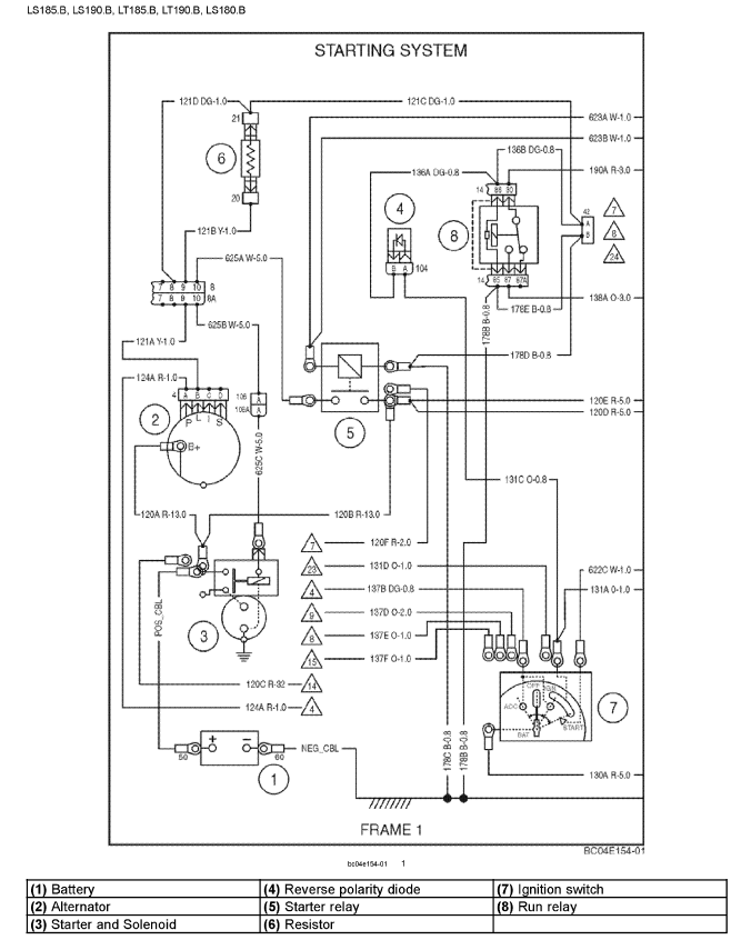

i recently put a new key switch on my ls185B. now it won't start until I actually release the key switch from the start position and will take off. I think I have a wire in the wrong spot. Does anyone have a wiring diagram? i have 4 oranges, a couple of reds, one is power, the other ignition. a white for the start and a dark green. i m not sure what the dark green does and where it belongs as I don't have it on my sketch.
