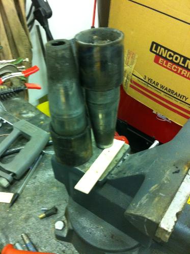

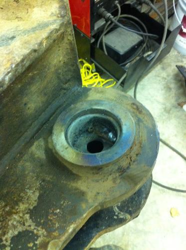

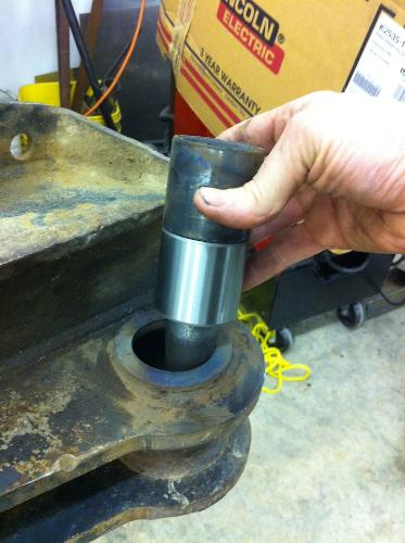

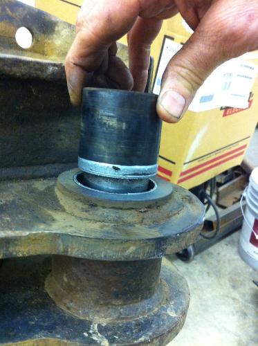

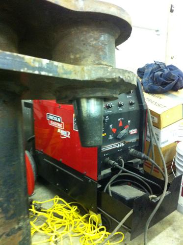

<blockquote data-quote="shepherd" data-source="post: 72872" data-attributes="member: 7978"><p>Both bushings had a bit of a tick-toc where the boss they pressed into was worn. I figured that next go around I'd weld in new mount bosses onto the bobtach, and tig welded the bushings into the boss. I was able to get a small bead on the inside edge of the bushing, as well as the entire outside, and feel pretty confident that it will be strong. New seals and seal cups, and stacked some large washers on the side to eliminate the side to side play and I am back in business. SD</p></blockquote><p></p>
[QUOTE="shepherd, post: 72872, member: 7978"] Both bushings had a bit of a tick-toc where the boss they pressed into was worn. I figured that next go around I'd weld in new mount bosses onto the bobtach, and tig welded the bushings into the boss. I was able to get a small bead on the inside edge of the bushing, as well as the entire outside, and feel pretty confident that it will be strong. New seals and seal cups, and stacked some large washers on the side to eliminate the side to side play and I am back in business. SD [/QUOTE]
