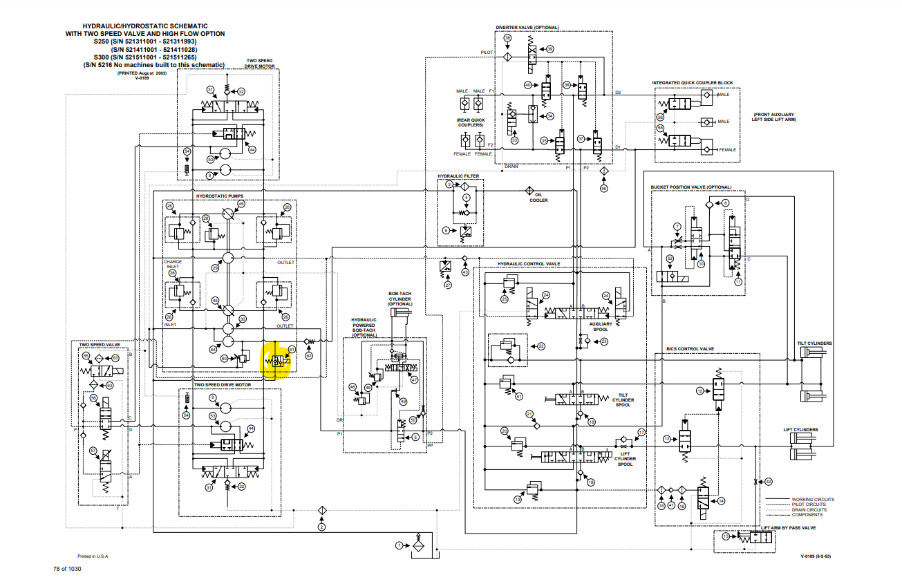

Good morning. I have been racking my brain over my 2004 S250 for quite some time. It will run a grapple or other low flow hydraulic cylinder from aux just fine. I get 3100psi at the connectors with a gauge. Problem comes when I'm trying to run a snow blower, or brush cutter. It will spin it up, but when it gets a little load, it slows it down, even stops it sometimes. I have high flow, and pushing the high flow button does nothing. The high flow light comes on, but no difference in hydraulic action. It has been this way for years. I attached the schematic from the service manual. It shows what they are calling a "dump valve ON/OFF" on the pump. The manual has nothing else about this valve listed. Nothing about removing, or testing it. I am assuming this is the high flow valve, and it dumps excess flow when high flow is not engaged. I have no power / actuation of this solenoid when high flow is on or off. Again, I am just assuming thats what this valve is for, as there is nothing else in the schematic for a high flow valve. I can't find any info online, or in Bobcat's wonderful service bible about diagnosing this system. Hoping some one here has some knowledge on this. Thank you. Brian

I don't think it's in the couplers, but that is definitely worth checking. Looking at the schematic, I don't see anything else in it that would control the high flow function. Unless it is controlled through the spool valve in the main control valve? I wish flow meters weren't so damn expensive, or I'd just bite the bullet and buy one. I own an automotive/ light diesel shop, but have never needed one in my line of work.. I already know that my flow is not up to par. But I can dead end the coupler with a pressure gauge and it will bogg the machine with 3k psi. We don't have any good skid steer guys around here, otherwise I'd just take it in.. I can make educated guesses and throw parts at it, I don't want to pay someone else to do that..

I'm sorry, I wasn't clear. The flow issue happens any time the aux hydraulics are engaged. The high flow light comes on, and stays on when the button is pressed, but nothing changes with the attachment. And it does this with both my brush cutter and my snowblower. When the high flow button is pressed, what is actuated in the machine to make the flow increase? I was assuming it was the solenoid on the pump.. Bobcat has that labeled as a "dump valve" in the schematic. Thanks Brian

It does have the high flow label. Not saying that someone before me didn't put that on there as some kind of sick joke. I was under the assumption that non high flow machines would flash the high flow light when the button was pressed, but it wouldn't stay on. That, and the mysterious dump valve that I am questioning shows up in the high flow schematic, but not in the standard flow schematic. That, to me, says it is indeed a high flow machine. I have ran the machine with both attachments in low flow and high flow mode. The brush cutter is not a high flow cutter, so I just did it momentarily to see if it made a difference in performance. The snow blower, is a bobcat brand attachment. I called the dealer to see if it was a high flow snow blower or not. They told me that the machine would automatically turn the high flow off if the snow blower was not a high flow model because they can sense it through the 7way electrical connector. That sounded a little crazy to me, but I couldn't find anyone/ or thing to tell me otherwise.
I have been tolerating this issue for a few years, it is now getting to bother me. The machine runs great and has always been a hell of a work horse... or cat, I guess??? But I plan on bringing it into the shop this fall when I can go without it for a while and tear into this, a long with a bunch of needed maintenance. She's pushing 5k hrs. I've been a master truck/diesel tech for 20+ years, just never got into hydraulic machines and such. I'm trying to take some time to familiarize myself on this before I go balls deep. I found a guy on YouTube (I hear these famous words every day from customers...) but he went into great detail on the hydraulic control valve / system of a bobcat. He explained in painful detail every valve and port on that thing.. But I, for the life of me, can't find anything on this infamous "dump valve", or the high flow system theory and operation in general.
So what controls the system from High flow to Low flow? Is it that dump valve from what the dealer told you it senses the pressure and may chang from High to low but that is a button that lights up and the system or valve it actuates maybe where your problem is or is it a printed circut that failed and it defaults to Low flow? Just tossing things out there. More ideas the better.
