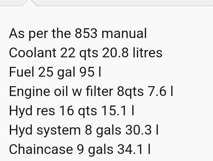

If the motor carrier seal goes bad the oil goes into the chain case.
If you remove the chain case oil plug on the front of the machine and oil pours out then that is most likely the problem.
