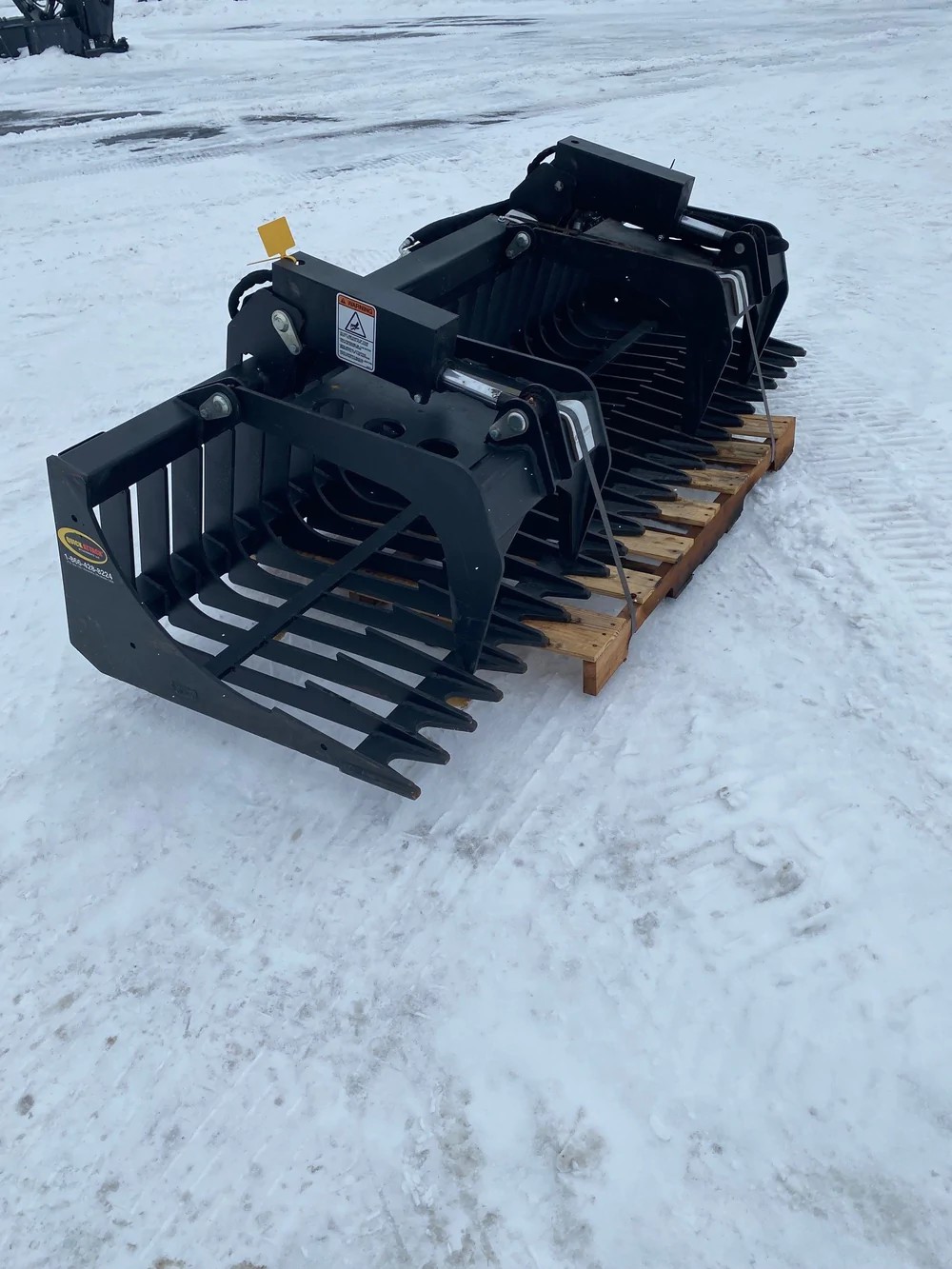

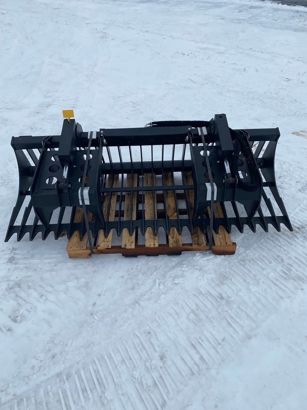

This is what Im looking at now for a grapple and tracks.
Im looking at the 72" model of this grapple. Around 600 lbs I think.
Grapple looks ok. The two grapples on top should work together in order to accommodate odd shapes. In other words, when you clamp down on something, if one of the grapples clamps first the other should continue to move until it clamps down.
I have come across some that once one grapple stops so does the other. It makes for a very unstable load.
