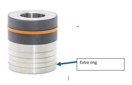

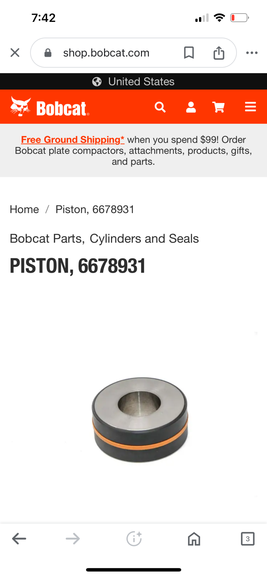

The origional pistons were discontinued for the 2017 s550 and said to use the new version. Also it said that both needed to be changed at the same time which he did. The only diffrence between the the old and new pistons was an extra ring around the piston which didnt take any seals.
Then he also changed all the other seals with new ones. It doesnt make any sence as I said before the arms were lifting with no problems before untill he got in there and now they wont lift or anything.
