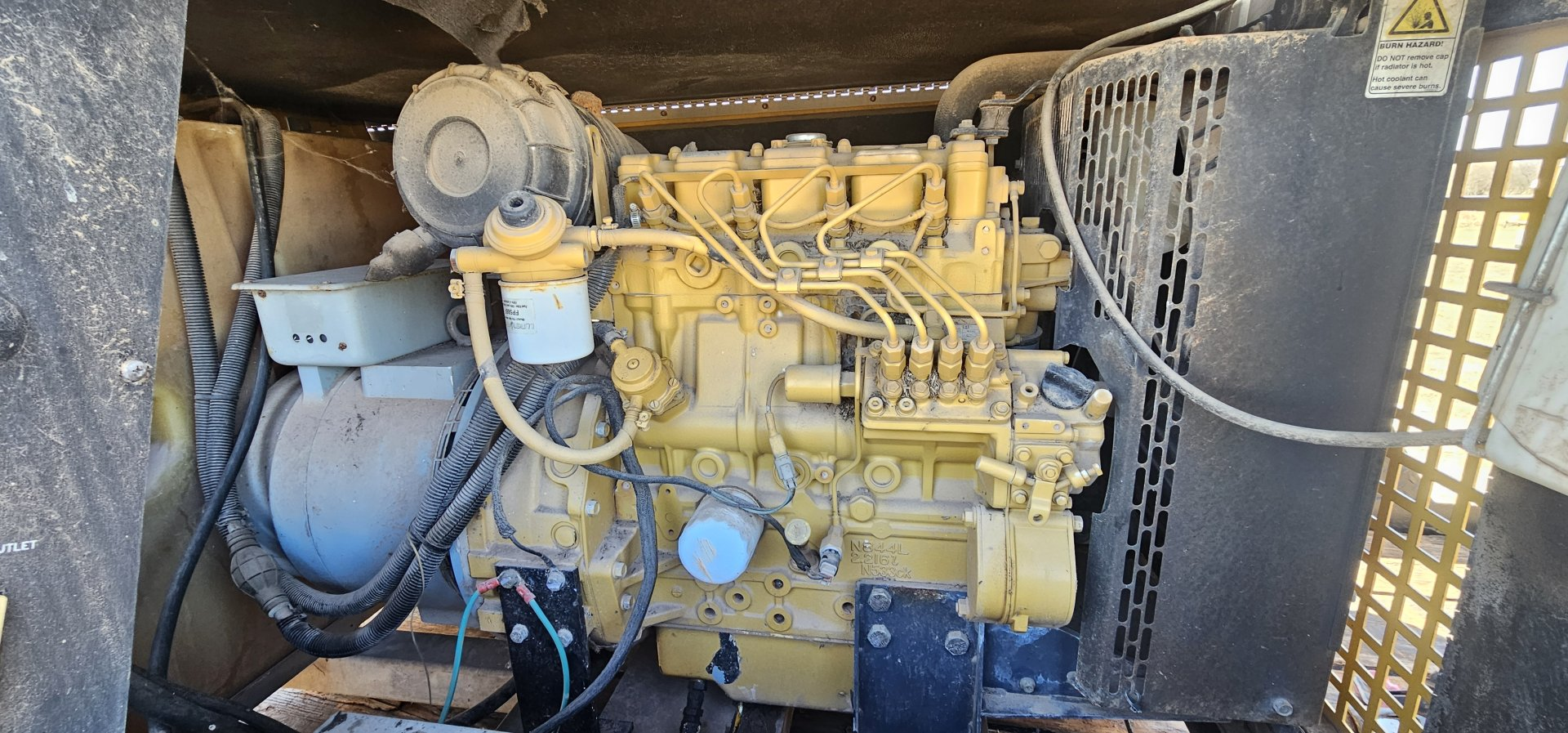

I did talk to a guy who has a light plant with a cat 4 cylinder diesel but that's a few hours away. I was thinking about going that route... ill see i haven't fully committed to this one yet.

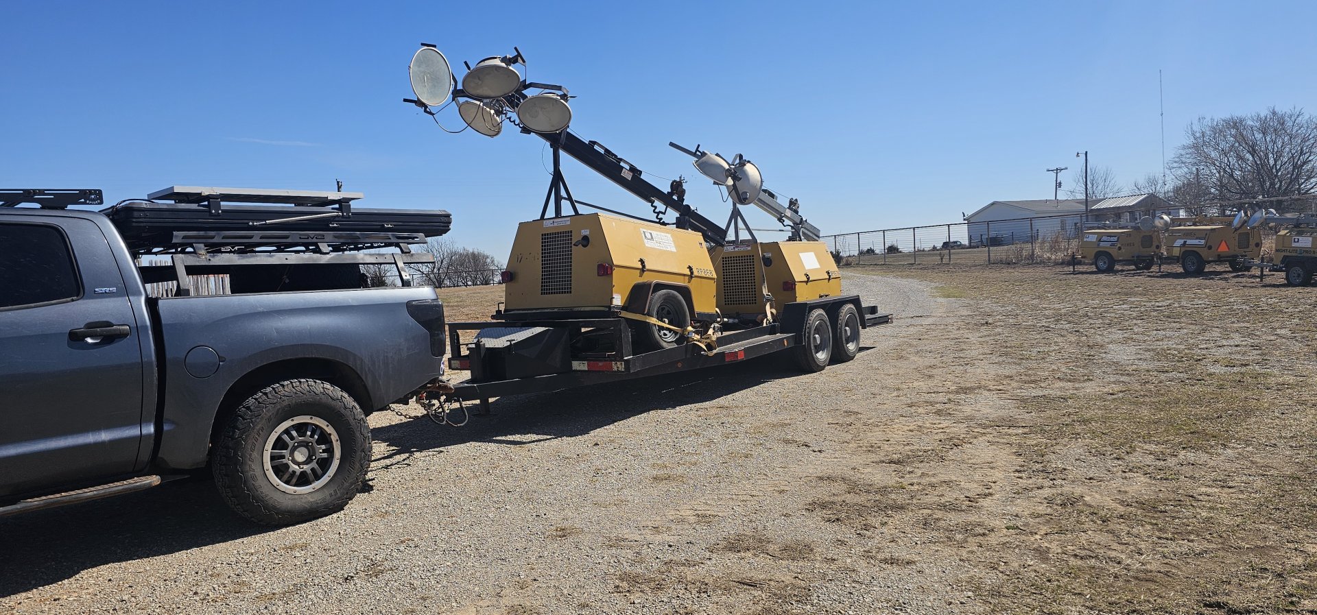

well i have decided to heed your advice. i pretty much have sold the vermeer and with those funds i'll go pick up the light plant with the cat 4 cylinder diesel. my mechanic and i made a deal, im selling him the vermeer and he will pull/install the cat engine in the L555.
I'll keep you guys updated once i pick up the new donor machine
Well since you guys wouldn't let me put a V-Twin 20 horsepower gas engine in there or a 25 horsepower Kubota diesel engine in there I went ahead and got two caterpillar four cylinders I think that should give me enough power right.
I'll put one in front one and back
View attachment 10720View attachment 10719

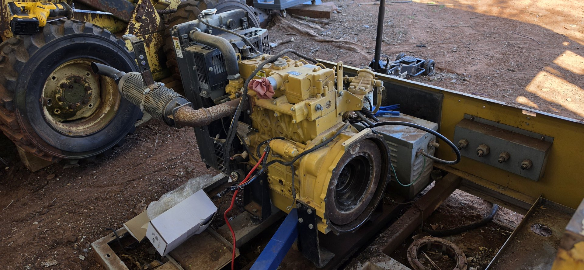

Well, the engine runs beautifully! Just need to find the time to get the generator pulled off. I did order a hydraulic pump plate.
I'm going to keep my fingers crossed, but damn it would benice if the hydraulic pump plate just bolts right up to the bell housing! but i'm never that lucky. I'll most likely have to fabricate an adapter plate... albeit a very short one. this is going to be a very tight squeeze...
I might even have to relocate the radiator(s) i'll see once i get into it.

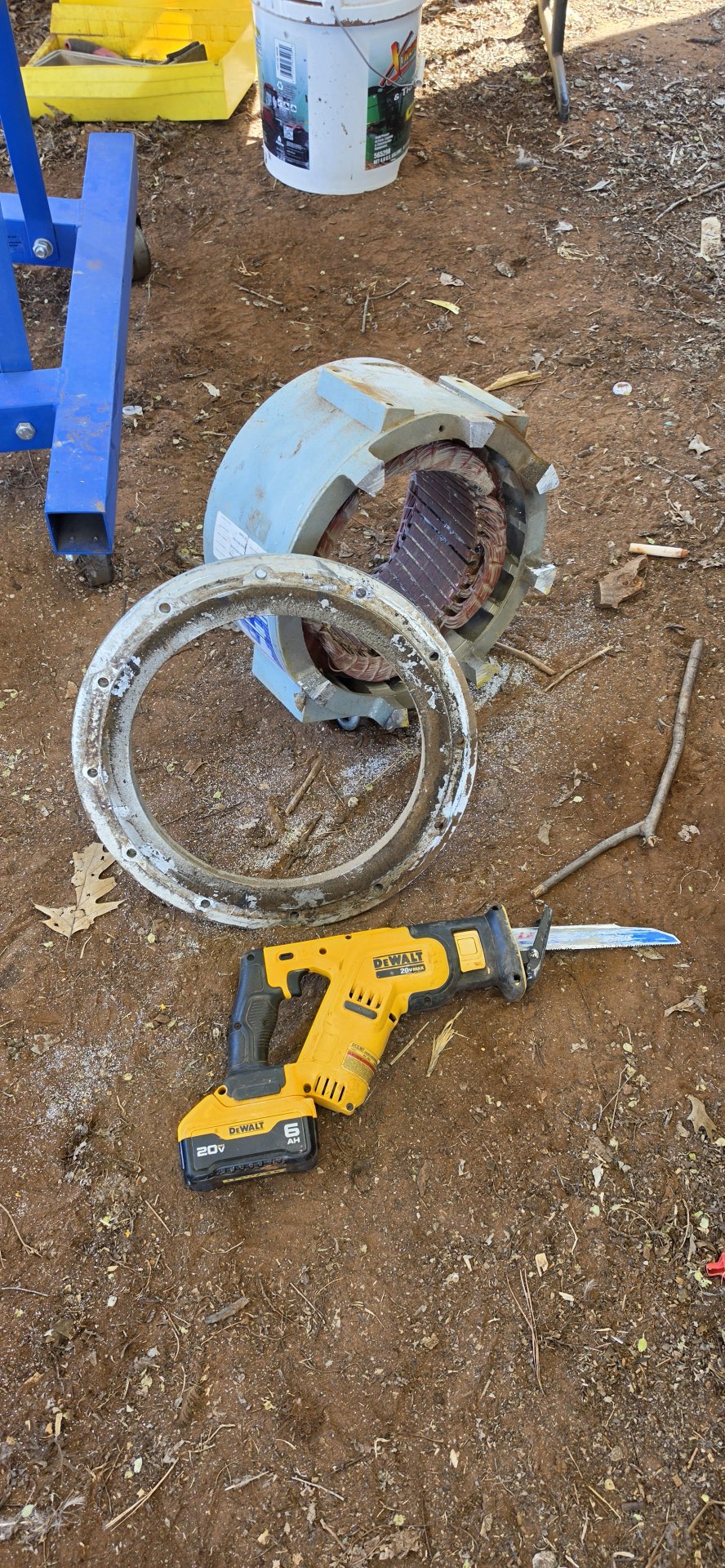

A. It of progress. Got the generator off.

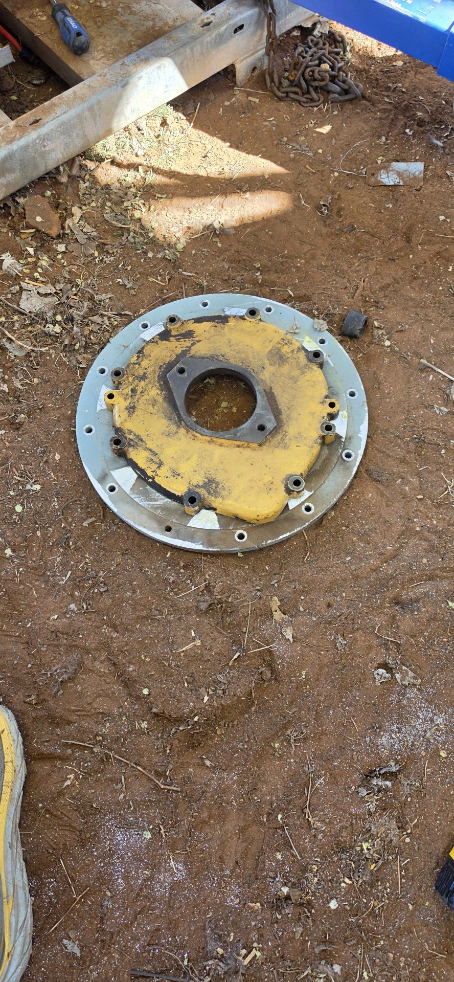

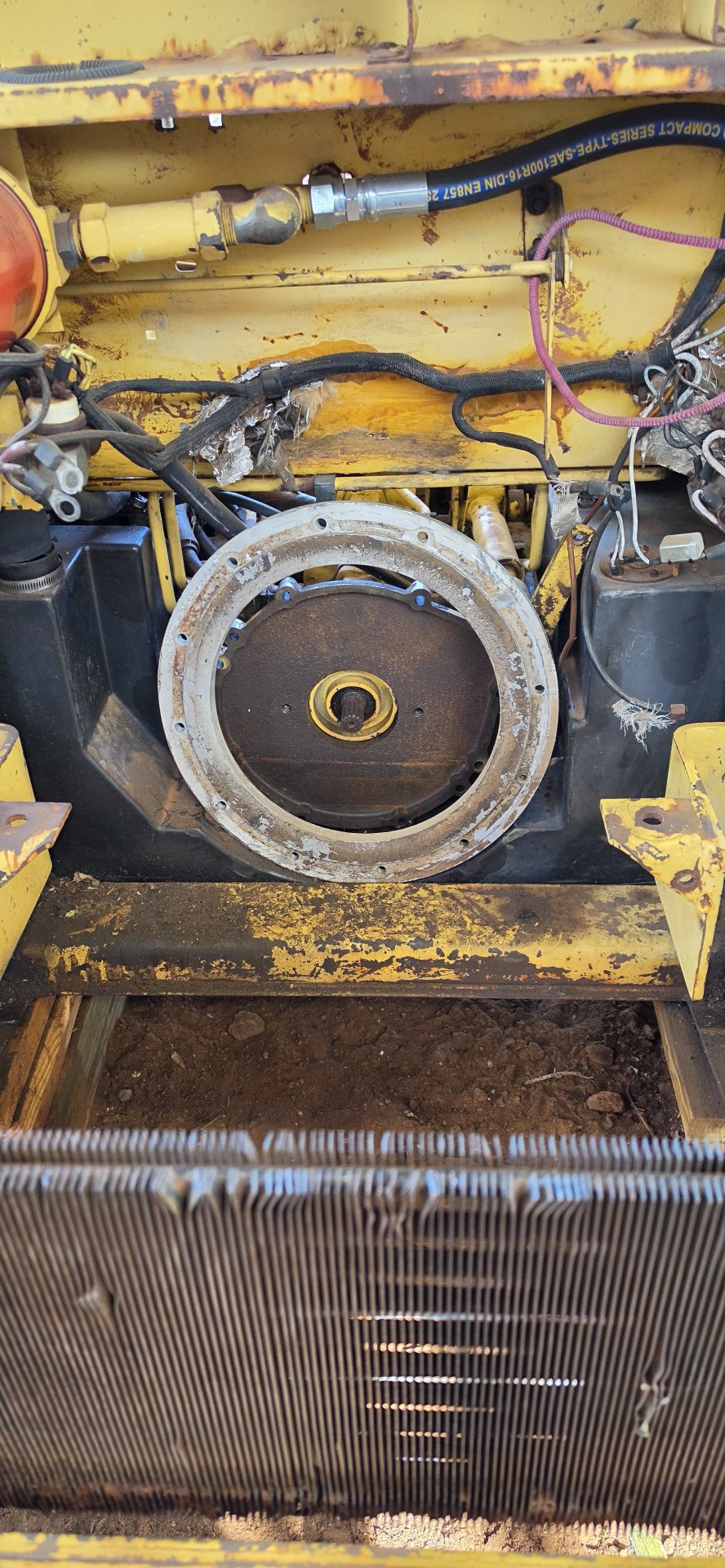

Got the pump adapter plate and I cut the bell housing off the generator to use to make an adapter plate.
Will have to do a lot of measurements to get exact center. Ordering a flywheel adapter to connect to the engine.
Not sure but it looks like i may have to cut out part of the fuel tank and maybe even have to notch the frame. This engine and bellhouse are pretty big.

Suggestion after looking at these two pictures
High likelihood that this engine was used in multiple industrial applications.
I would "assume" there could be another flywheel housing that would bolt to the engine AND reduce the size of the connection to the hydraulic pump.
Last thing I would want to do is start modding a fuel cell, especially if it is plastic, like my machine.
Just a thought
Good luck.
But otherwise looks like great progress.
Ok. Lets try this again.
Just a thought
Good luck.

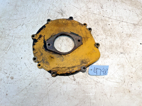

I looked on ebay for bell housing and flywheel housing and found some but i dont see how i could adapt them...
https://www.ebay.com/itm/354075986606
https://www.ebay.com/itm/177365216061
i mean i guess i could well the hell out of some adapter plate and make something... but that would also require a new flywheel and those are pretty damn expensive....
this one looks promising but i dont want to keep throwing money at parts that i have no idea if they'd work... i'd still have to replace the flywheel. and i've already ordered the flywheel adapter plate for the current one

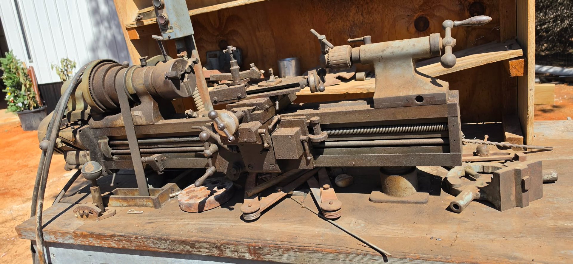

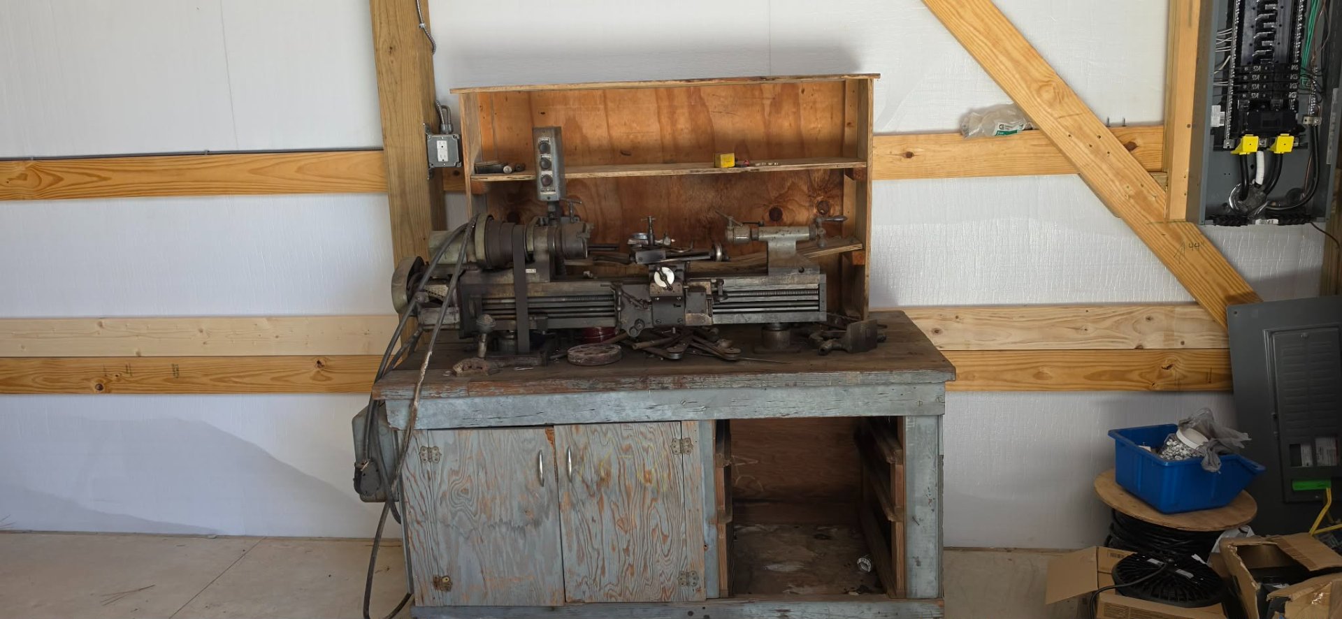

on another note i did just pick up a lathe!
my neighbor across the street is in his 80s and no longer builds/races race cars. it also has 3 drawers chock full of tooling. i just need to dump them out and get all the rat **** out it. they've got decades of rat **** and insulation. i also blew off the cabinets but will need to hit it with my shop vac today. will dump all the tooling out and get them cleaned and oiled up. now i need to learn how to use it!
