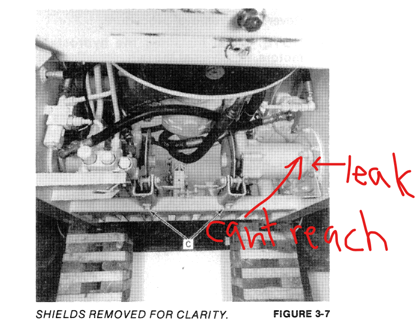

OK, I found this. This is a pic of the motor where the leak is. The two bolts removed is where it would bolt. The front nut was completely loose and it was leaking around the flange where the motor bolts on. The rear bolt is blocked partially by the fuel tank (which is removed in this picture). Manual states that they would put silicon sealant on the bolts and flange. So I expect I have to loosen and squeeze silicon around the edge (or RTV) and then righten it back up to seal it. But I still can't get onto the rear nut with the fuel tank there.
The pic that says can't reach in my mouse writing, is from below looking to the front. That's the one the fuel tank is blocking. It seems like simply tightening up didn't stop leaking. But I don't know how loose the rear is, finger can't move it, but there was a big gap at the front of the mating surfaces are where the front nut was loose (by loose, I mean not touching the motor anymore)

My mistake. I think in this case you have to move the fuel take which is something i am not sure what you have to do. It looks to e like you will have to also lower you hyr fluid level in the chain case. Could use a box end wrench and get that into there. Here is a problem yo will have by removing the fuel tank. The filler neck will come off.I can tell you first hand that thing is a bear to get back on. Mine came off because my tank was not bolted in on that side. I ended up going to at o parts store and they had a hose that was the same size which I then cut and after a lot of colorful words I got it on. I do know that many places they had special wrenches for things like this. I have a few and a few that was made by them My son went to school for NH equit for the place he use to work at. I think these machines were older thathe worked on

Ya that's what I am afraid of. (having to remove tank). I was hoping I could shift it enough to get something on that nut enough to loosen it off so i can squeeze insome rtv around the mounting surfaces and retighten. My hydraulic fluid is not full yet, so raising that side should drain enough over to the other side to be able to do it. But I need to move it to more space to work and clean up really well down there first... I already have the lower plates off and stuff but still need to get in there. I don't think smearing silicon around that joint on the outside will work for very long at all unless I get some in between the mating surfaces...

The motor is out of mine yet. I will have to take a look at it tomorrow and see what could maybe be done. If you could get it loose maybe spread the motor flange out and spray brake cleaner in there to clean it up and fill with silcone so it squeezes back down on it. Id there anyway if you shaped a box end wrench and bent it that you could loosen it up. These things are not ment to be worked on very easy are they
