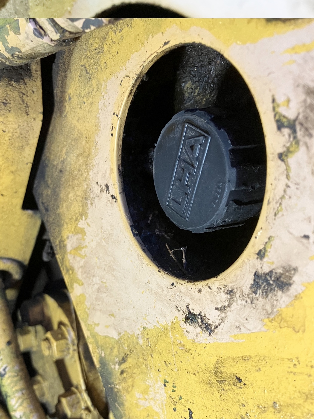

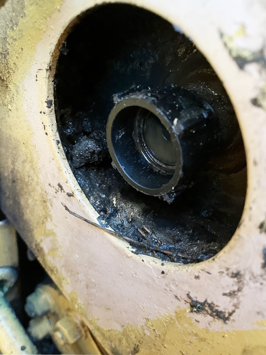

Found them. On the front cab columns, inside the cab. They look like bottle tops inside holes in the columns. The cap is push-fit and the plastic breather screws into the frame. I used a 1-1/4” AF socket to remove breathers.
On my machine, they were covered in dirty grease which falls down inside the main frame from the top boom pivot
