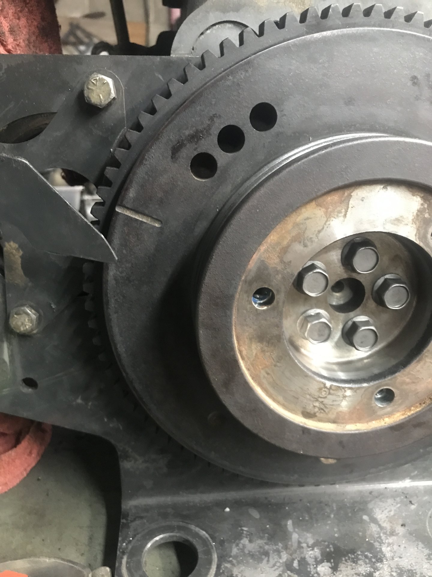

Got a bobcat mt52 with kubota d722. Bolts came loose on rear end plate. Replaced bolts and now installing flywheel. Can I just slap it on in any position? Or do I need to align marks for timing?

There’s mark on flywheel to match with starter plate? But can bolt on in any position?
some engines have a place to place a pin so you can work on the engine and it will not move. Do some research and see if your is one that does this. let me ask you this when the bolts were giving you a issue were they all sheared were as your engine is now out of time?
Kubota engines have no marks to aline the flywheel.
What they do have is one bolt hole is in a differnt alinement than the rest on the crank and flywheel.
It's a very slight differance, we're the replacement bolts stock or of the same type with a shoulder on them?
Hand tighten the bolts till they bottom out, if one or more won't thread then it's not aligned.
DO NOT FORCE THE BOLTS IN.
I have quite a few cranks here that were ruined by someone forcing the bolts in.
Most engines bolt pattern only allows flywheel to be installed one way
Do not cross thread bolts or use impact gun . Bolts should go in easy by hand then torque them to spec .
