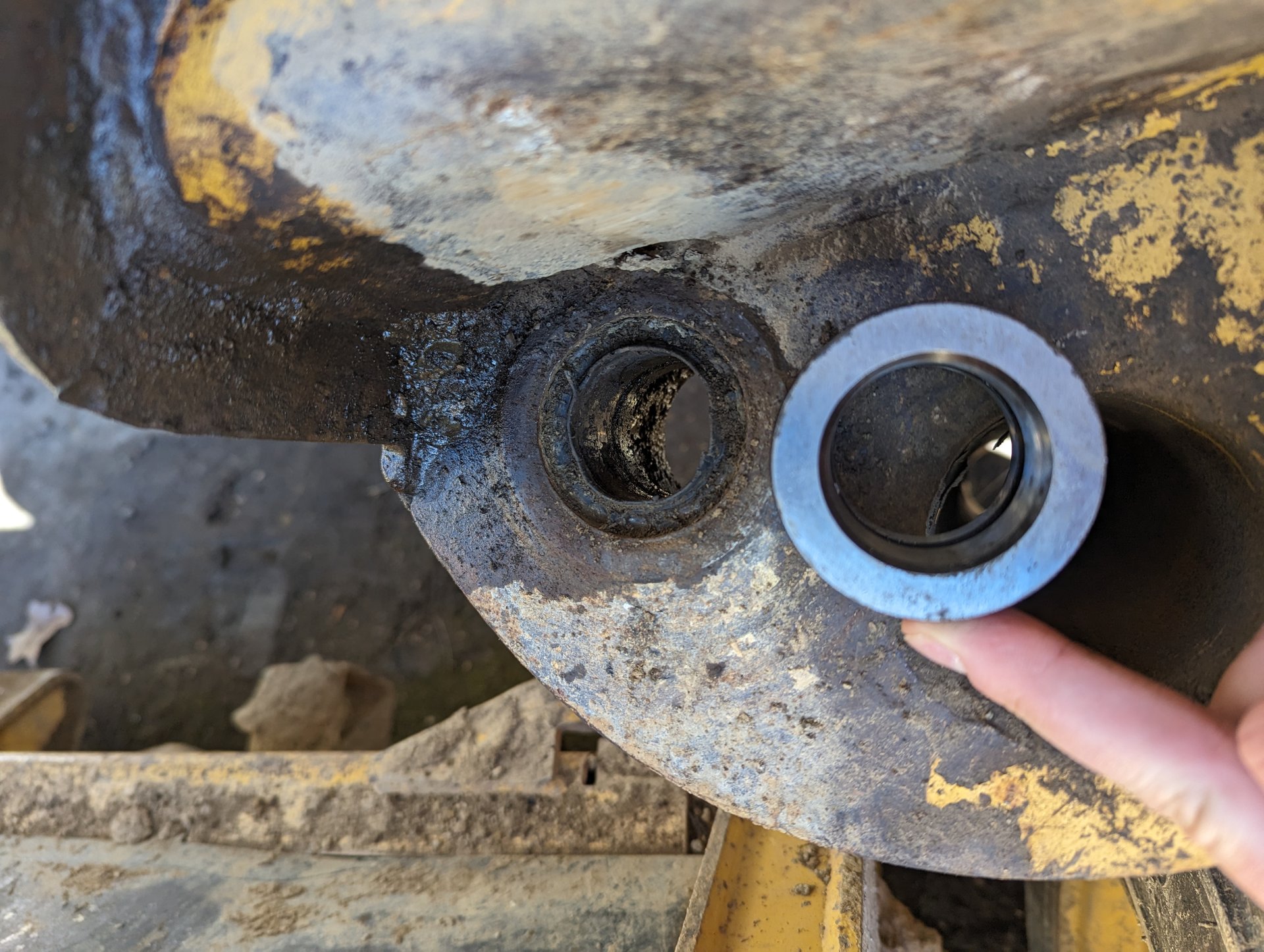

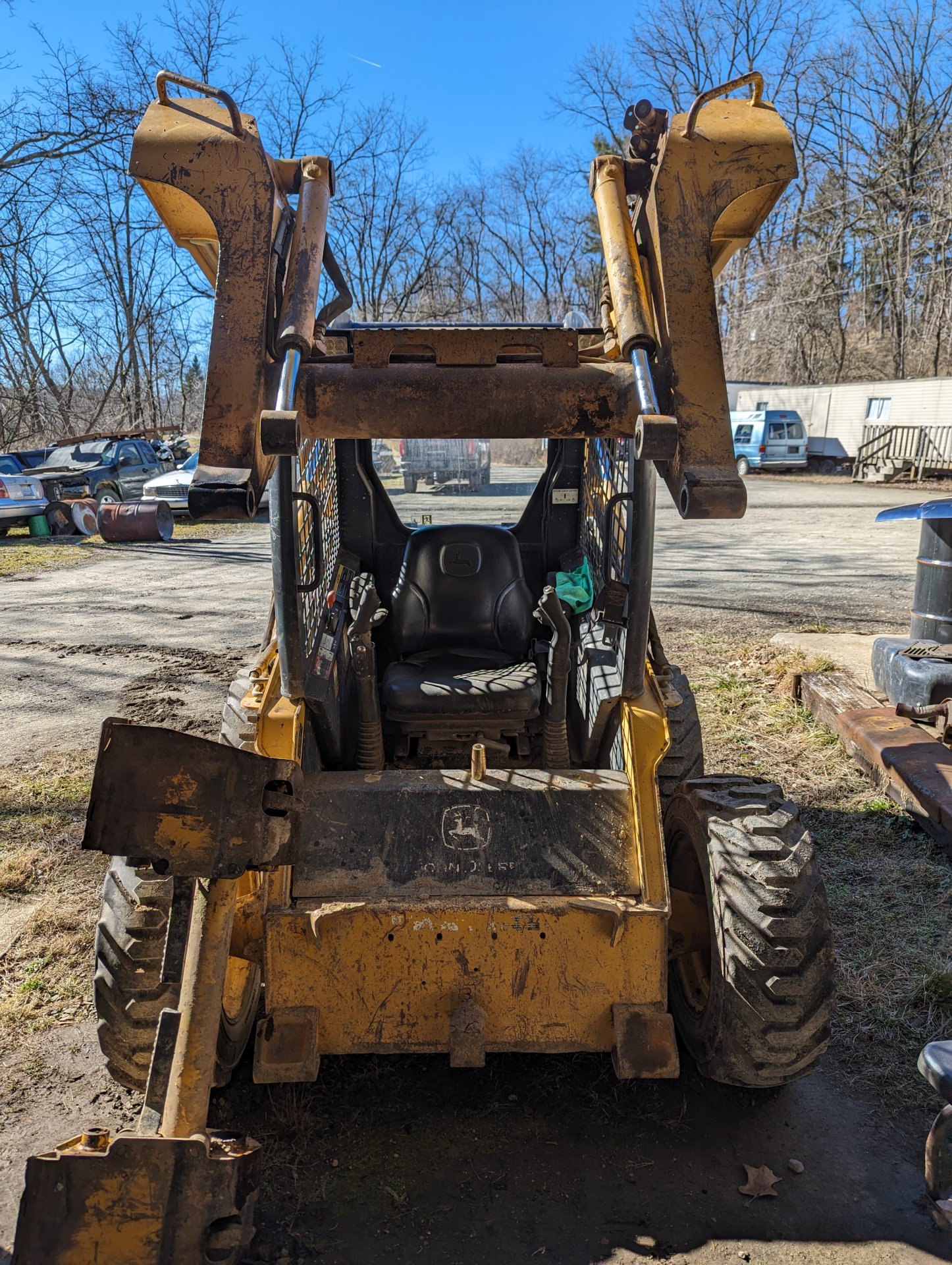

Hello, I have a John Deere 317 skid steer with a sloppy quick attach. I'm currently tearing it apart. I got everything apart and I'm noticing that the bushings in the machine have what appears to be a grease/dirt seal around the bushings. The replacement bushings that I bought do not have that rubber grease seal. Is this a separate part number? I know several of you guys have taken on this project already. You can see my new bushing and what I am calling the grease/ dirt seal in that same photo.
