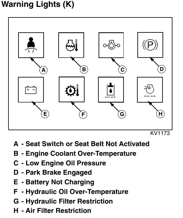

Hi Everyone!
Im new to skidsteering and have a John Deere 260. I have the manual, but Im not finding what the meaning of the instrument lights are. I know some of them are pretty self explanatory, but does anyone have an image with the meanings?
thanks

From page 12 of the operator manual
Is this what you're looking for? I can elaborate on them
A - the seat pressure switch and/or seat belt is not buckled, you need to sit and buckle
B - engine is overheating
C - low or no engine oil pressure
D - goes off when you disengage the parking brake
E - alternator is not charging up the battery while running
F - hydraulics are overheating
G - hydraulic filter is plugged and needs service
H - air filters are plugged and need to be serviced
Hope that helps.

Yes this is exactly what I was looking for. I have the technical manual not the operator manual. So I will have to try and get one of those.
Thank you very much for your help!
