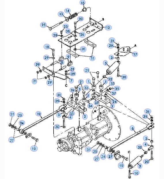

Hi everyone my NHLX465 is jerking back and forth at any speed when moving forward or backwards it had the coupler replaced and when it came back it was fine for a few days and then i heard a clunk the bolt ontop of the levers system came off and they told me that they forgot to put lock tight on it and the set it back up and now it is jerking realy bad any ideas or help would be great thanks

From what you describe and the history the problem is still in the centering system. This diagram is from the parts book and here's a link if you want to zoom in or need to order something.
https://www.messicks.com/catalogs/n...atic-drive/06c03-06c03-transmission-centeringI'll start by explaining how this works because anything loose in here can cause jerkiness.
- Bars 6 & 10 are connected to the bottom of your control handles at the front. At the back they are connected to the blocks 2.
- Control arms 2 are clamped (and keyed) onto on the control shafts of the hydro pumps. They directly control the oil flow direction and speed, thus steering.
- Shock absorbers 5 are meant to help dampen/limit jerkiness in the handles.
- Now the more complicated part - the bearings 1 are bolted into the top of the control arms 2.
- When assembled, the bearings 1 ride against the sides of the blocks 11.
- The angle of the blocks 11 position in the slots (angle when looking from the top down) in plate 12 controls the neutral position of the hydros so it stops and doesn't move when you let go of the handles.
- The plate 12 slides on bolt 25 at the rear and slide pins 8 via plastic blocks 9 at the front. Spring 14 returns the plate and system to the neutral position.
Clear as mud?
I think bolt 25 may be the one you said came loose.
Anything loose in here could be the problem.
I've had problems with the screws 23 holding the plastic blocks 9.
Also the angle of the blocks 11 sets the neutral, but they also have to be snug against the bearings 1. These are tricky to get set. It's best to have the loader up on blocks when adjusting them so you can see if the tires are turning while adjusting for neutral.
If everything looks correct, I'd want to make sure the key between control arms 2 and the pump shaft is there and in good condition.
This should be a good start.

Thanks for the information and yes it was the bolt number 25 they said it came loos because they didn't put any lock tight on it but now it's jerking like bad how would i fix this? or even find out what is going on when running it don't travel like it did or the handles moving but the right handle seems a little looser then the left some play in it hope this helps some

Start by checking all the connections of the parts I described above.
- Park the skid loader with the boom up and the safety locks out. Set the boom down on the locks.
- Raise the seat and check the bolts at both ends of 6, 10, & 5.
- Check 25 again and 8, 9, and 23.
When you move either handle (maybe even 1/2") you should see the plate 8 move forward or backward. There should not be a lot of play or free travel in the handles before the plate moves. Also, the plate should not twist or move sideways.
If you don't see a problem in these areas, then we'll have to get more detailed with my questions and the symptoms your seeing.

Hi everyone just an update as of right now the unit is still jerking back and forth fluid is full adjusted the levers everything suggested and still jerking any ideas?
Thanks
As I recall part number 5 which is a dampener, when it goes bad it can allow a bump to translate in to a jerk which causes more jerking however to stop it one could either stop or go full stroke on the drive handels and the jerking would stop, also we would adjust the chains on the drive axles as that also can cause jerking. What we have not heard from you is the conditions you are using the unit on its it hard ground or concreat or on dirt / field, does going full stroke cause the problem to go away? Also I wonder if part number 2 wiggles around on top of the pumps shafts, as I recall they had a little bit of play if the clamping bolt part number 34 was not snug down.
