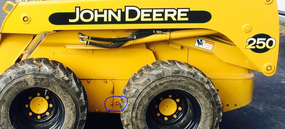

it would not take much water to freeze in a chain case to lock up the drive, especially if well mixed with the oil into a slurry, worth checking a easy check is park machine with the front or back wheels on a 4x4 to get all the oil to one end there should be a drain plug
You should be able to remove this plug on the opposite side and use a suction gun to remove an oil sample. If you suspect it is full of water you may want to put a pan or bucket underneath.
