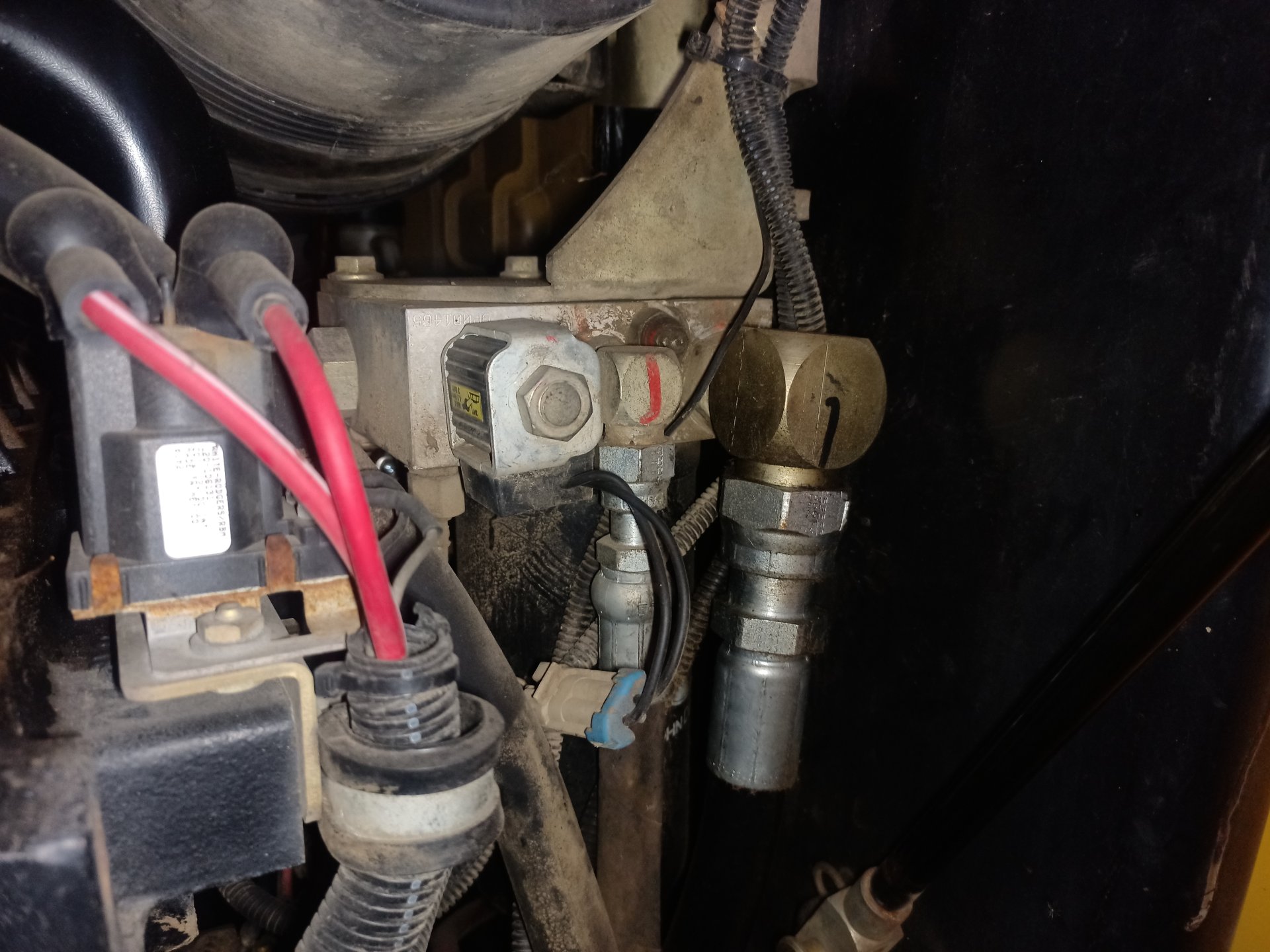

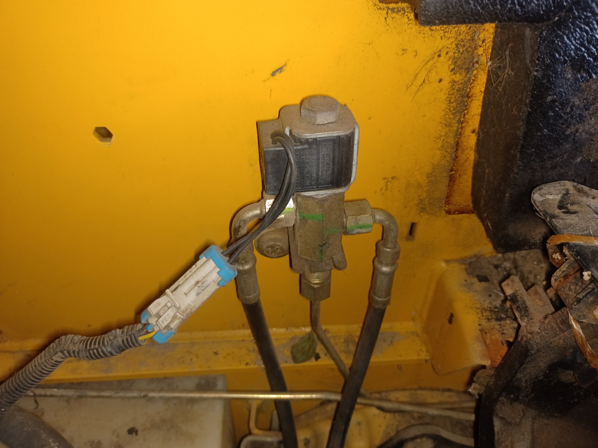

I have attempted to identify the park brake solenoid to prove the theory that it is an electrical issue by testing the solenoid, and if good, bypassing the park brake switch and activate the solenoid full time (for testing purposes only) however I can find nothing that actually identifies the solenoid's location. I have a full technical manual but I do not see it's location in the manual. I see two prominent solenoids, one on the left side of the seat attached to the side wall and one attached to a manifold block where the hydraulic oil filter attaches next to the return line. I am assuming the one on the manifold block is probably it but would like to have confirmation. Please see attached.
