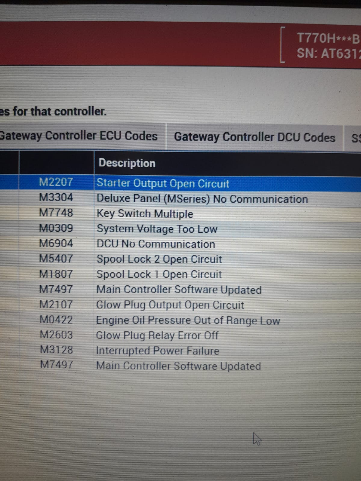

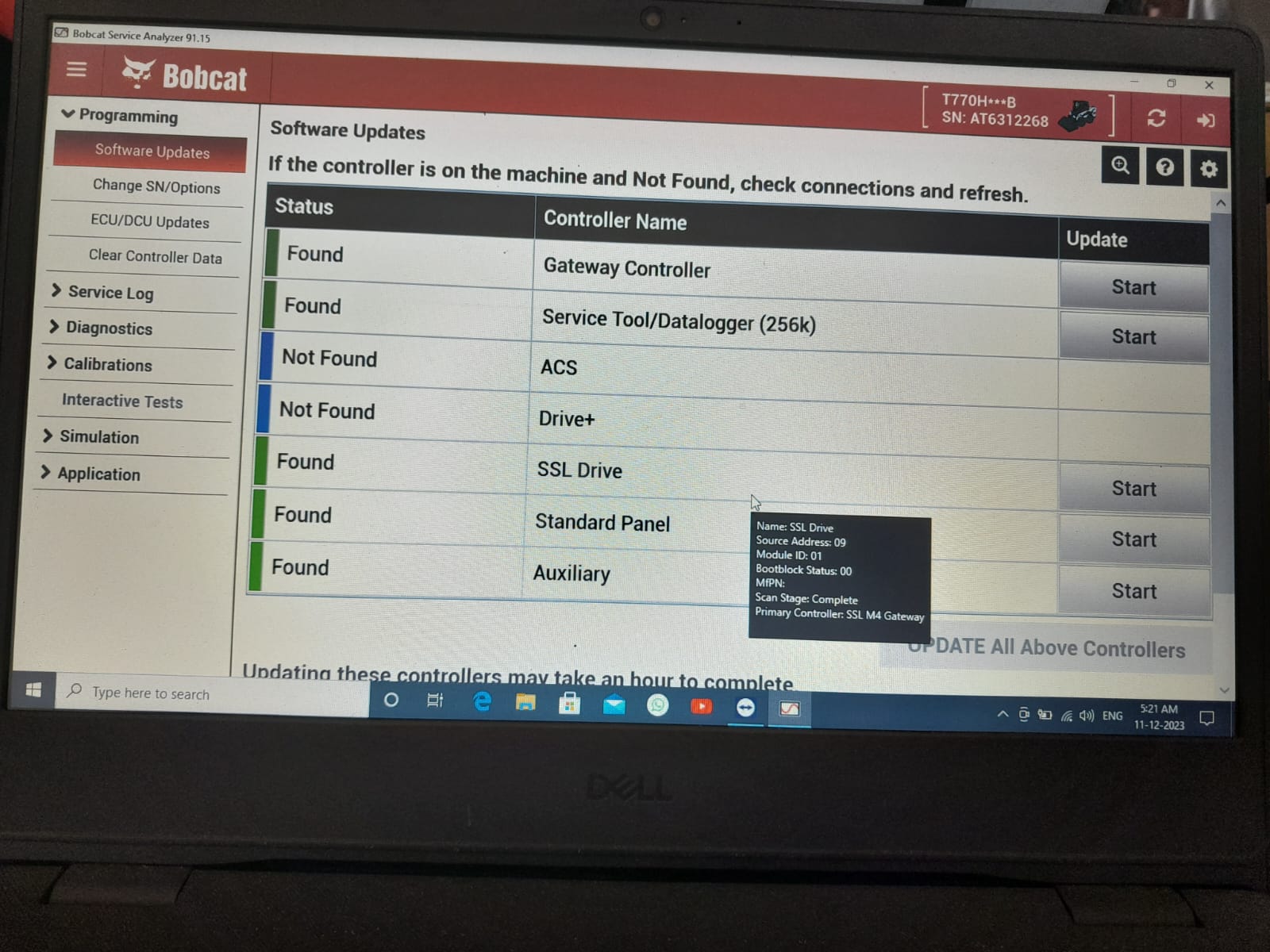

Hello sir,
Once the RH deluxe panel was replaced with a new one the main controller communication error was gone. Now the ACS and Drive+ controller are highlighted in blue. Both was not found. Attached the images of the new error codes. I ordered new ACS and Drive+ controllers.
Will it be fixed after we replace the 2 controllers?
Tell me what you think? What else should we check?
