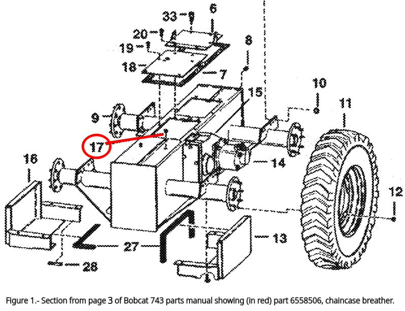

I'd like to do an aggressive pressure washing of the top of chaincase beneath the pump. Is there a vent tube or breather in this area that I'll need to block off, or avoid all together? Thanks in advance.
I'd like to do an aggressive pressure washing of the top of chain box beneath the pump. Is there a vent tube or breather in this area that I'll need to block off, or avoid all together? Thanks in advance.
On my 742b it is under the parking brake pedal.
Curious. The forward access plate is directly beneath the parking brake foot pedal on my 743B. Had it off a few weeks ago when I changed the chaincase lubricant. No vent in the plate or nearby. Page three in the 743 parts manual has a schematic that shows something called a breather, (p/n 6558506) just behind the aft chaincase access plate (Figure 1). However, I cannot find such a thing on my 743B. It is pretty dirty and cruddy in that area. Has anyone run across such a thing on their 743B? I am wondering how protected it would be from pressure washer spray. Thanks in advance.

Anyhow back to the chain case. What oil are we putting in the 743 cases these days? I've been using a cheap engine oil for a number of years now and the chains seem to be in good condition, however always open to suggestions. Try not to apply too much pressure down there, you don't want to blow the seal out on top of the chamber. In the remote areas I use a pump spray bottle. A little slower and a whole less pressure. Done regularly it works well and certainly uses a whole lot less water.
