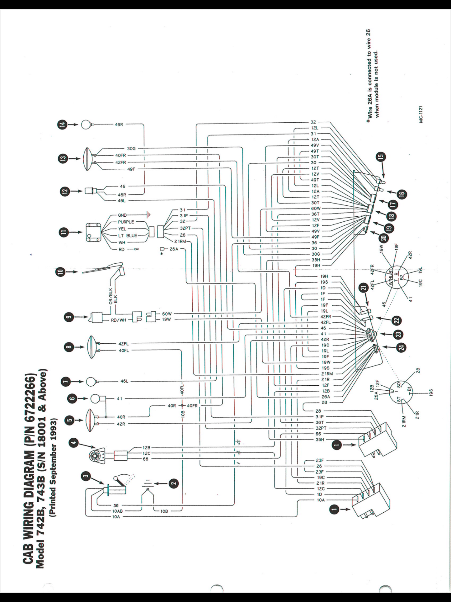

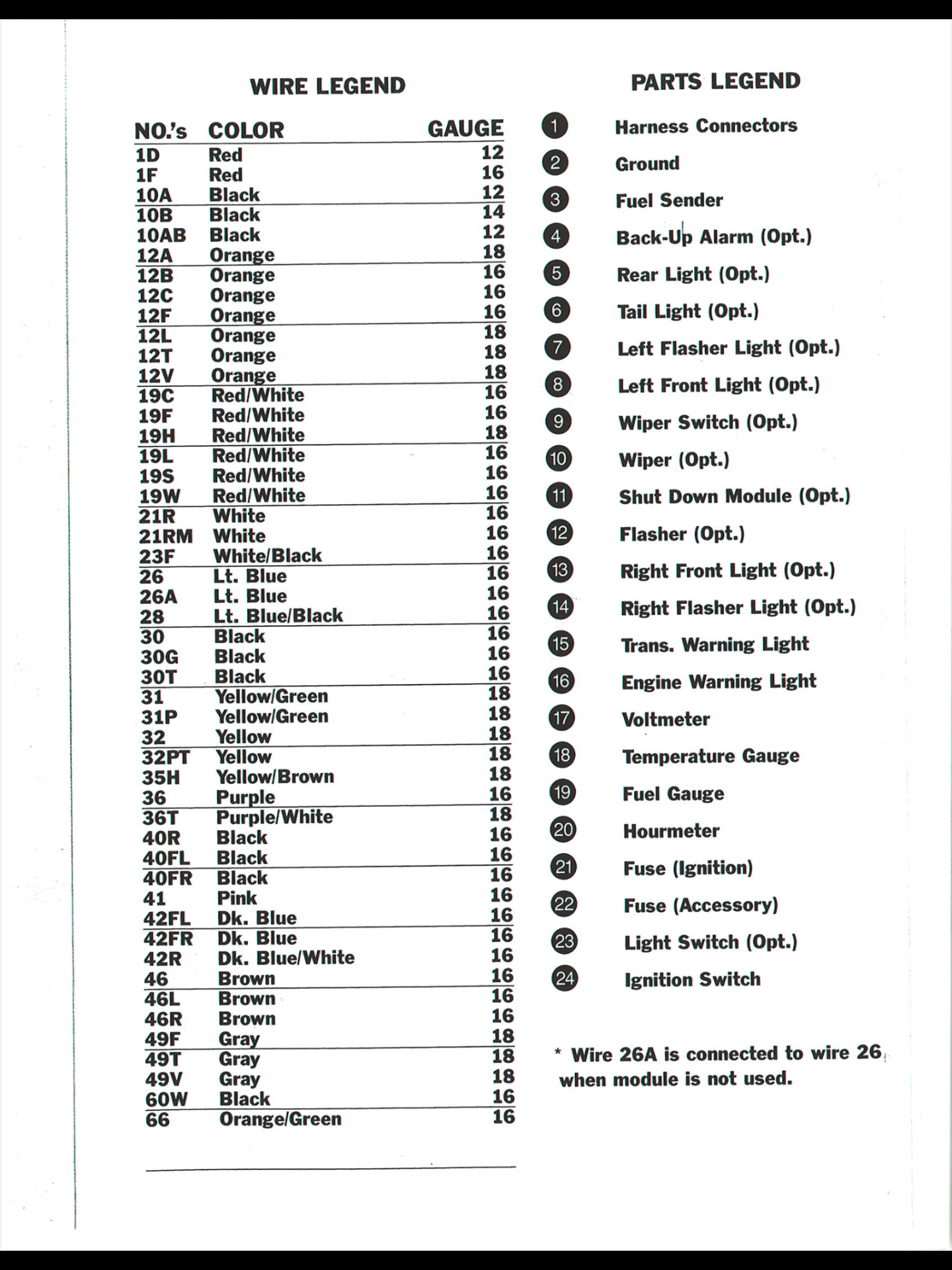

I would advice on which wires in the cab (behind your head )of a Bobcat 743 to get power for my cab heater? I opened up the flexible plastic conduit and there are all sorts of wires and colors, help please.
I have wiring diagrams for 743B’s. I would need your serial number to check if they would work for you or not.
I’m not sure if these will help you or not. Hopefully they will at least give you an idea of what is what.
