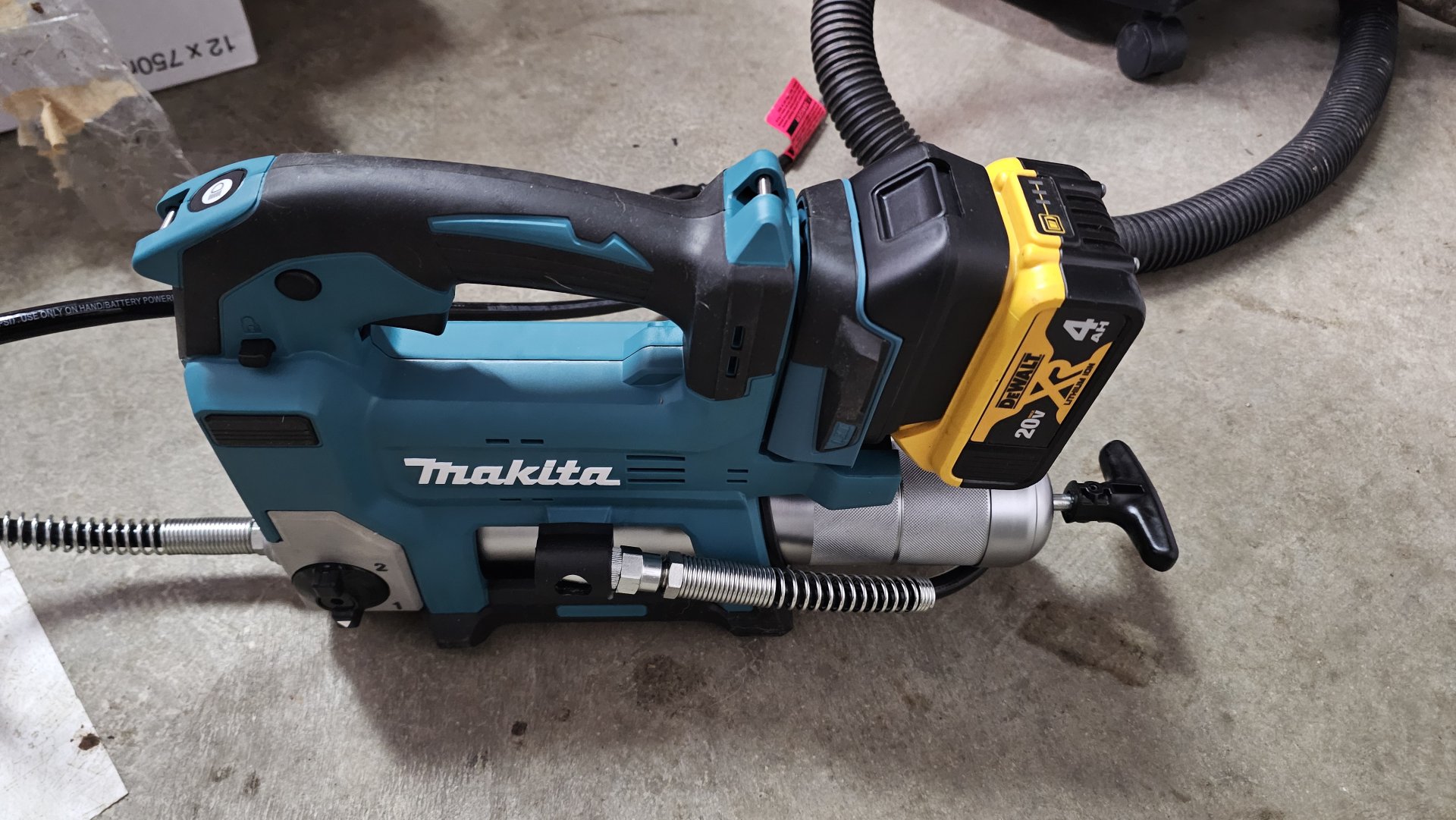

Where has this grease gun been all my life???
Of the 10 grease fittings that would not take grease on my recent purchase of a used skid steer, I got 9 of them to start flowing again, but it took 4-5 hours of work to get them going. I've been working on the last one for 4 days to take grease. The next option was to pull the cylinder and remove the pin. I gave the Ole Makita a shot at it and it put 10,000 psi, you read that right...10,000 psi of pressure and the last one took it like a Las Vegas whore on penny night. You have to get you one of these. It was $160 with no battery or charger (using an adapter for my DeWalt batteries). You will not regret getting one.
Power grease guns are a great product! I have two Dewalts, each has a different type of grease. Do have to be careful around some grease lines not to rupture them, especially in cold weather. Also have to be careful when greasing sealed bearings and U joints not to pump too fast and blow out the seals.
Lever style manual grease guns can make up to 10,000 psi also, but you will really grunt doing so.

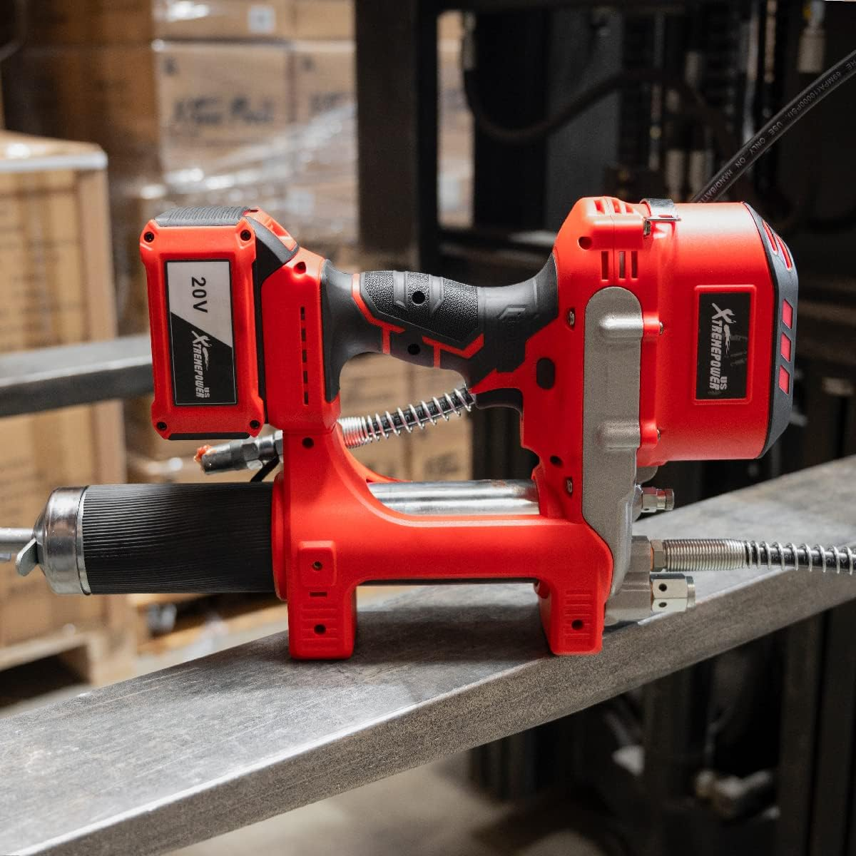

I got a Dewalt clone grease gun a couple years ago. It accepts dewalt battery's. I agree they are a real time saver, I purchased a couple spare cylinders to make changing types of grease easier. Got it on Amazon for $97. I just checked and its now 150. Of course, I still have several lever type they have their place too.

If you have DeWalt, why didn't you just get the DeWalt gun?
