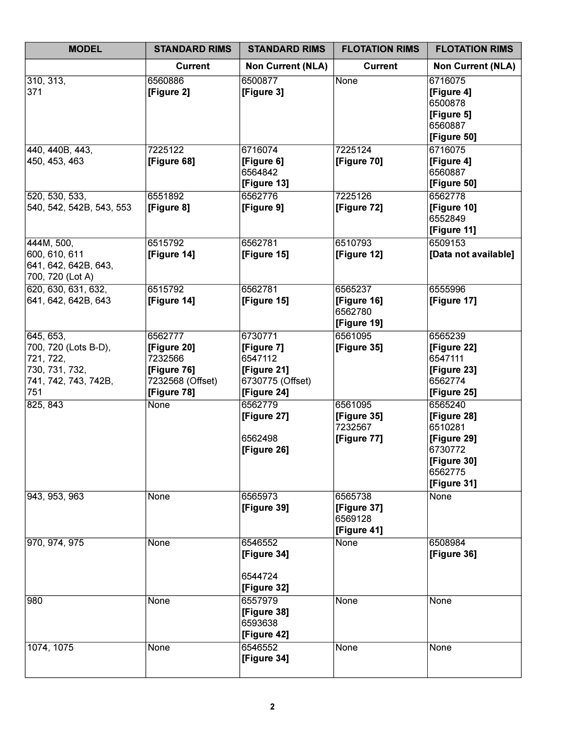

Identify wheel rim BTI197
wateka
May 25, 2022
150
City & State/Province
Texas Hill Country

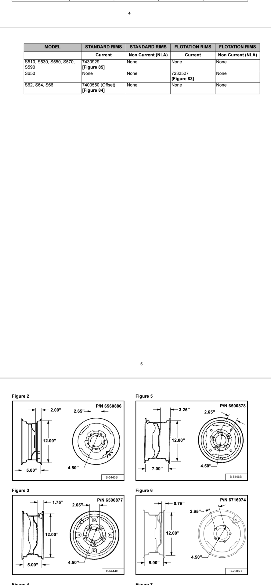

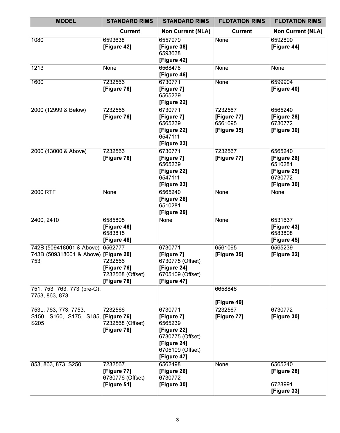

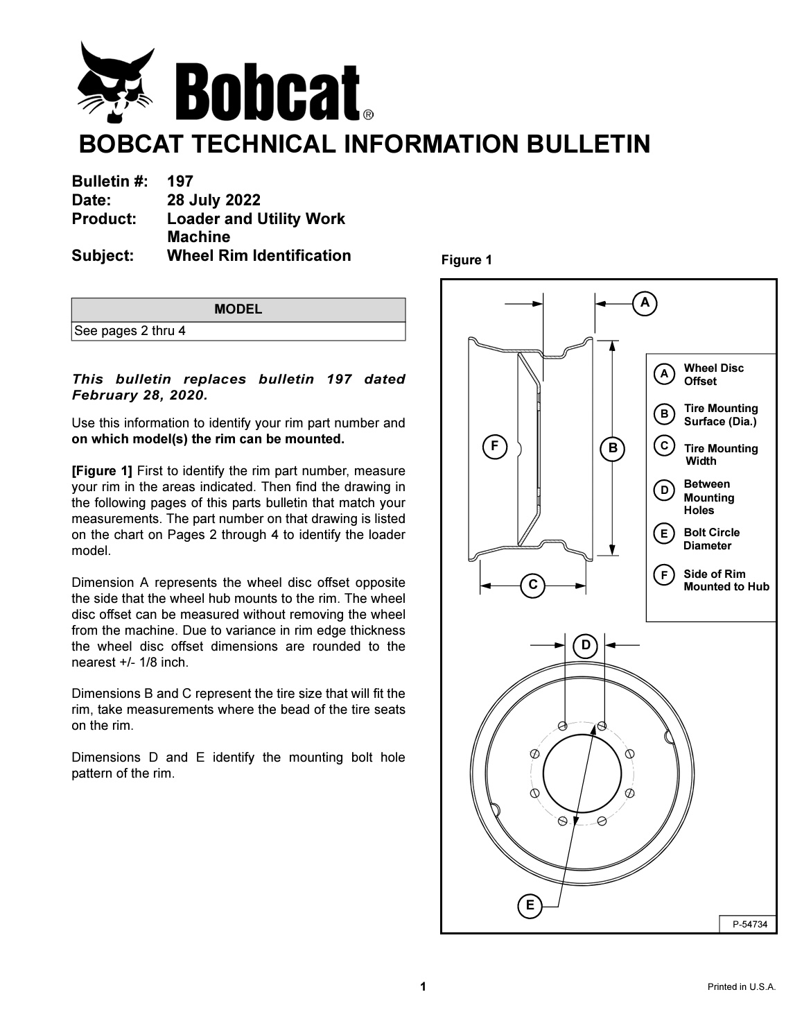

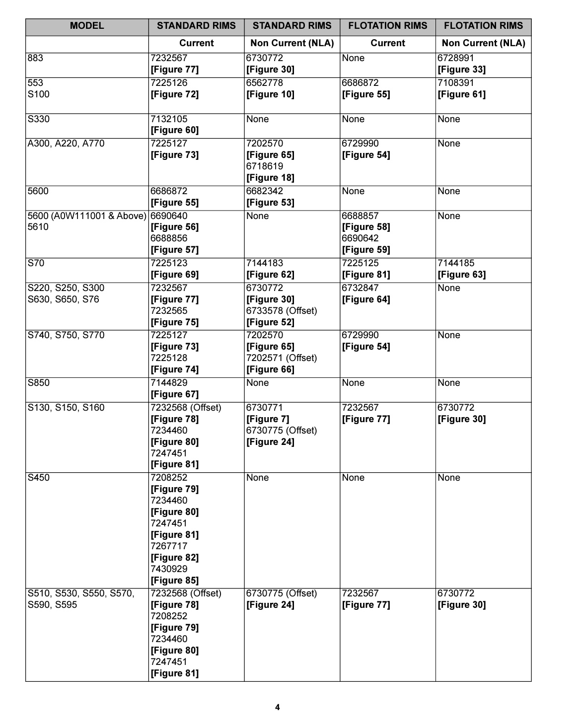

As an owner of a non-current model 853, I have learned the painful lesson that the only thing worse than no Bobcat tires/rims is having any number less than a matched set of 4. I now own an extra 5 wheels/rims with tires, of which only 3 have matching offsets. In trying to buy one wheel/rim to match the other 3, I came across the below attached PDF of Bobcat Technical Information bulletin # BTI 197 that describes the multiple rims made over the years, with measurements.
