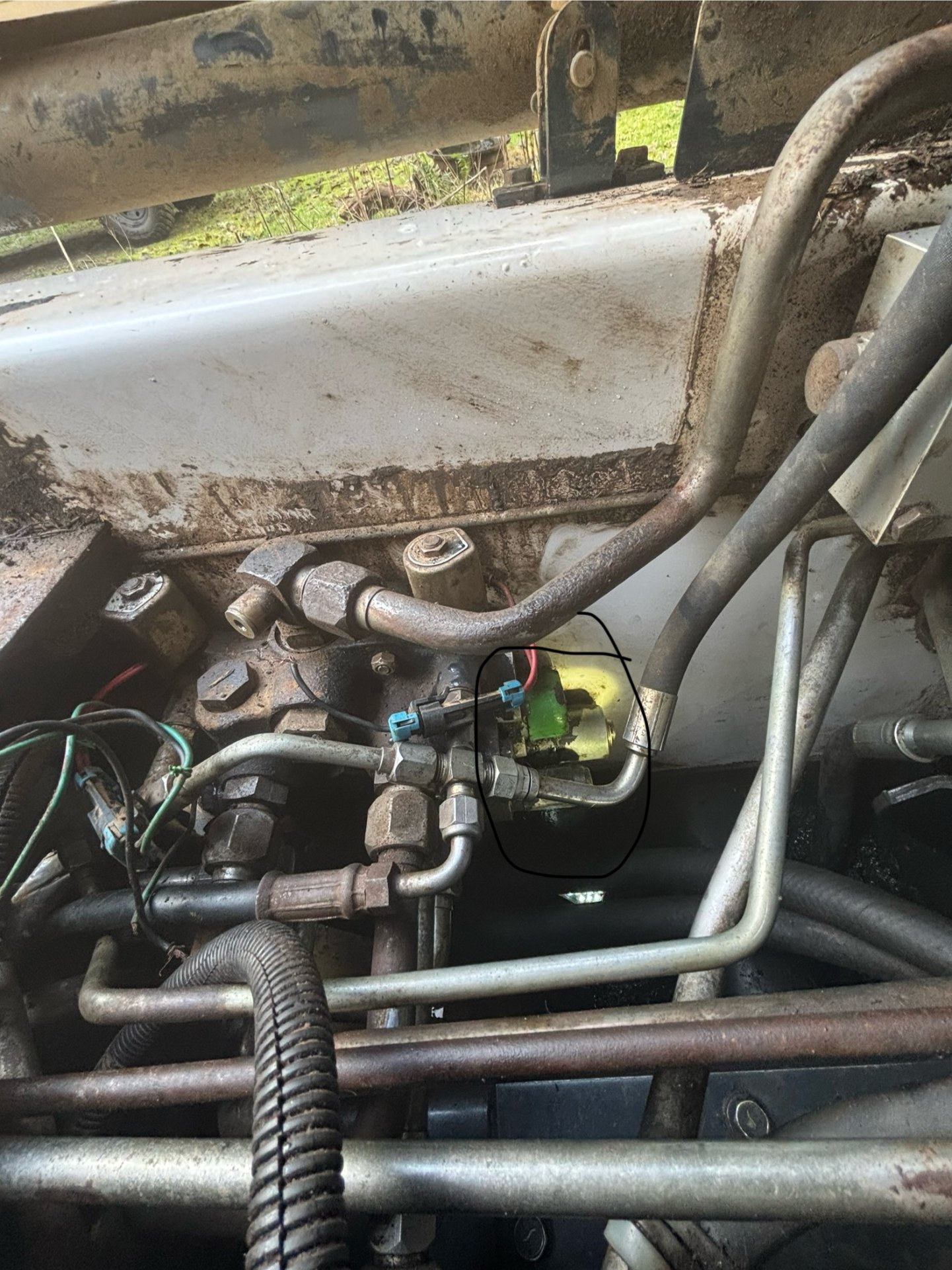

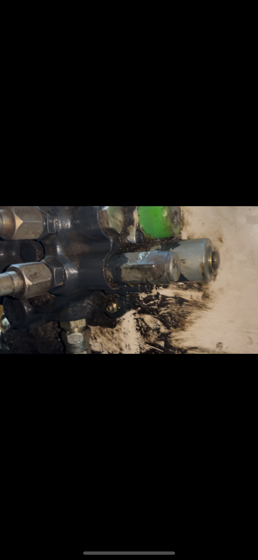

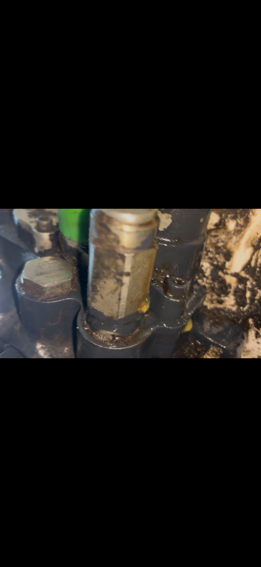

Bobcat 763.
anybody seen a leak from this location on the hydrostatic pump? When looking towards the cab it's on the left up from the drive motor. Need to diagnose this part it's leaking good. See photos.
I just replaced a hose that ties in off the bottom , both my drain case filters and hydraulic oil filter.

Looks to be one of the relief valves on the control valve unit (main relief it appears). It's just a couple of O-rings and a back up washer to replace. Not sure if it's a usual item to leak as it tends to be the seals on the control valves themselves (I just replaced mine).
Thanks for the reply appreciate that info, looking up the difficulty of that o -ring replacement. Appears to be two separate leaks.
