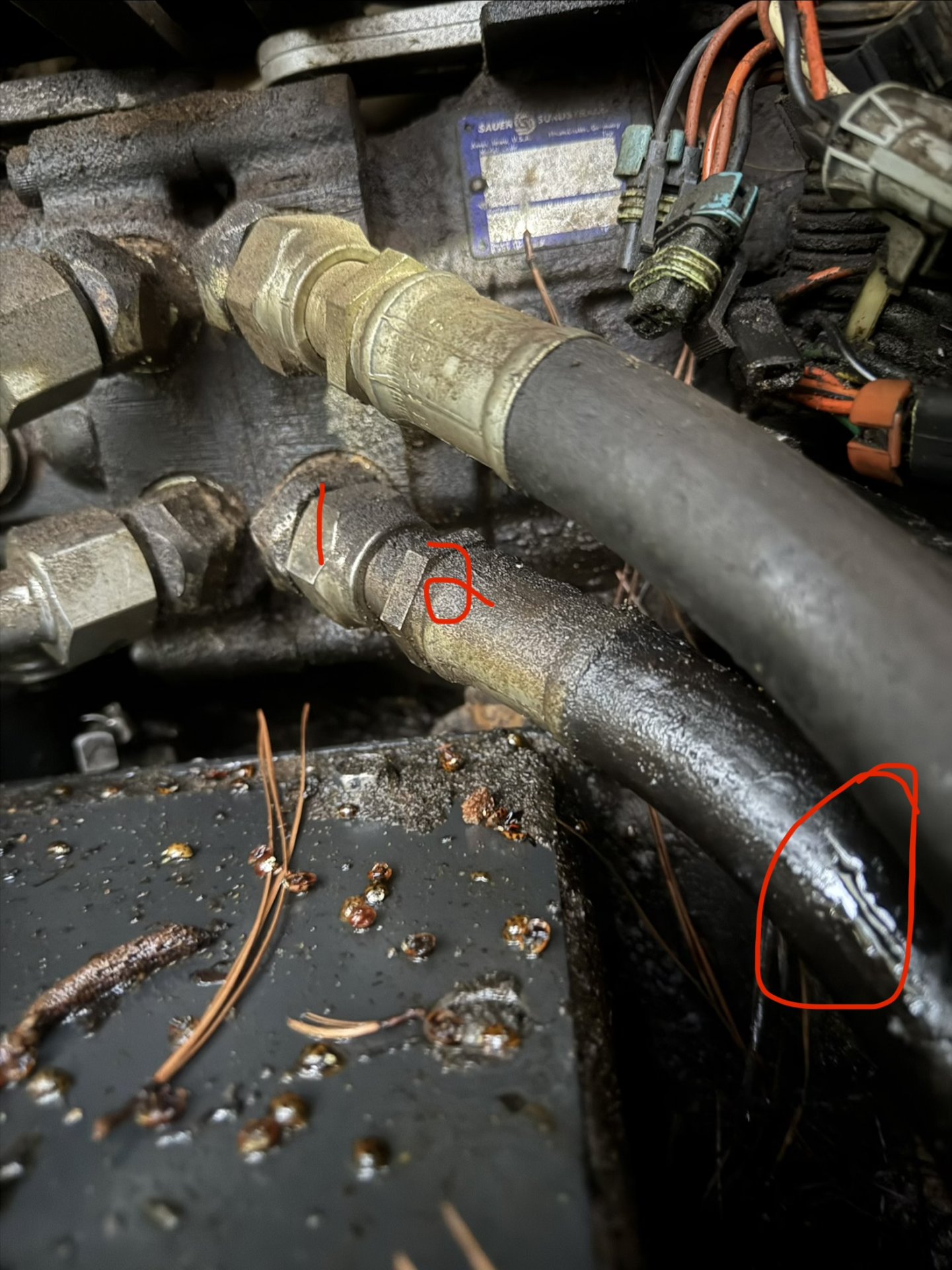

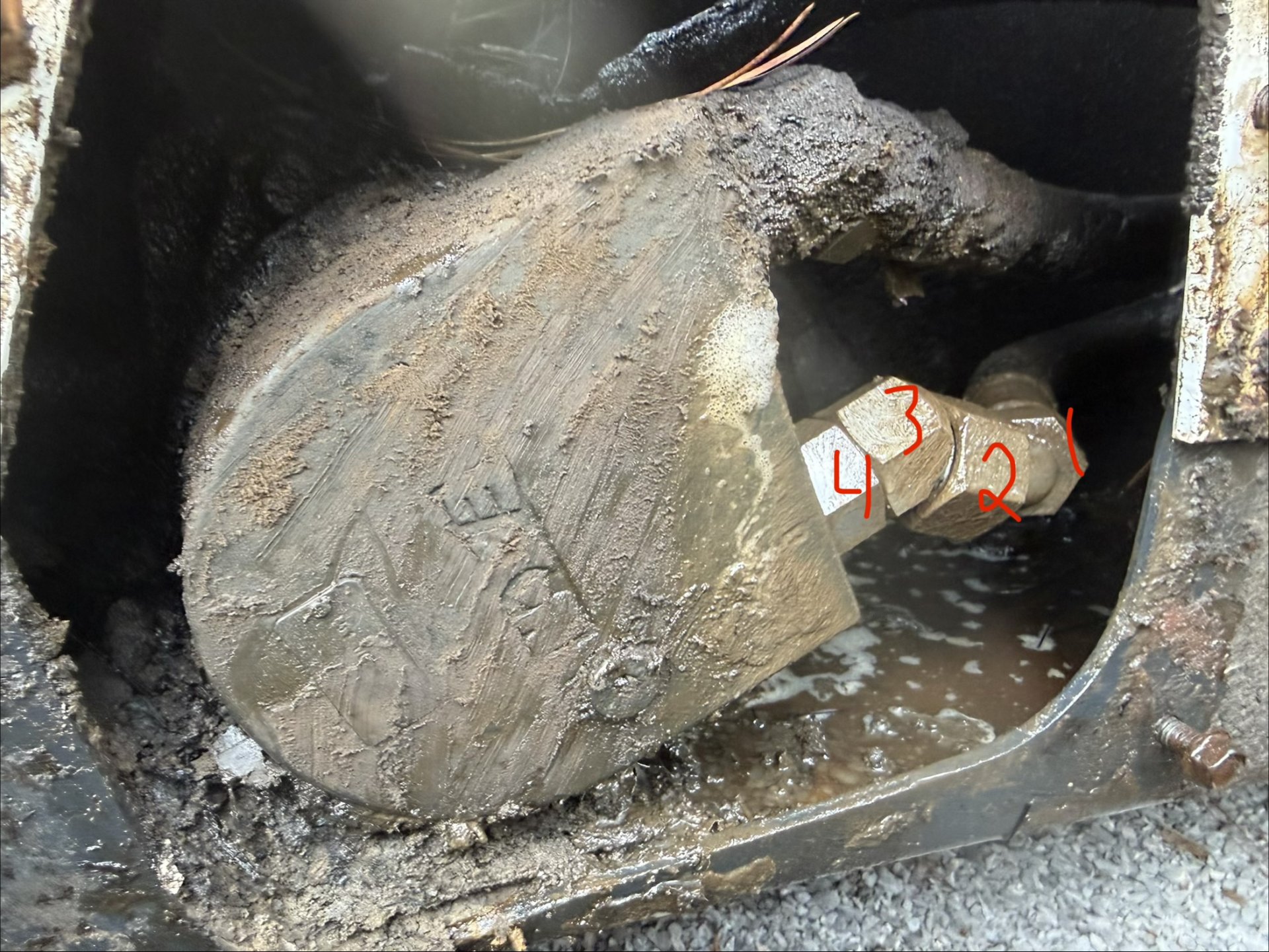

Seeking advice on replacement of leaking Hydraulic hose under the cab(see attached photos). I’ll have a replacement hose made, but at which joint should I remove leaking hose(leak spot circled)? In first photo 1 or 2 mark? In second photo at 1, 2, 3 or 4?
Any other advise or steps I should do while attempting this? Something I read online mentioned changing the seals. Hope this is a straightforward!

First of all clean everything before you remove the hose. You do not want to introduce debris into the sytem.
You should have some caps and plugs on hand to stop excess loss of fluid and also to keep debris out.
In the first photo the hose removes at point number 1. Point number 2 is for keeping the hose from twisting as you loosen/tighten the hose.
In the second photo, it is a little hard to tell, it looks like you would remove it at point 2 and hold the hose from spinning at point 1. Points 3 and 4 just appear to be fitting to accommodate the angle that the hose meets the motor.
