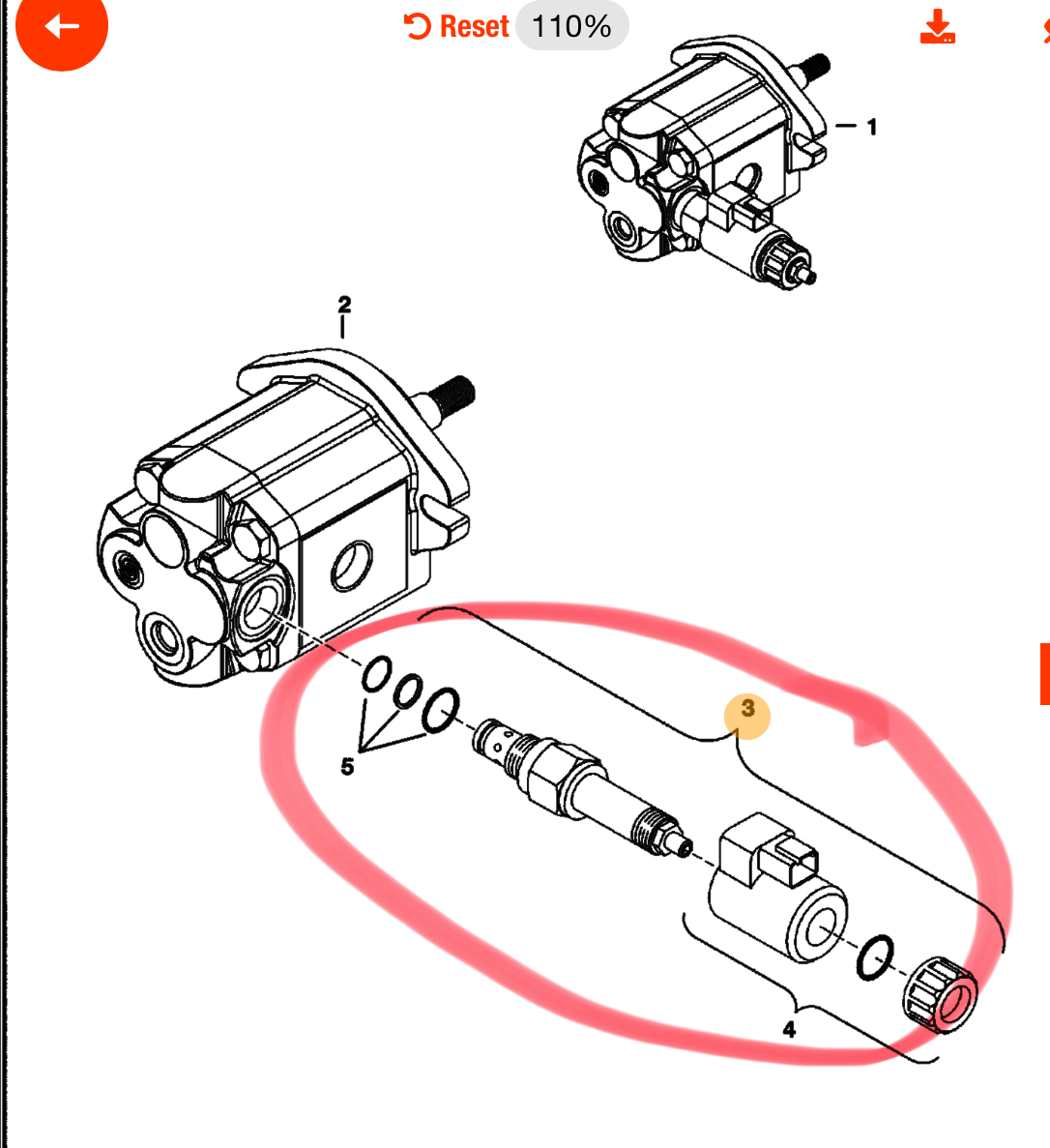

The fan motors have a solenoid valve that bypasses oil until they are closed. Yours may be stuck open, or have a bad coil that will not energize the solenoid.
    359.8 KB
