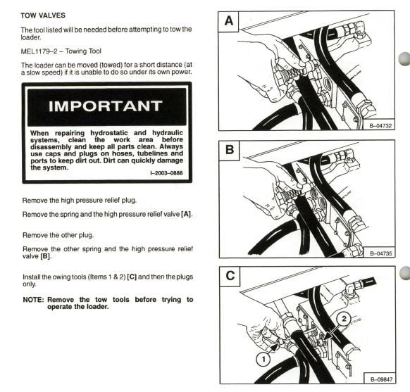

<blockquote data-quote="68camaro" data-source="post: 47058" data-attributes="member: 4933"><p>Ok it worked! This will be probably the only time I'll be able to offer info rather than asking for it... One of the high pressure valve thingies didn't want to come out so I rocked the machine back and forth and it sort of poped it out. You should have someone else ready themselves to grab it when it pops it's little head out. Watch your feet...tee hee. I didn't have the tool but someone told me to use a welding rod etc. I tried something similar to that size and diameter. I made two about 10" long. Just stick it in until you feel a valve inside move back and forth and sort of make a cool ppffting sound. I had to make a little wedge to place behind the rod to keep it in place but it worked. Get them both lodged in place and it should free wheel. Be sure to have a small animal or something to use as a wheel chock because it will want to roll. It'll spits fluid out of the holes when you move it but that's a small issue. Thanks again!</p></blockquote><p></p>
