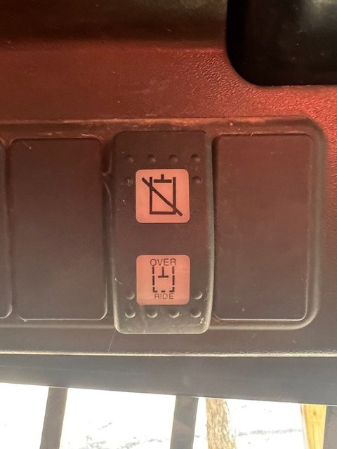

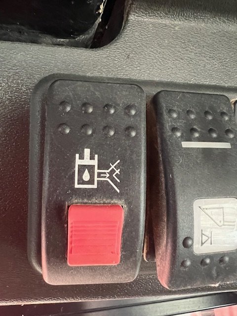

Thanks for the help. These are two buttons I'm not sure what they do. If this has nothing to do with lowering arms without power, then the back port window is the only way out, which doesn't seem easy to climb out of but possible. Can anyone explain these two switches on the inside of the cab?
First photo is the hydraulic lockout and override switch. Lockout button "locks out" the hydraulics. Manual says to use this when roading the machine to prevent accidental movements. Override lets you use aux hydraulics with armrest raised. You need the continuous flow button enabled for it to work.
The switch with the red button is aux hydraulics circuit pressure release.
I find it handy to make the quick connects easier to come off when changing attachments, when I have just been using them.
If the machine was running, turn key off, then on, park brake OFF, arm rest LOWERED, hold for 4 seconds. Should hear a couple clicks behind the beeping. Someone must be in seat with armrest down for it to work.
