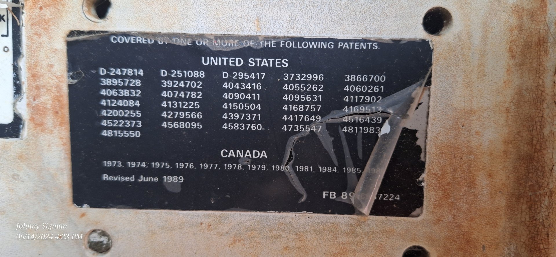

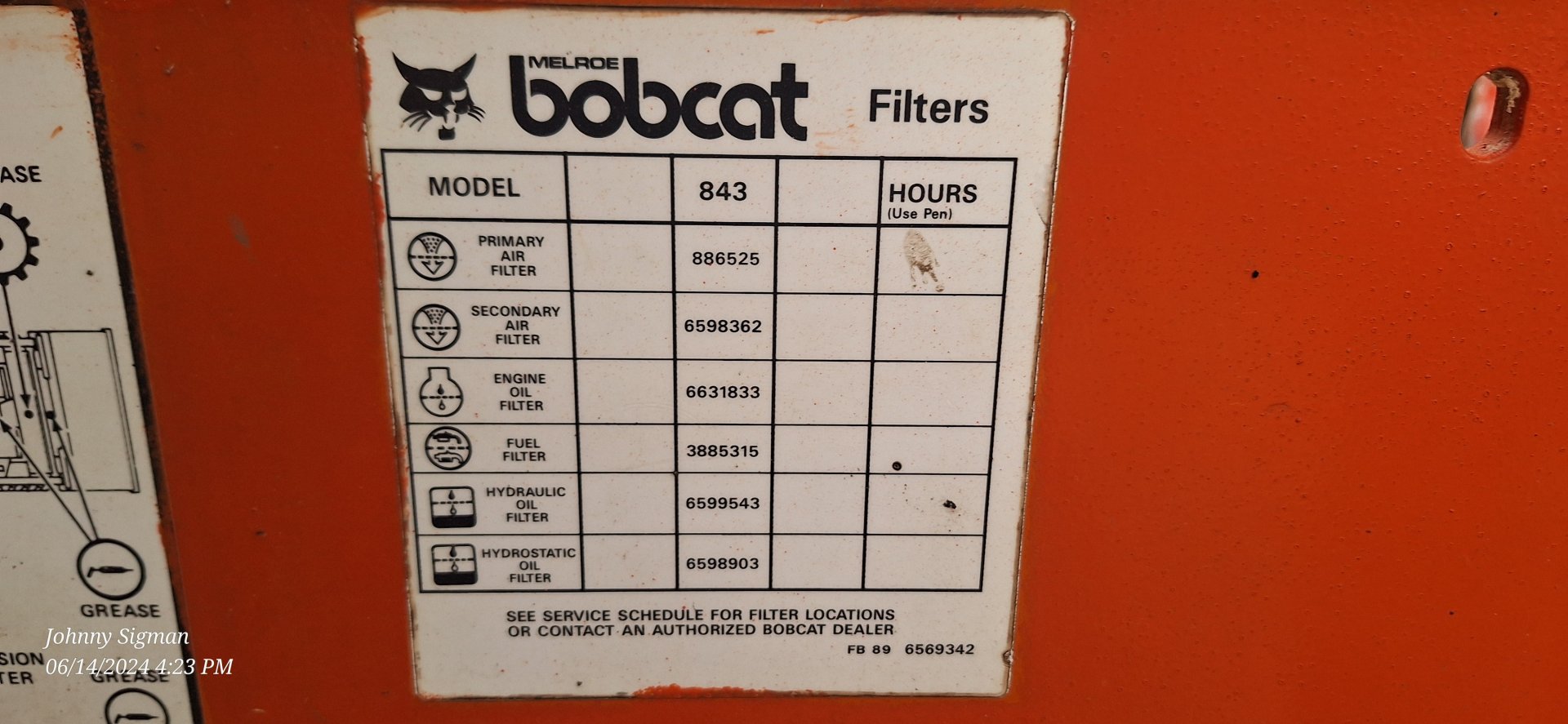

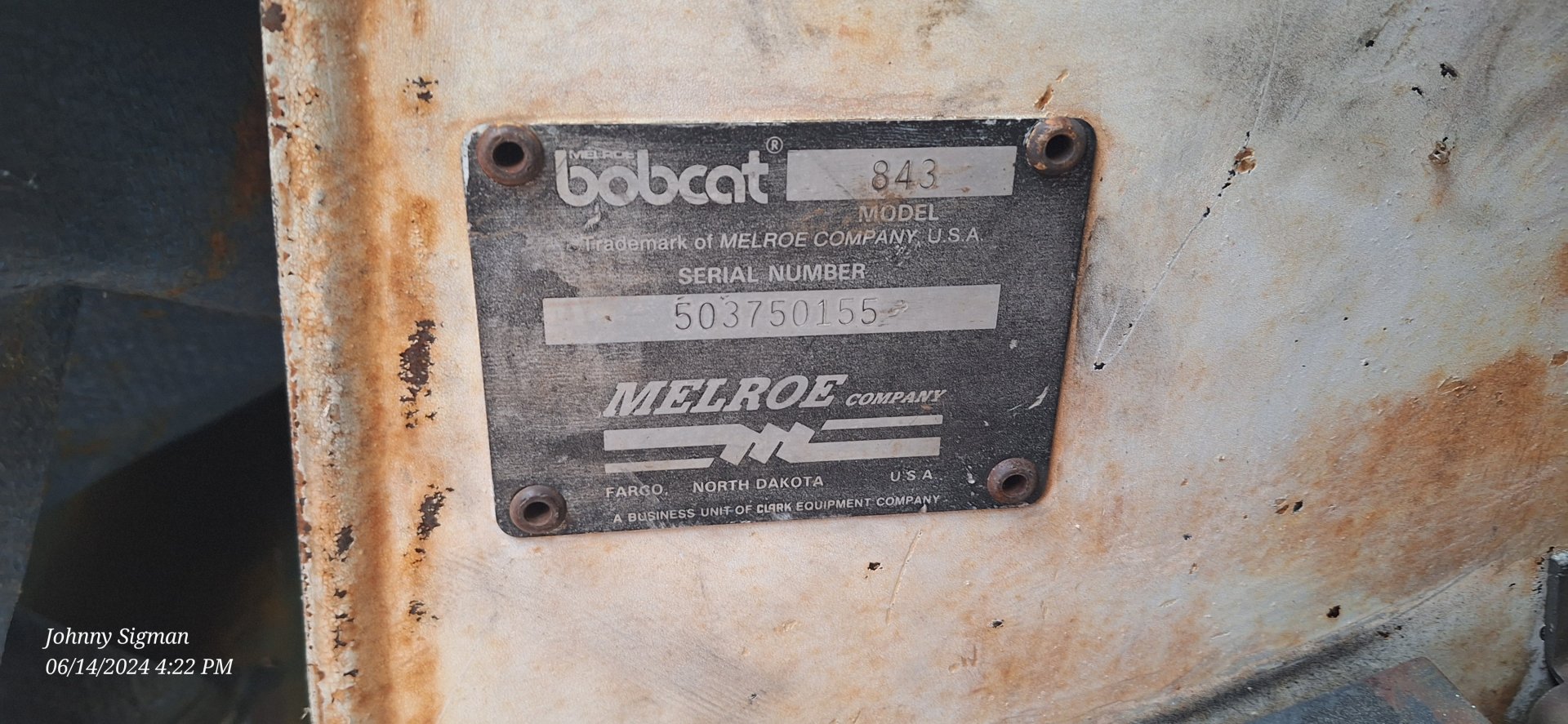

Sorry for the delay, you kno0w how life gets lol but attached are the pics i took of the info plates. iI'll try and get good pics of the machine soon though. I currently have it in a car shelter tent and well needless to say i got some **** around it i need to move to get to it better and a 600 pound lathe sitting in front of it.... lol you know how it can be when it comes to storage

There is a used 843 service manual on eBay today. The service manual has hydraulic routing and electrical schematics. I could not have brought my 743 to life without a service manual.
