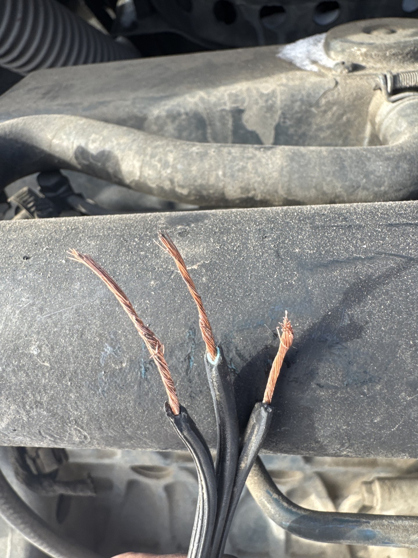

Block heater is the way to go. I have a block heater installed but the plug is ripped off.. I'm trying to re wire it but unsure which wire of the three is power, negative, ground.. does anyone have a wiring diagram or know a way to figure out which wire is which?
I also am a electrician
You will notice on any 120 volt power cord that is permantly attached, as in your block
heater cord or radio cord, coffee maker cord ect. that one side of cord has a ribbed edge.
this is to identify the nuetral wire which will be attached to the wider steel prong on the
male plug end. The opposite side will be power wire and the center wire if applicable will
be the ground wire. Double insulated tools and such may not have a ground wire.
I hope this helps.
RedneckMike

Thanks for your reply, after doing some more digging online (after I posted) I found exactly what you described, learned something new yesterday. Wired it up and plugged it in, good as new. Thanks!
