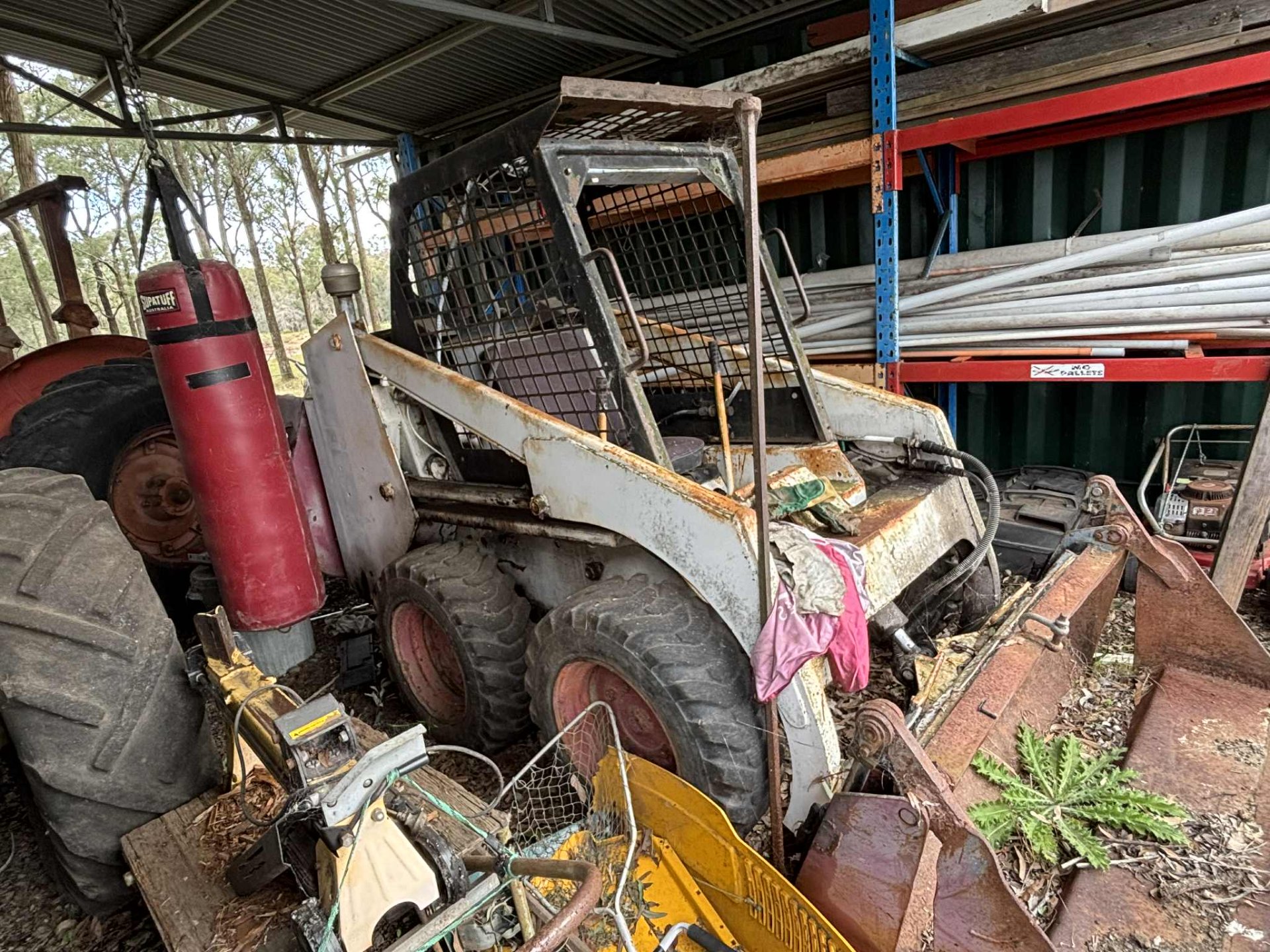

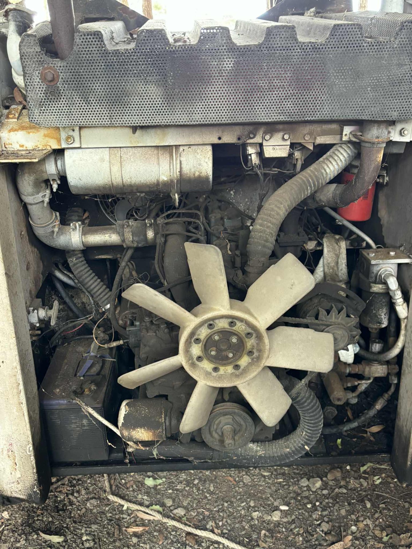

Hello all, wondering if you can help me Identify this Bobcat.
I can find no tags in the normal places.

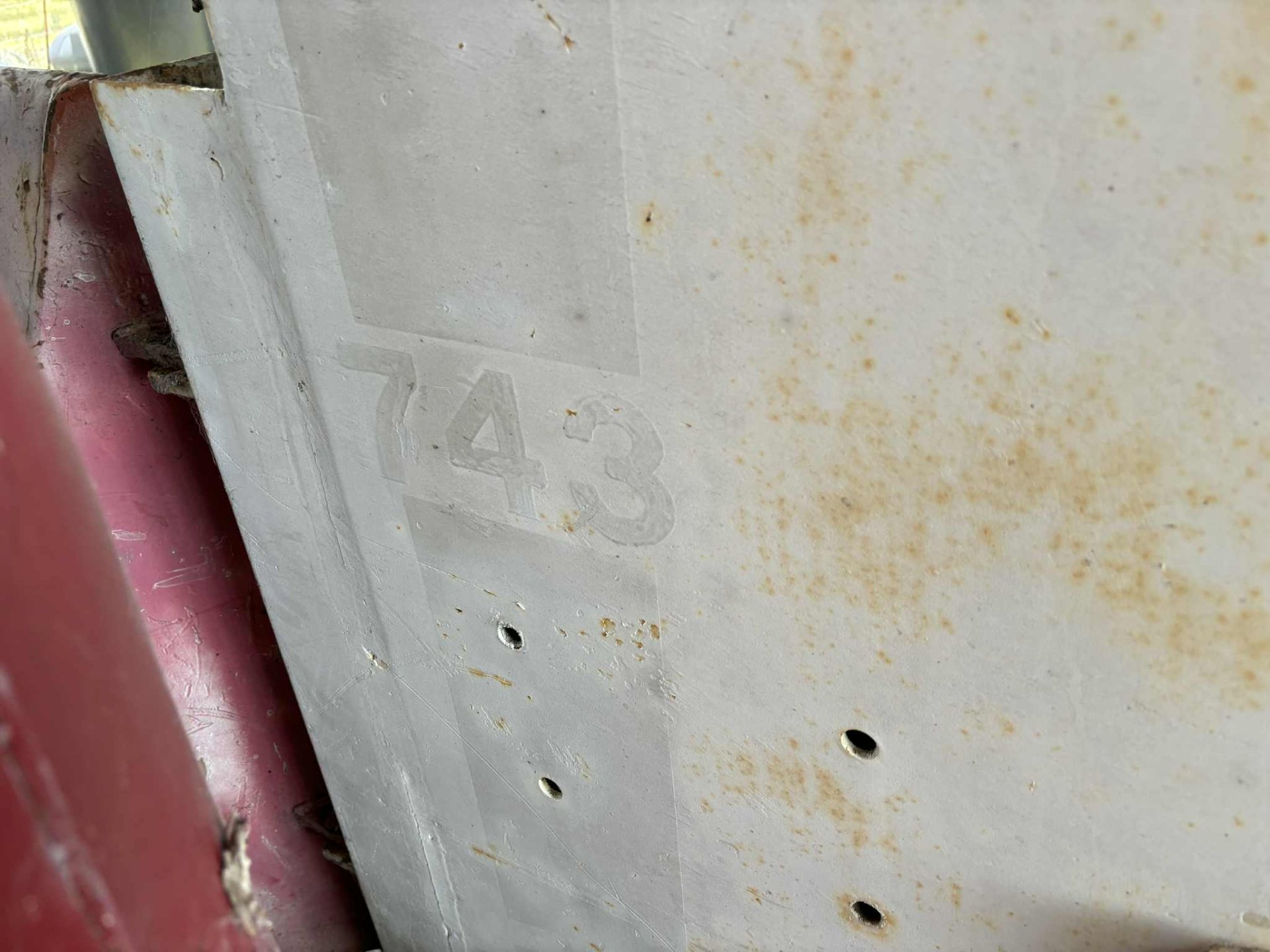

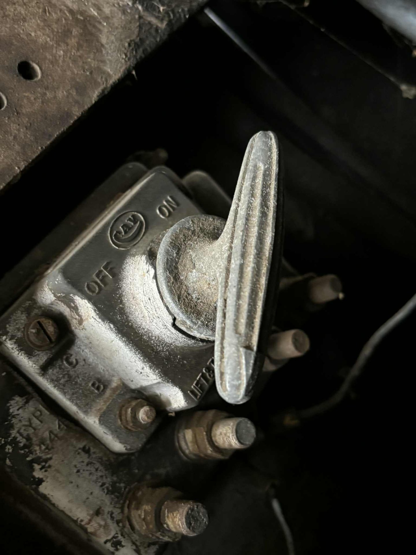

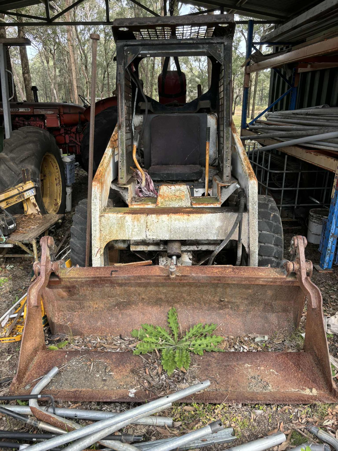

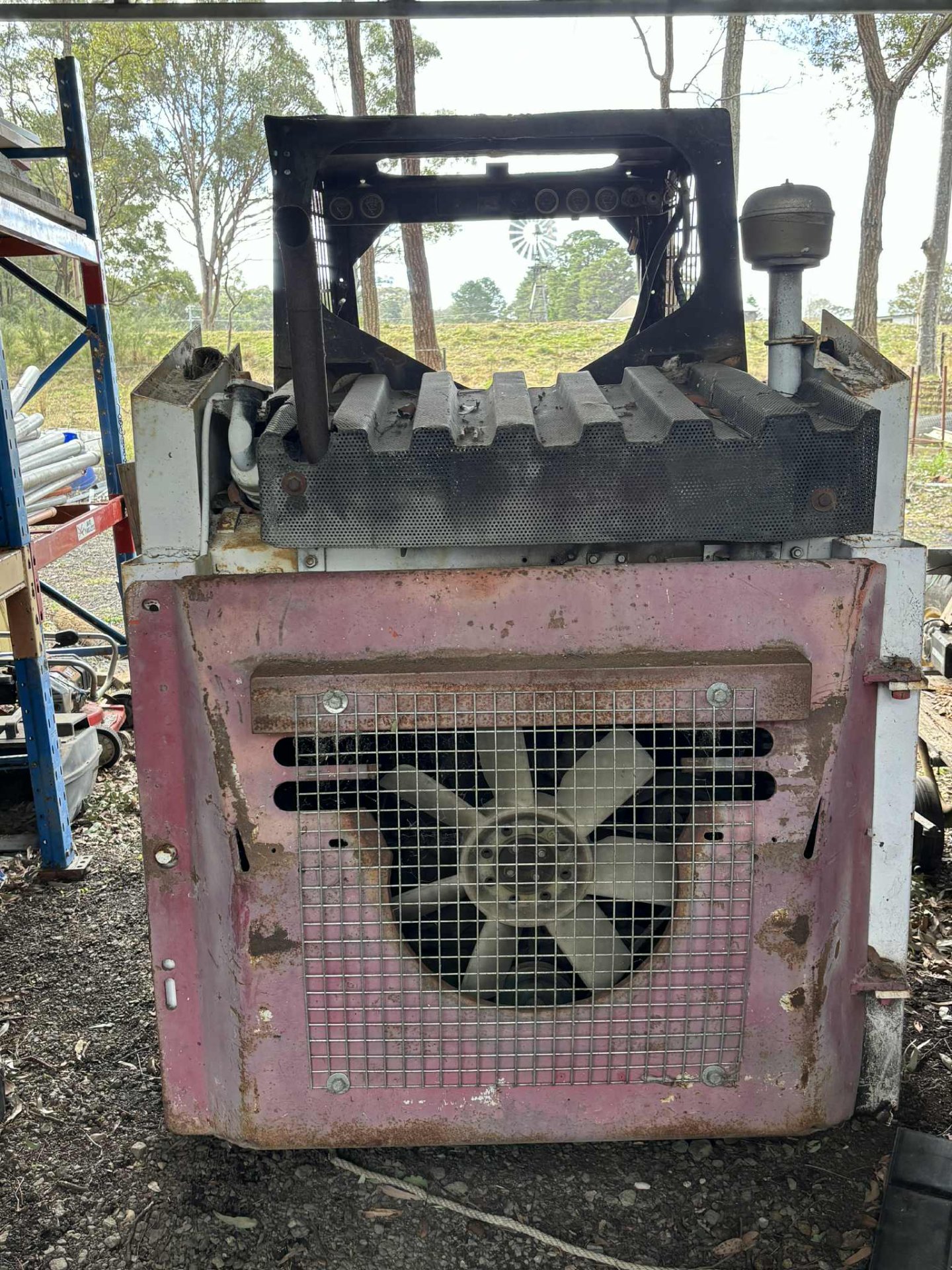

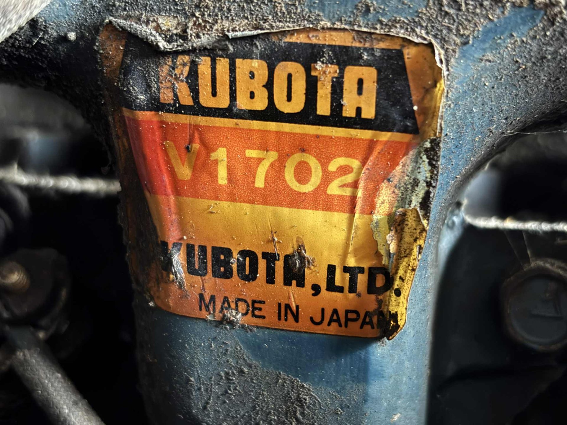

It is an early "inheritance" from my uncle, There is what appears to be a worn or painted over 743 on the sides and the Kubota Engine model V1702 seems right, but it has no Seat Safety Bar, and the layout of the engine bay seems different from what I have seen online for the 743, The air cleaner is arranged differently , it has a cooling fan, Battery is on the left, coolant cap is high on the left outside the bay and there is what appears to be a battery isolator above the battery on the left.
The back door seems to have been hacked to accommodate the fan.
It has some issues and I figured the best place to start would be to correctly identify it.
Thanks for your help.

An interesting setup with the added decapitation fan installation on the front of the engine. 🤔🤦‍♂️
The 743 has a horizontal drum style fan installed on the back of the engine between it and the hydrostatic pumps. The fan is fully enclosed in a shroud (drawing air from the front) that then directs air flow to the underside of the radiator and oil cooler and up through the grill. I can only assume that the machine had an over heating issue and the extra fan was installed to increase air flow over the engine to where the OEM fan picks it up before directing it up to the radiator, that’s assuming that the OEM arrangement is still installed/working. 🤷‍♂️
