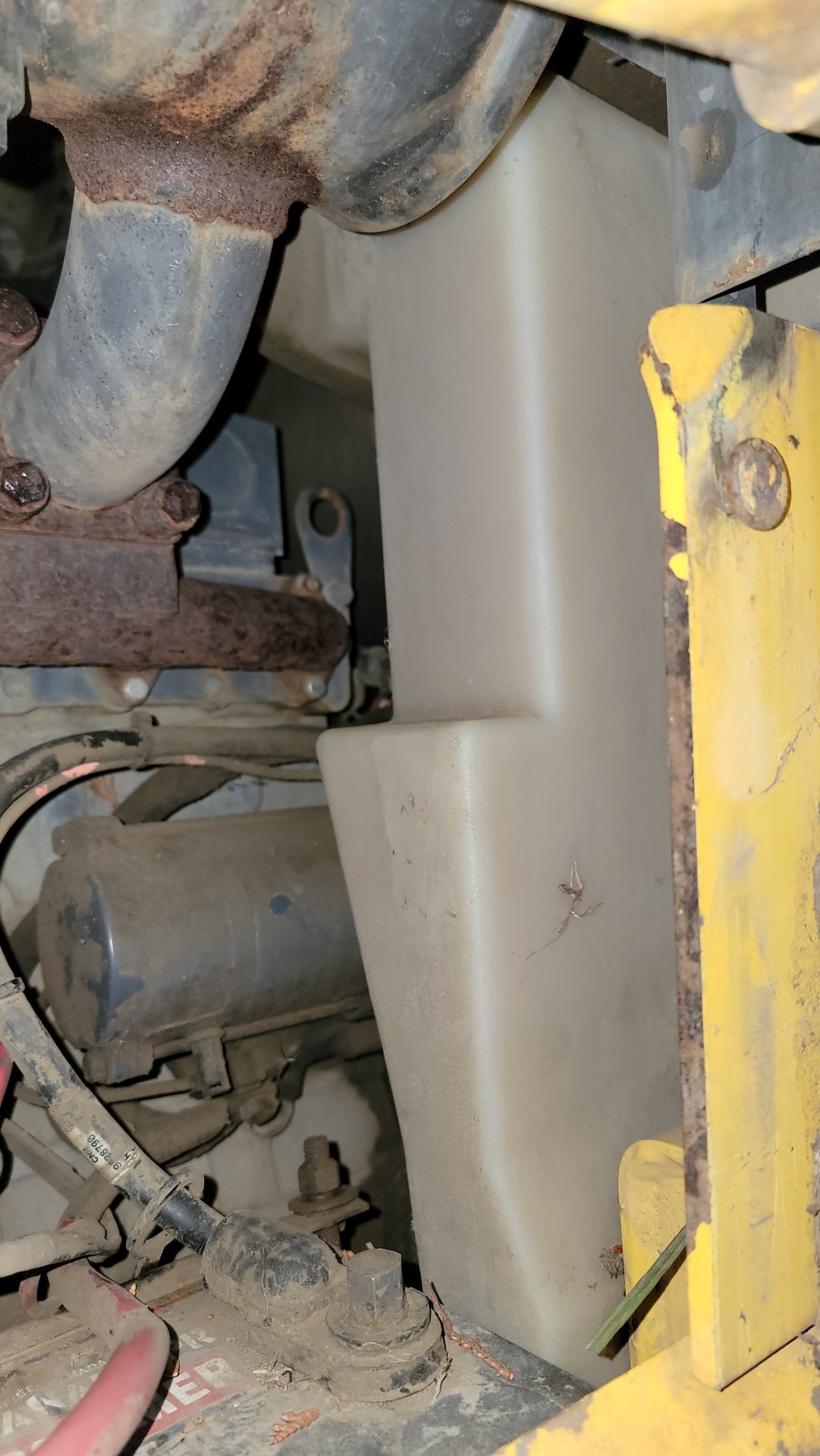

I just bought a NH 2005 ls150 and I have some problems:
1. can't find the hydraulic fluid check level and I believe i am very low. don't want to put any as I don't want to mix oil. also how would one go about draining oil to replace as its never been done and I am at 2400 hours.

rear or side should be a sight glass or the reservoir u could always stick i wire in it
and see how much u have
so if I can't find a sight glass is there a danger of over filling the machine? I am assuming there should be oil that you can see through the side of the plastic. maybe halfway?
when u open rear door on your left u should see a oil or fuel filter behind that u will se a sight glass
about three inches big or fill it and leave 12 inches out of container is easy way make sure the boom is downnn

I don't have your model, but on many like era (and older) NH machines, there is not dip stick for MAIN hydraulic fluid/oil reservoir tank, ( again many use 10w-30 OIL, and NOT use hydraulic fluid at all in them, so you don't want to be mixing oil and hyrdaulic fluids if possible< )
but the way to check level is on the side of the plastic tank there are lines to show where to fill up too,

Ah, I see what you mean! just bought a repair manual and I'll be going through it in depth. it does say 10w30 for the motor and fluid. they are separate holding chambers and filters for them. thats why I was confused on the types. Do you think buying non OEM NH filters and oil at Lordco Or Nappa is a problem? I am in a small town in BC Canada and no NH dealers near me. I would assume any filter that fits and has the same micron would be fine. just bringing the old one in and getting a replacement... Same with oil brand?
