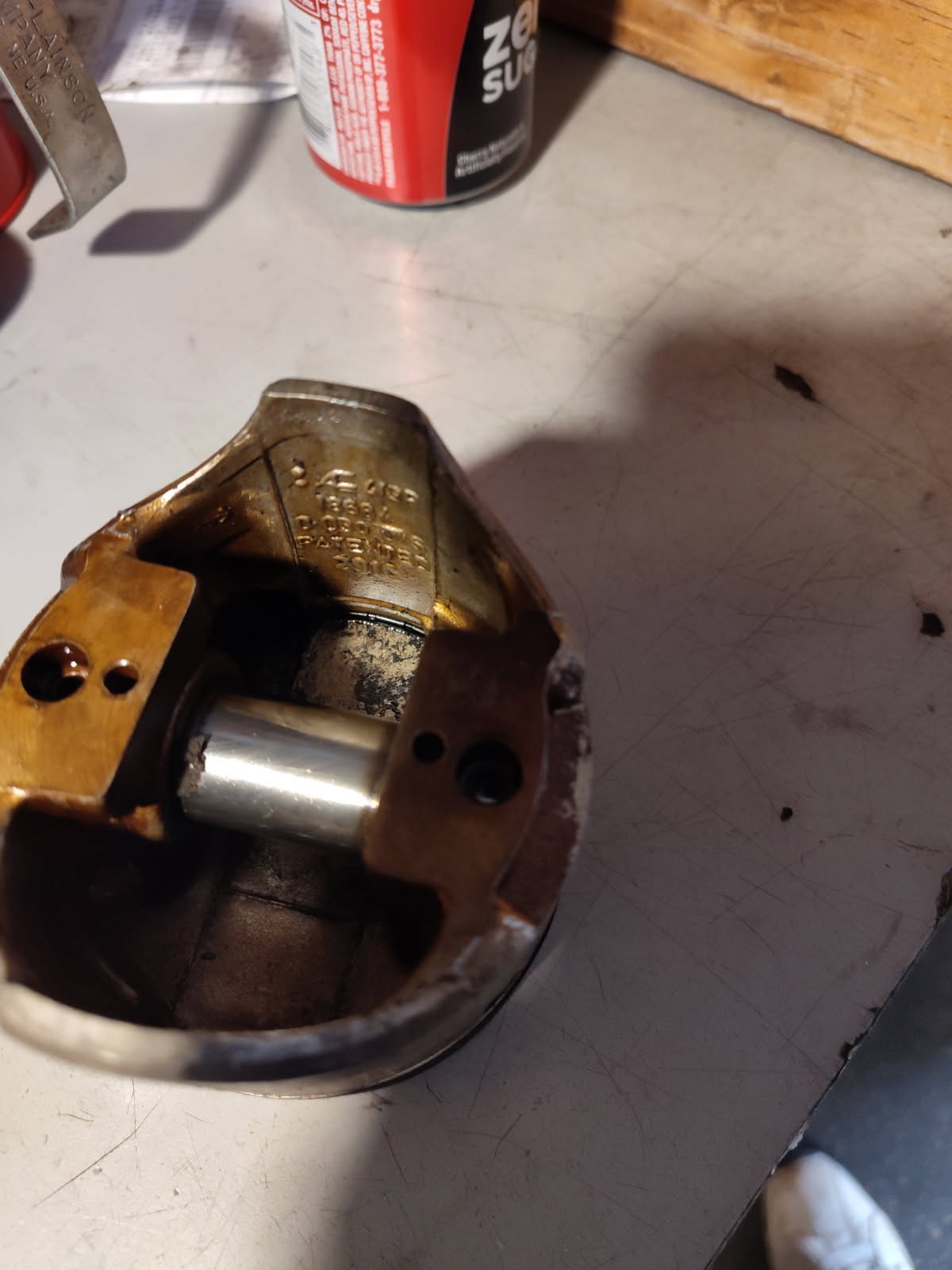

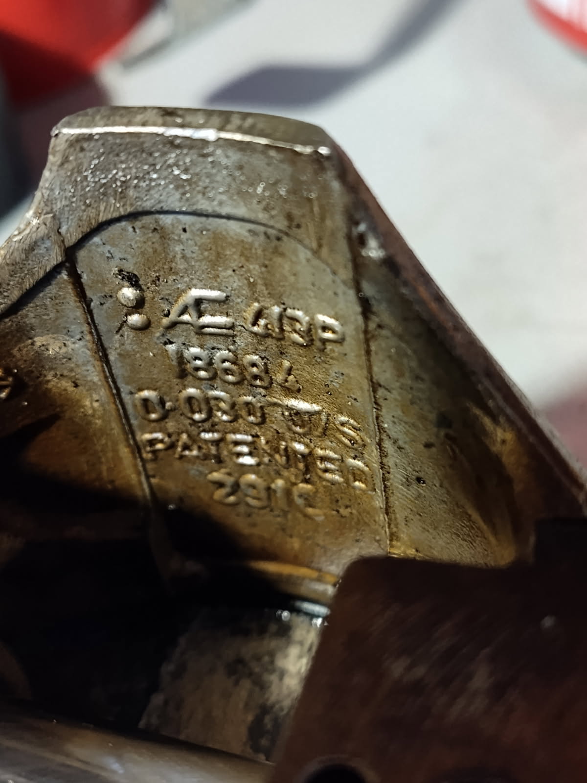

I can't find these pistons. It's a late 70's bobcat 722 with a 711m Ford 1.6 engine. It has a flat head so the dishes pistons have valve reliefs cut in them. Piston is an AE 18684. +.030" oversized.
I bought 18649 +.030 pistons from jensales but the crowns are much smaller and they will clatter.

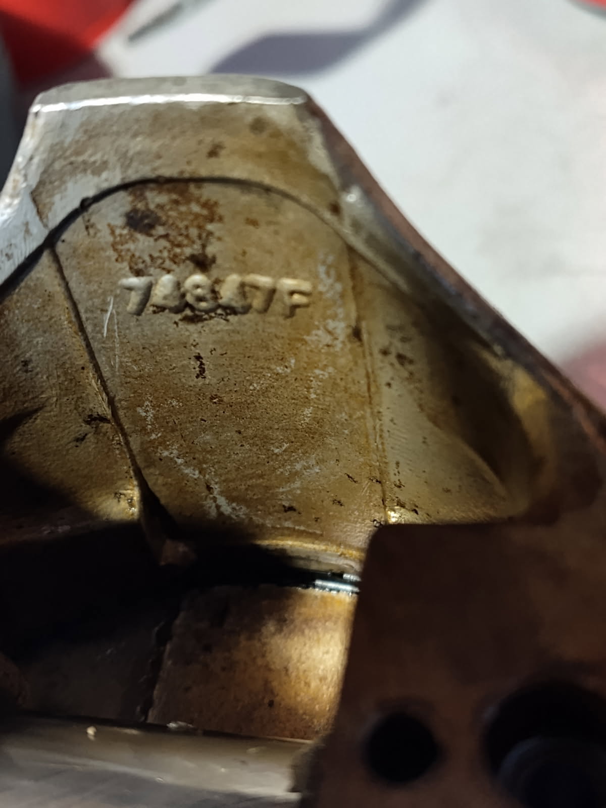

Solved: the stamped information on the inside of the piston is incorrect. After removing the carbon the actual piston number on top is 18649 .060. that is why the 18684 .030 had too much piston to wall clearance.
