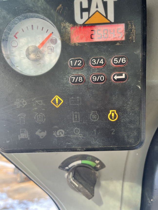

Yesterday I had to move my 279D track loader (2014 year but new to me-bought used) yesterday, and in very cold weather it started fine. I let it run for a few minutes, lifted the bucket and reversed out of my barn and drove off to use the skidsteer to jump a vehicle that was stranded. It was so cold that the red plastic cover over the positive battery lead was frozen and to get to the battery post I ended up prying off the lead wire to expose the post. then I had to use warm water to free the plastic cover from the lead wire. Then I reattached the + wire to the post. I hooked up the jumper cables and took care of the stranded car. I removed the jumper cables and went to drive away. The engine started fine, but to my surprise the bucket controls were non functional and it is a mess of a problem. I do not know the meaning of the warning lights that showed up in the image below.
PLEASE. what could. be happening and what is the fix?

(meaning of warning lights above, please.)

It created some kind of problem and hopefully not a big one. Warning Lights: The yellow exclamation point icon shows next to the battery. The square top circle icon is next to an electrical coil image, and I do not know what that means.
What do you suggest?
The square with the exclamation point is just a general warning telling the operator that something is wrong.
The round thing with the flat top represents an engine warning. The exclamation means malfunction/failure.
These are both just general warnings saying something is wrong. You need to see if your machine has a way of showing codes. Otherwise you’ll have to do a diagnoses until you find the problem.
