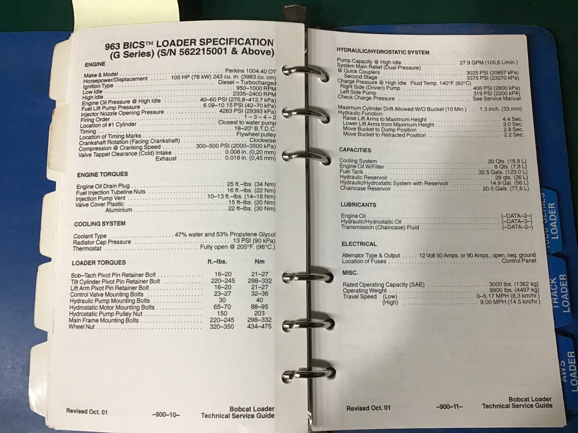

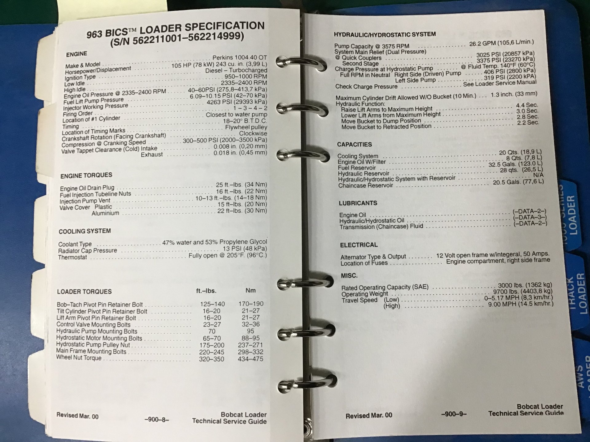

You should be getting 300-500 PSI compression @cranking speed.

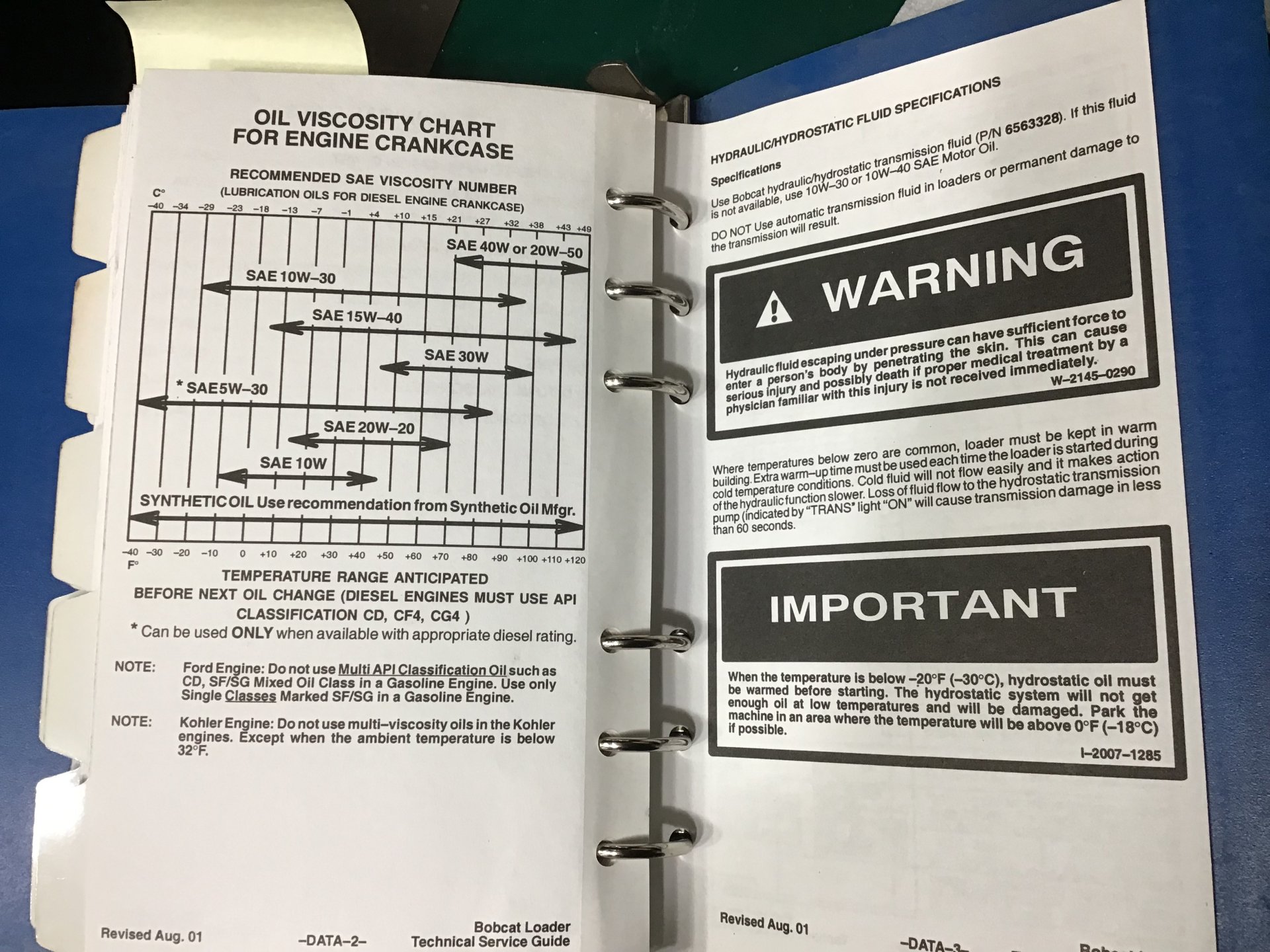

I have included two pages of the bobcat “Loader Technical Service Guide” that should come in handy. Just use the one that pertains to your specific serial number.
Just a note, I have found typos in this manual. So if something doesn’t look correct try to verify it.
