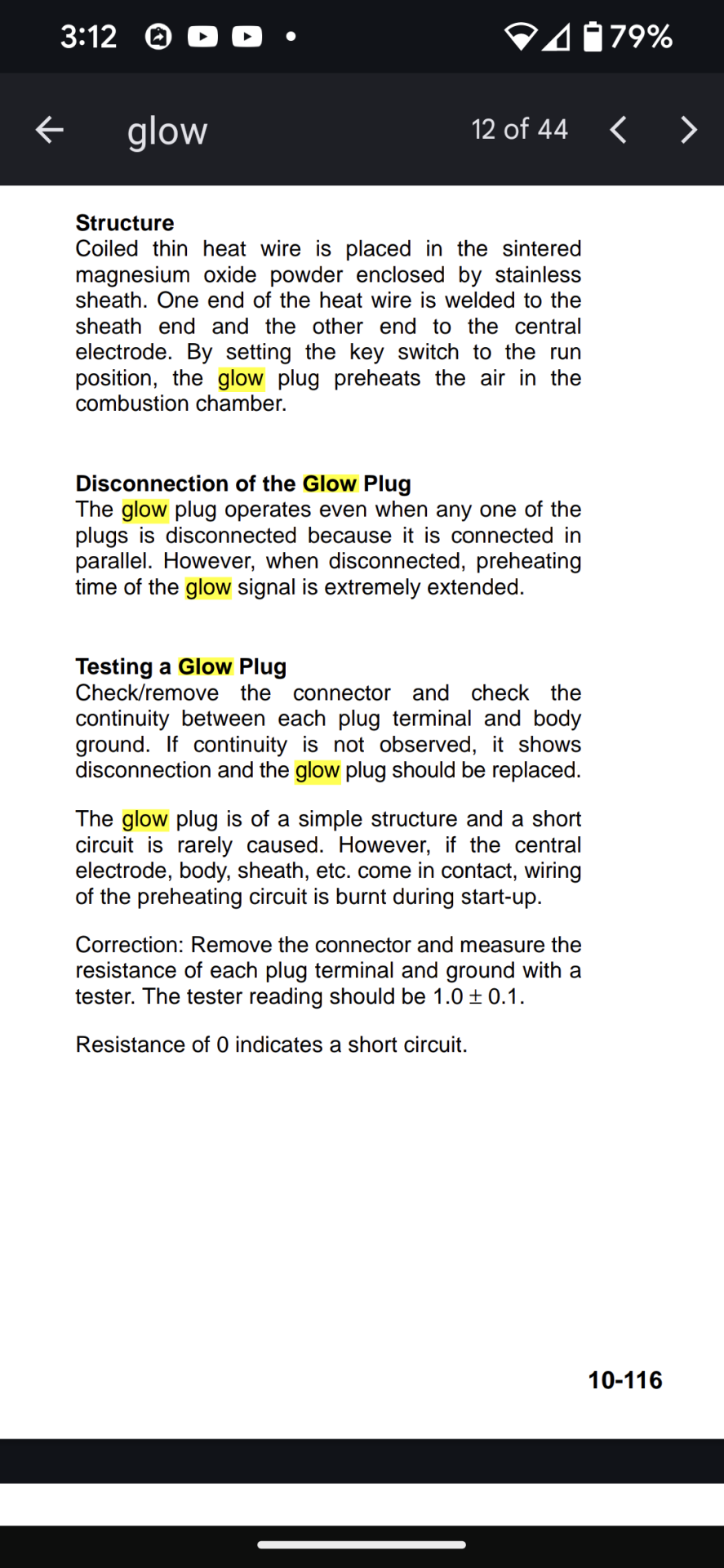

The service manual for the New Holland LS160 and LS170 says the glow plugs should test at 1.0 ohm ±/-0.1ohm.
"Testing a Glow Plug
Check/remove the connector and check the
continuity between each plug terminal and body
ground. If continuity is not observed, it shows
disconnection and the glow plug should be replaced.
The glow plug is of a simple structure and a short
circuit is rarely caused. However, if the central
electrode, body, sheath, etc. come in contact, wiring
of the preheating circuit is burnt during start-up.
Correction: Remove the connector and measure the
resistance of each plug terminal and ground with a
tester. The tester reading should be 1.0 ± 0.1.
Resistance of 0 indicates a short" circuit."
