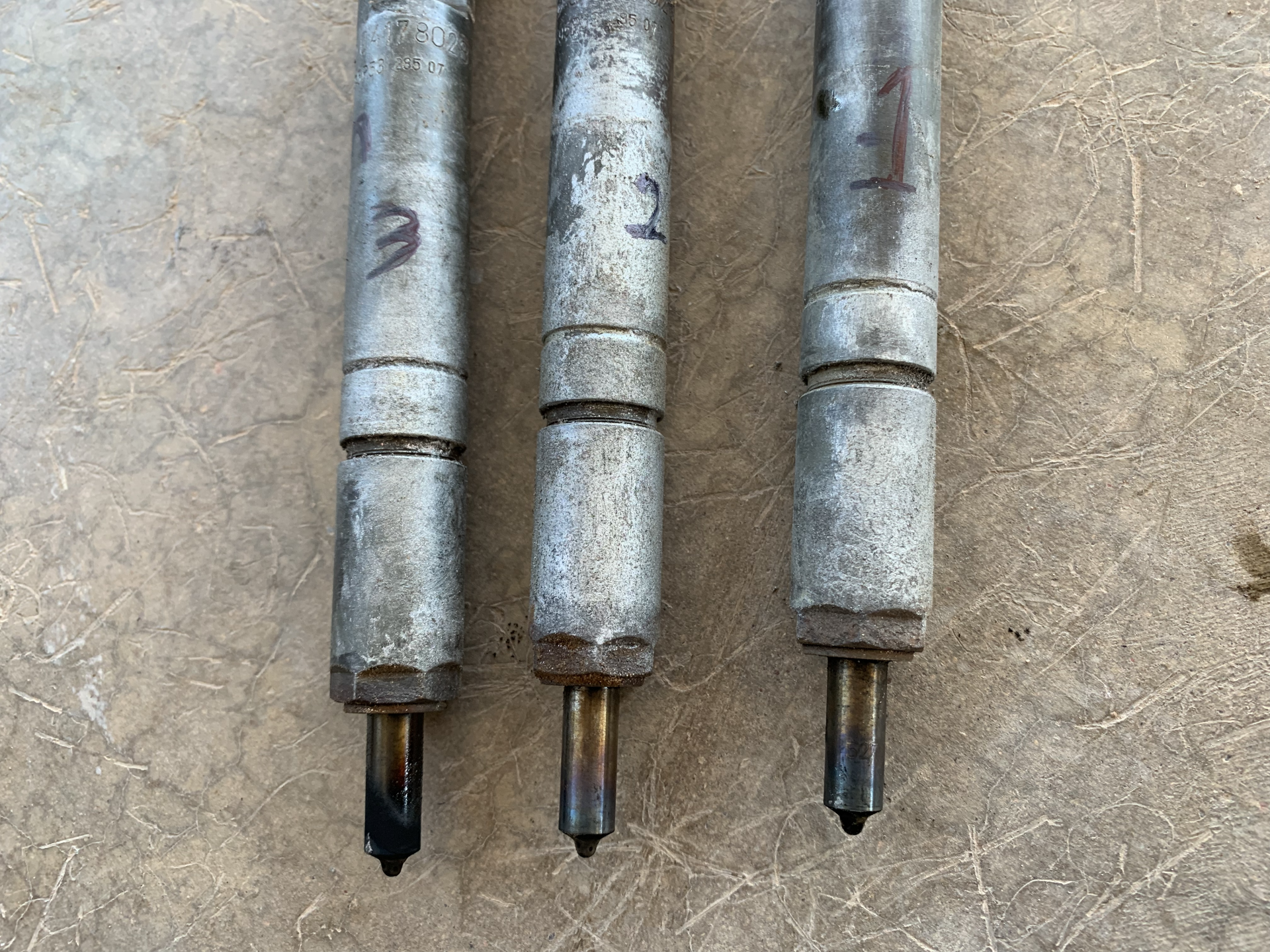

I pulled and cleaned injectors, again. Did a repeat. Results, exactly the same. So I pulled injectors. Same appearance. #3 was not as bad as first time pulled.(see photo-comparing all 3.....anti-seize is the silver) Reminding this engine has never had any work done to it, just fluid changes, and I hardly ever run it at full throttle. Usually idle or just high idle even when pushing dirt.
Now I'm thinking maybe I damaged #3 somehow when cleaning, so I ordered new ones. In meantime while waiting for new ones, I made a tool to turn engine over to find TDC on #1 and check valves as per manual. Very close, maybe 0.05 variation on #1 & #3. So I adjusted. New injectors came and installed. Started engine and it sounded really good at idle, mid and high RPM. After about 10 minutes I drove around, swapped to forks, then it started missing again. I unloaded the delivery truck and just made it back to the shop as the engine was faltering so bad as originally. NO!!! So I pulled the injectors (getting faster at this) and #1 some carbon, #2 clean, #3 bad.

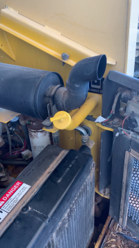

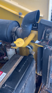

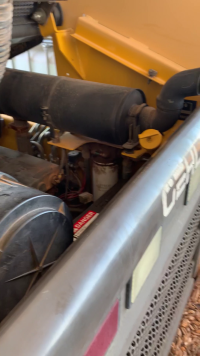

So I went through the valves as shown in the Deutz manual. My valves were a bit off. Made the adjustment and fired it up. Sounded good, then at about 5 minutes the same faltering started. I carefully watched the exhaust and recorded it. There was no smoke at all. No white smoke and no black smoke. I will try to post that video.
The next thing I did was took "Foton's" advise to mount a separate fuel tank and fuel line. So I used an old plastic ice cream container (square not round) and attached a nipple and fuel line. By-passed the lift pump and filter and went straight to the first injector pump, and hose clamped both ends of fuel line. The tank I set atop the cab and poured a quart of #1 kerosene fuel oil, knowing that is clean as I am starting to question the quality of the local diesel supplier. Oh, I let the air in the fuel line slowly bubble up through the qt of kerosene. Took about 10 minutes. Rattled the line and few more bubbles came up. Then cranked on the starter. Took a couple times, and the engine fired and faltered a bit, some black smoke, and slowly smoothed out. Checked the time. Five minutes and running well. Check fuel reservoir and good. Ten minutes--good. Fifteen minutes cycled throttle all the way idle to full throttle. All good. Continue moving throttle for additional five minutes. No smoke, no faltering, and no missing.
So, my next step is to drain the fuel tank again (this will be the third time) and drive to our local farmers diesel and get some of that dyed diesel. I figure if the farmers get there fuel there, it has to be good. I will also change my fuel filter again (this will be the fourth fuel filter- Baldwin)
