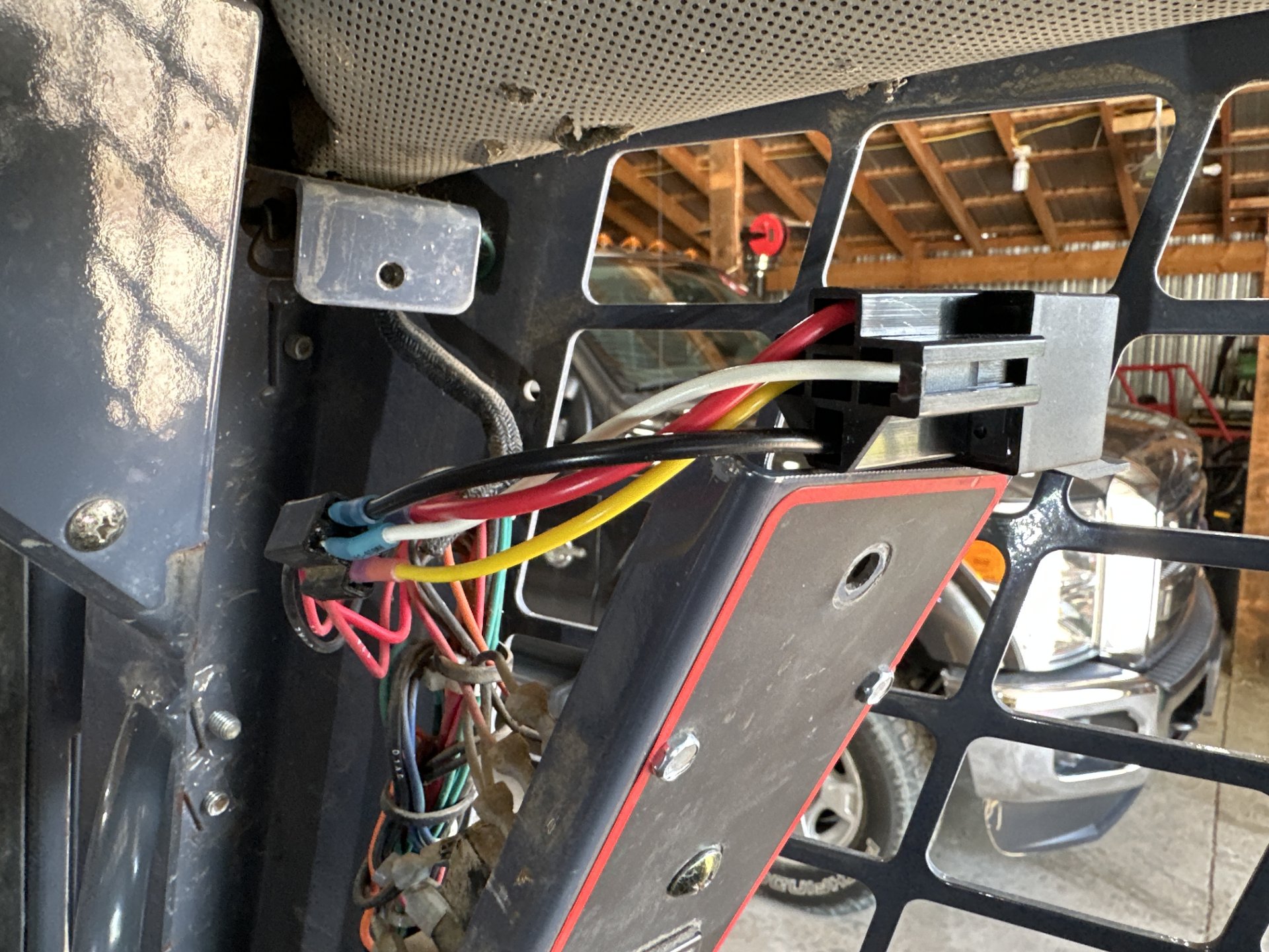

A month ago, the brake circuit worked intermittently and finally stopped working. No power to the cab panel switch. Removed the instrument panel and found a pulled out spade connector on the delay timer. I cleaned dielectric greased tightened and reinstalled the connector.

The switch is fully powered in the lock position (red), when you switch it to the release position (green) the machine works fine for about 5 mins or so, and will lock up the brake on and off every 20 seconds or so causing all kinds of jerks etc . Leave the machine run in with the sticks in neutral, and the switch in the release position, you can see the green light drop out every 20s or so. Bump it to the lock side, and the switch is solid red, no blinking.

I replaced the timer with a simple 12v relay vs jumpering it. White to black wire (ground), yellow to signal wire (red 12A wire), red to unlabeled red (12v supply) , black relay out to red 13 wire ( 12v to brake switch) .
Gonna clean the wires up but looks like a simple, cheap replacement to the timer.
I decided this route as it looks from the wire schematics that jumpering would allow the brake circuit to by pass the seat and arm bar, which isn’t safe for younger operators or my older father whom isn’t so familiar with skid loaders.
Not sure on wire colors but usually the red & the black that are beside each other are 12v & the ground, they can remain disconnected & the 2 that lay flat need bugged together to make the brakes release, that would do the same thing as the relay, effectively bypassing the timer
