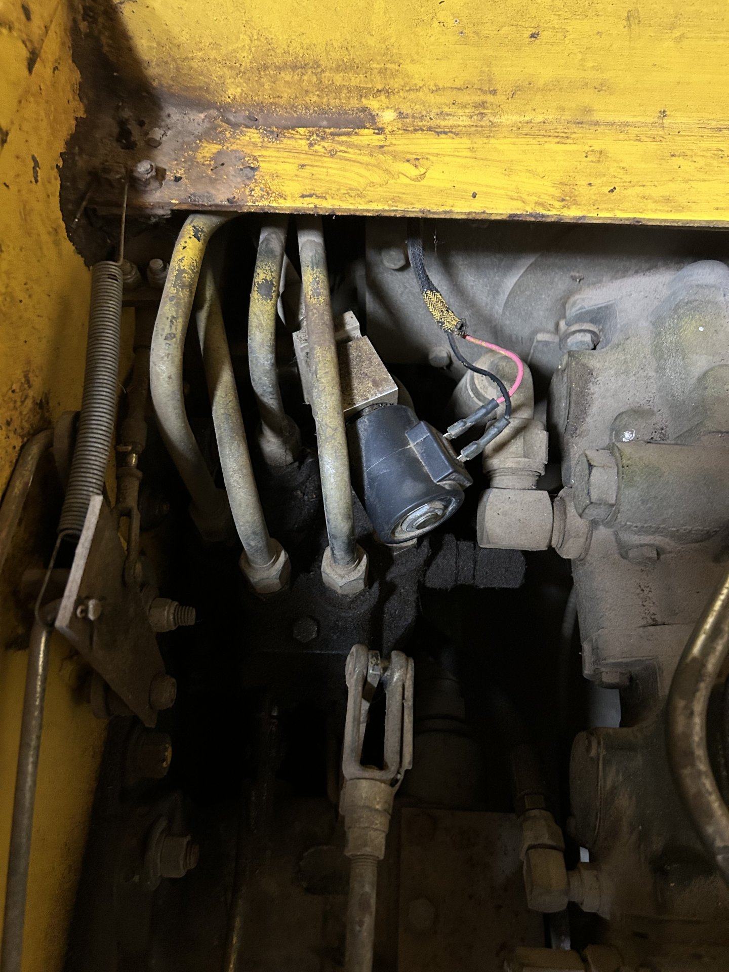

I'm having some issues with my Gehl 3825sx. The bucket and boom control is no longer functioning and when applied kills the engine. There are no issues with it moving, that seems to work fine. Just wondering if anyone could point me in the right direction. Could this be problems with the solenoid, relay, wiring, or hydraulic filter? Thanks.

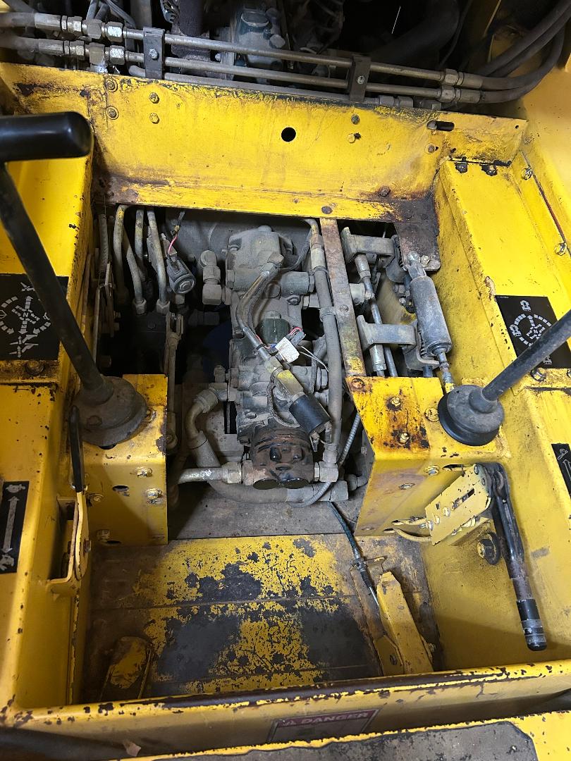

Update: Checked the safety switches, fuses and examined as much of the wiring as i could. Everything looked good. Identified the two solenoids for the lift and tilt. Measured the resistance at 7.5-8 ohms. I ended up turning the tilt solenoid to the right maybe 40 degrees which seemed to tighten it up. Didn't tighten the nut. Started it up and tilt worked but lift didn't. Lift solenoid was in engine compartment. Did the same turn with it and started it up and lift worked. This was with it in the garage, cage up and no attachment. Hopefully this week I'll get it outside and exercise it some. Here's a picture after I turned the solenoid that you can compare with the picture above. Any thoughts on this?
