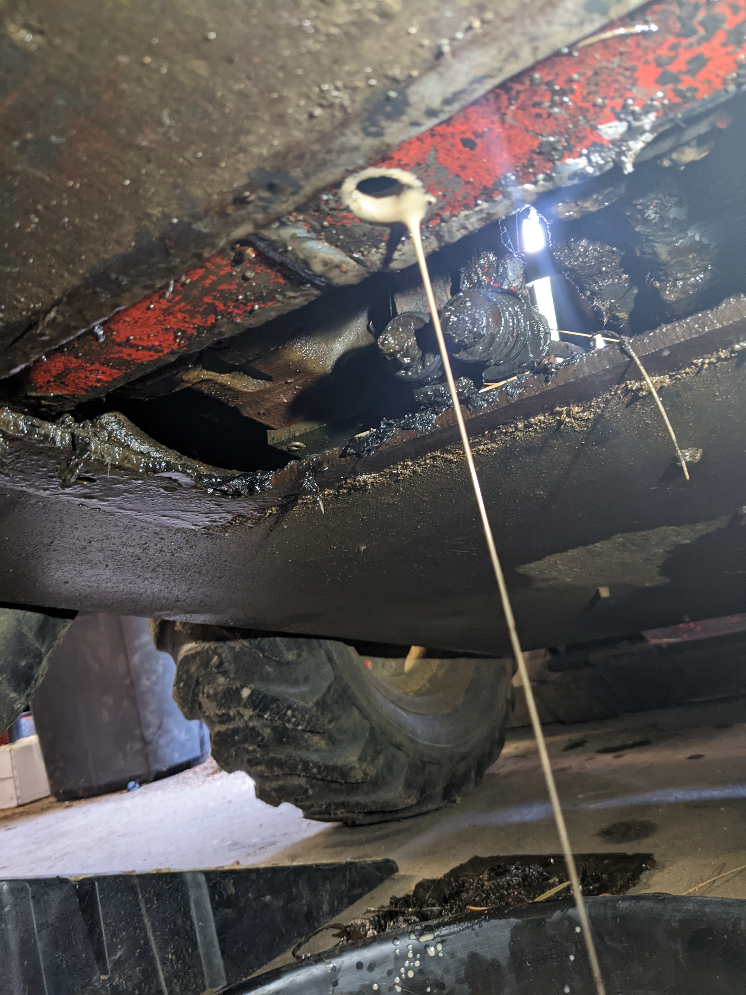

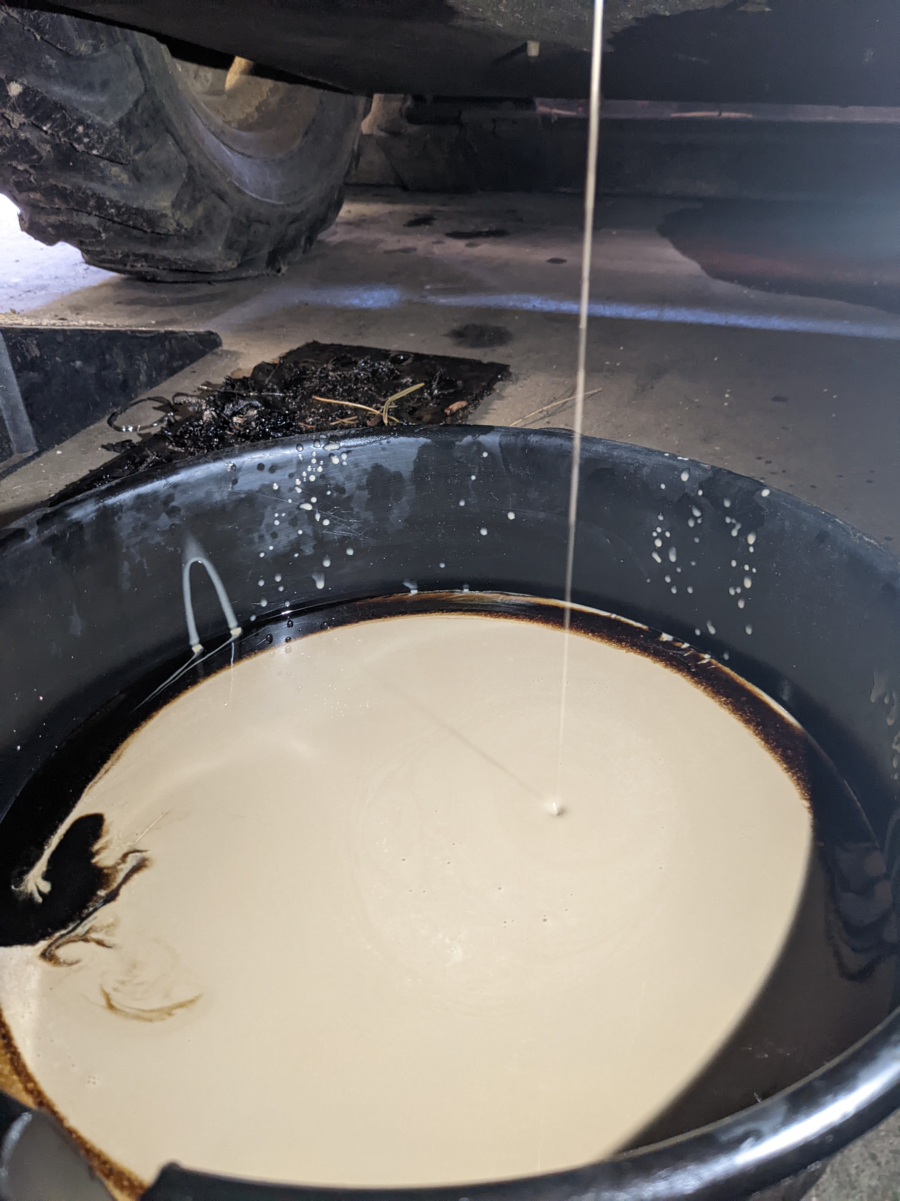

I just purchased a Gehl 3000 1976-79 I believe. Got it cheap, it runs and operates. Every cylinder leaks to some degree. Anyway I'm changing all the fluids and I drained the Pump Drive that connects to the engine and the oil came out white milky. The fluid was low on the dipstick before I drained it. There are leaks everywhere but I'm not overly concerned since I will check fluids regularly and fix leaks as I can. But is this a huge red flag for my pump drive unit? The manual says to flush the pump for 10 minutes with #2 fuel oil and then drain and fill with #10 non detergent hydraulic oil. I'm going to try this and cross my fingers...

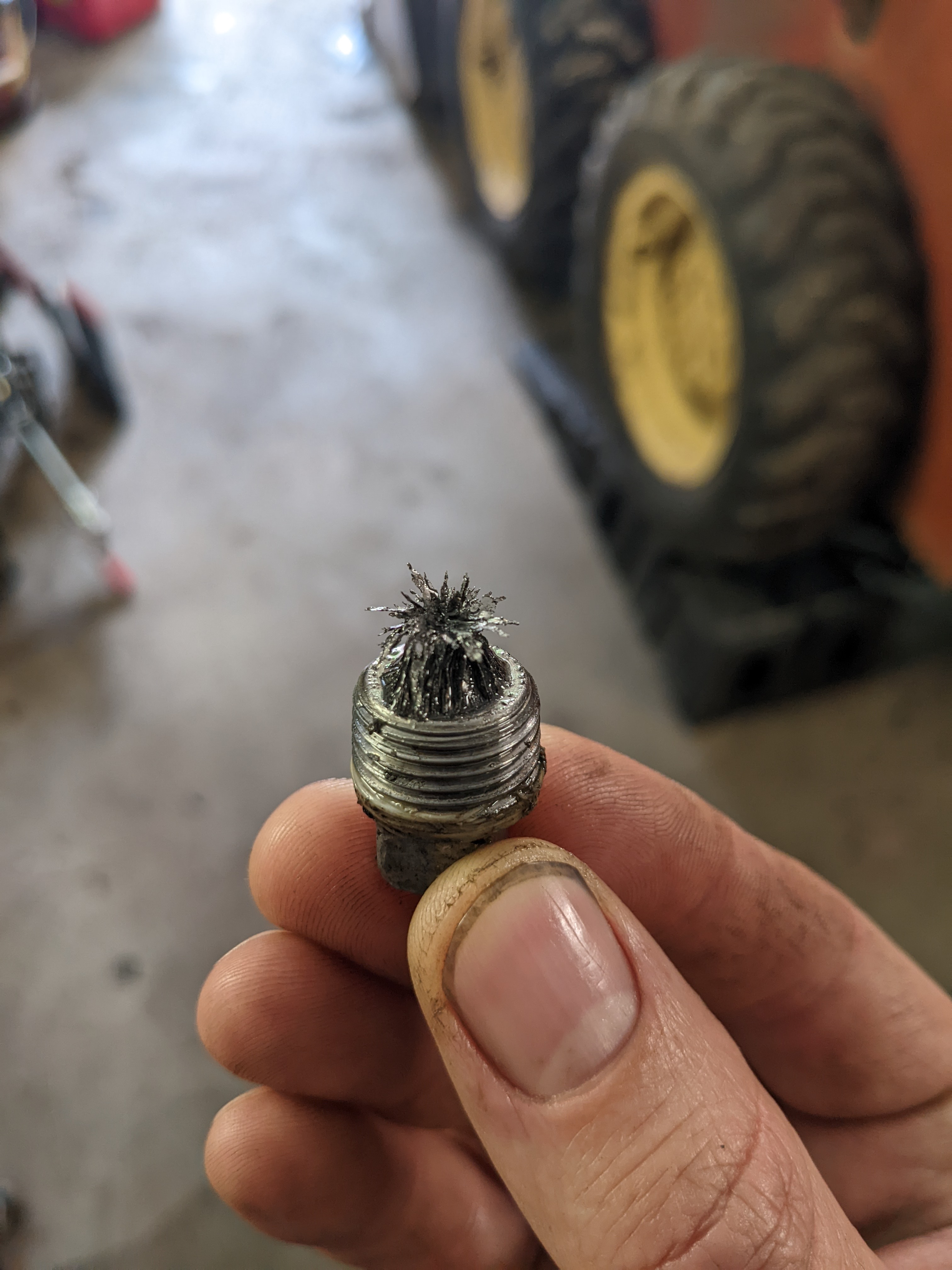

After flushing with diesel fuel for ten minutes I pulled the plug and there was a good amount of metal shavings

you never know that might have been orginal oil and water from what ever reason causing it to not lubercate as well as it should, I think unless there is noise or slop in bearings I would roll the dice and leave it alone just with a better maintence schedule. give it a season of running and pull the magnetic drain plug and if it cleans up if it does call it good.
I would also say, do your oil change, run a LITTLE and re drain and do another oil change, as even after flashing you never get everything out,
so, doing a second oil change/filter, in a few hours, will only add peace of mind to things IMO!
as that was some very milky oil
and as such, things will cling to corners and crevices, that will then come loose after some heat cycles on running things
so that second sooner oil change will only ensure anything that was stuck up some place, gets removed and any rust that built from that water in the oil will work itself out/loose and be removed!
Oil is still cheaper than rebuilds !,
just my 2 cents!
