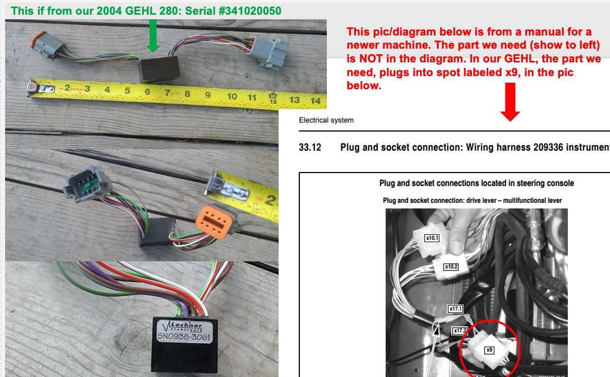

Upon tracing the forward/reverse toggle switch harness from the joystick, we found this odd harness that has a black box that was added between the main harness and the joystick harness. Tried looking up the numbers but no help, also been on the phone with dealers who dont seem to have a clue what this inline harness is. the Reason i mention this is When that harness was removed and bypassed, the transmission momentarily engaged and lurched. But would not remain in gear.
If you have any suggestions or a good direction to go in please share!! Also any information on this mystery harness with black box PLEASE HELP!! thanks again and again, im dead in the water over here! Model 280 (2004)
